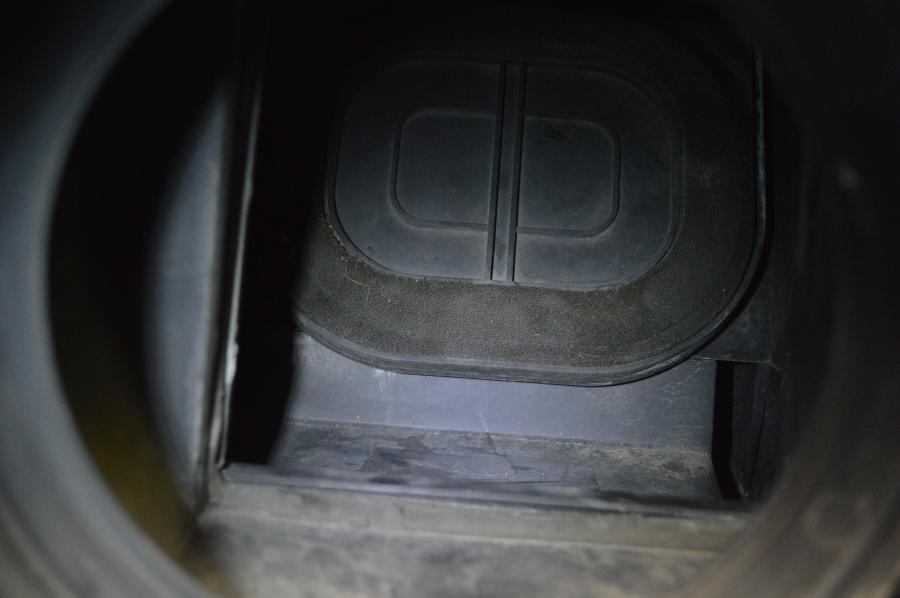

No they are different "doors".
Vent position and fresh/recirculate are vacuum operated
Blend door is electric and operated by Temp setting

The fresh/recirculate door feeds air to blower so if it was obstructed then yes blower couldn't pull in enough air to get good flow

Okay, some updates. I assume the recirc door is the one that's right in front of your face when you remove the glove box, off to the right a bit. It's directly behind the blower motor - is that the recirc door, or something else? Kind of looks like some pictures from online. Well, mine is firmly attached where it's supposed to be. First picture below, from the engine compartment looking straight back. There's some kind of vacuum driven linear actuator that goes to it that I didn't snag a picture of, white vacuum line going to it, that mechanical link is in tact as well. I can move the door open and closed by hand and everything seems to move fine. Just tried to fire up the truck (with the blower removed) and I can't get that vacuum-driver linear actuator to move at all, using any combination of knobs on the heat / A/C. I will do a test drive in a few minutes and if it changes will update.
