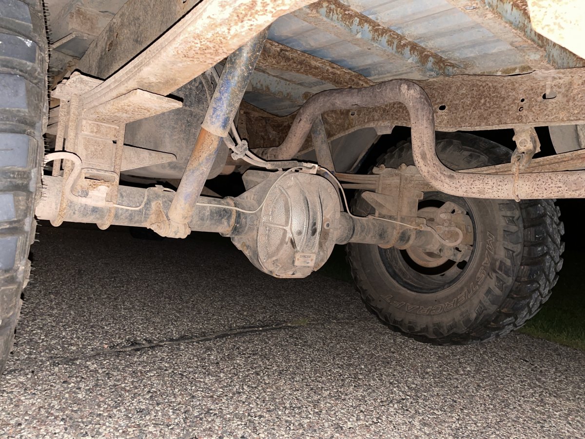

gonna do the old two passenger side soft lines and reuse the stock rear Ranger center soft line trick? Knowing you you probably have a lot fancier plan, but I liked the simple route... Especially since I just grabbed a second line and bolted it to the caliper while I was at the junkyard...
I've abused the snot out of the 8.8 in my Ranger, while you are reworking things I definitely suggest welding the axle tube seams to the pumpkin... but if memory serves you're using a traction bar so you'll already be welding in that area :)
I was actually planning on using the factory Explorer lines, but I guess looking at it now that might not work. I replaced all the lines on my ranger when I did the lift, but I don't remember what lines I used on the back. I guess we'll find out when I get it in there! Good thinking on welding the tubes. I'll do that for sure
I used two passenger side hoses on mine...plus a Skyjacker extended brake hose/splitter in the middle and redid the hard lines. The passenger side hoses have little tabs that you can use to bolt onto something... I had to really dig to find this but here's my swap thread from 12 years ago: https://www.therangerstation.com/fo...p-this-one-with-discs-and-lots-of-pics.46418/
Ah I see. Thanks for the link! I have everything to do new hard lines. The way Ford did the drivers side on the Explorer is dumb
Yeah, you get all the room for all the suspension travel you want as long as it's only 4" of travel that you want... Using two passenger lines is pretty clean and simple... I just flared the stock hard line in the center of the axle for the two new nuts, worked fine. On mine we just pulled the stock bump stop and put a shock spacer on the bottom of the frame to drop the hard line down further, not the cleanest way to do it but it's worked just fine...
I mentioned welding the tubes because I've spun one, but it took some extreme measures and lots of axle wrap...
Yeah looking at it now and I think the two passenger lines is the way to go.

I ended up using the factory 8.8 lines, and just adding an extension piece, part # BH36593

I used two passenger side soft lines on mine and welded mounting tabs to the back side of the Barnes 4x4 spring perches. Worked pretty well. Ni-cop lines if rust is an issue.

That extension deal is pretty simple, I like it, I might do that for future swaps...
I like that extension hose, I'll have to keep that in mind for next time. Sure would be easier that way than redoing everything.

I do need to weld on some tabs to mount the soft lines, I'll do that today. Your install looks good @DRanger024
