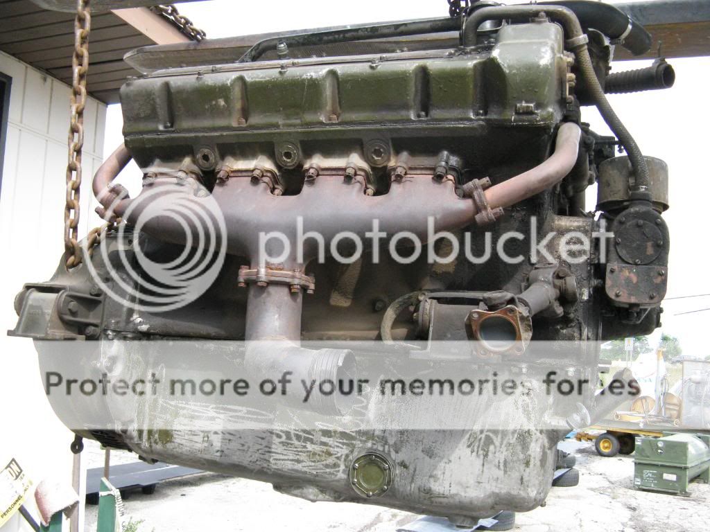

Biggest Ford I've ever worked on...

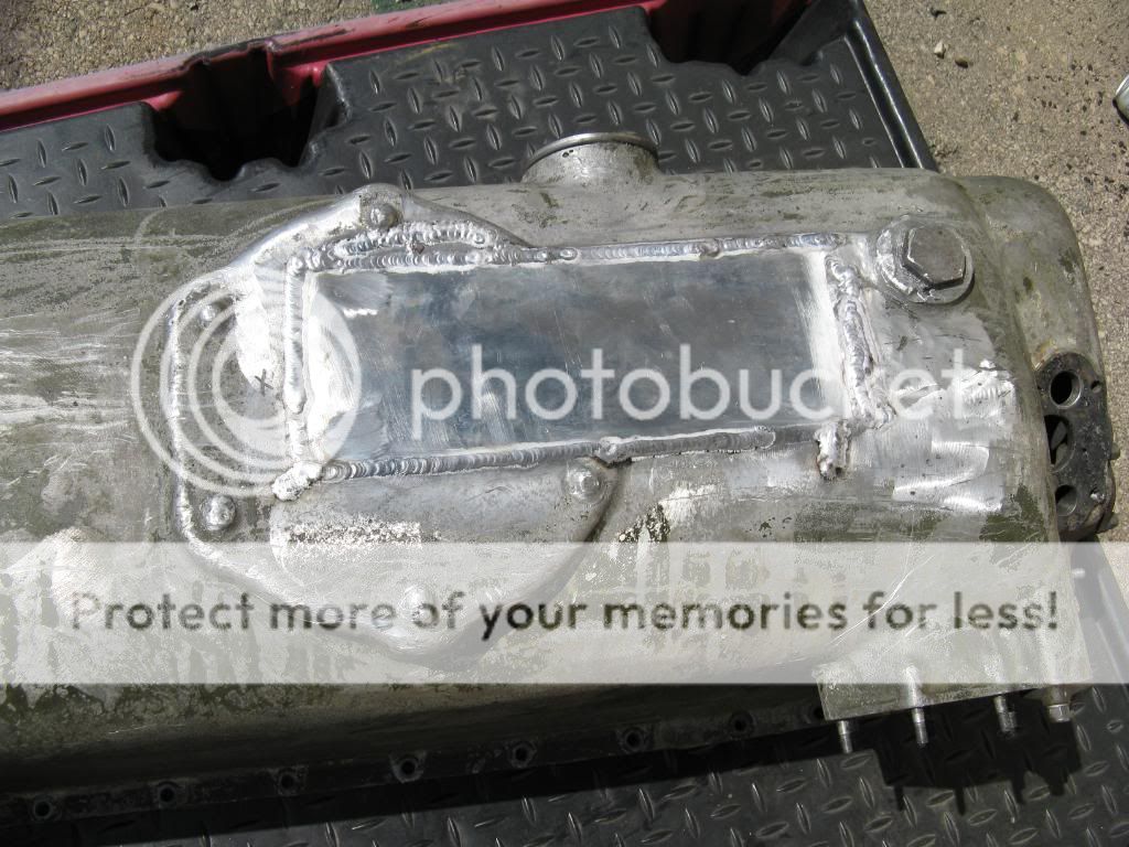

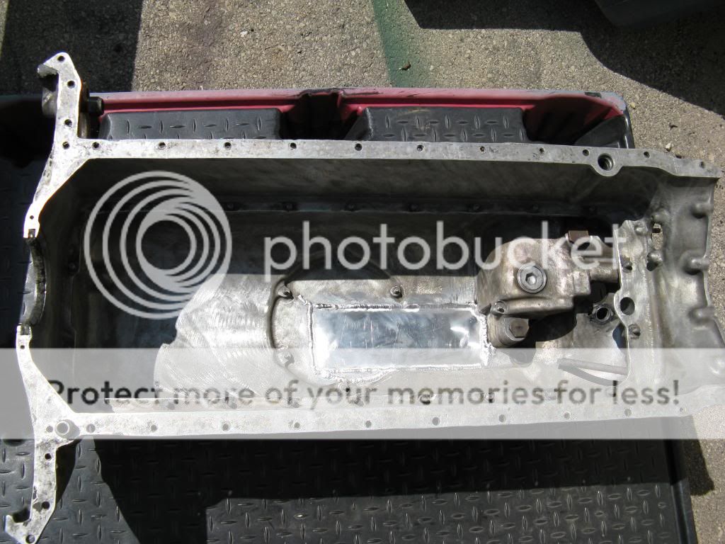

We have several other good oil pans on the other engines we have, but they all run and belong in their own tanks. So we decided to fix this one instead of being short an oil pan, and thus an engine.

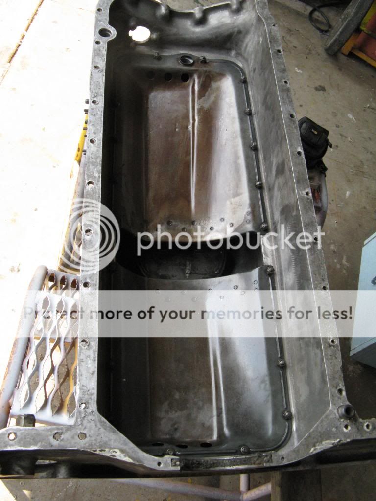

Oil pan is fixed.

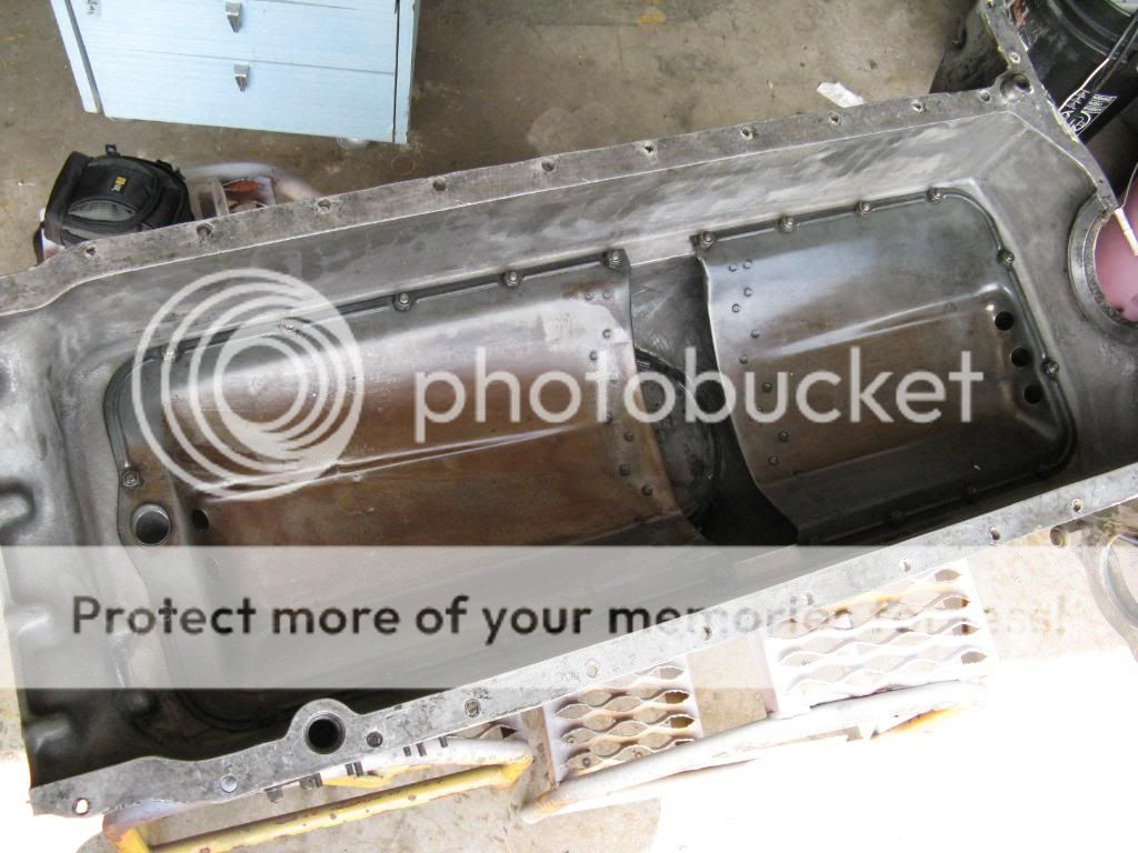

Baffels and sump put back in.
I also made new gaskets for the oil filter (no, it's not a fram...or anything like a automotive filter) and oil pump. Sunday, I'm putting the oil pan back on, installing the filter, pump, and starter. Giving it a really good cleaning, and painting it. Then everything starts going back in at some point thereafter.

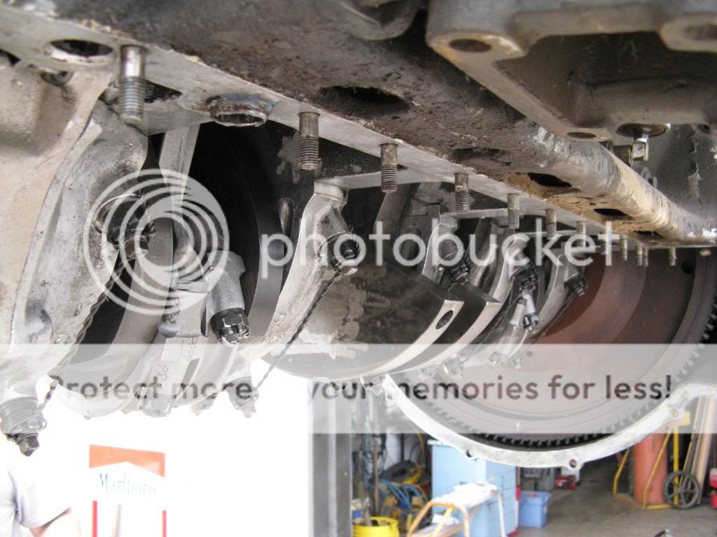

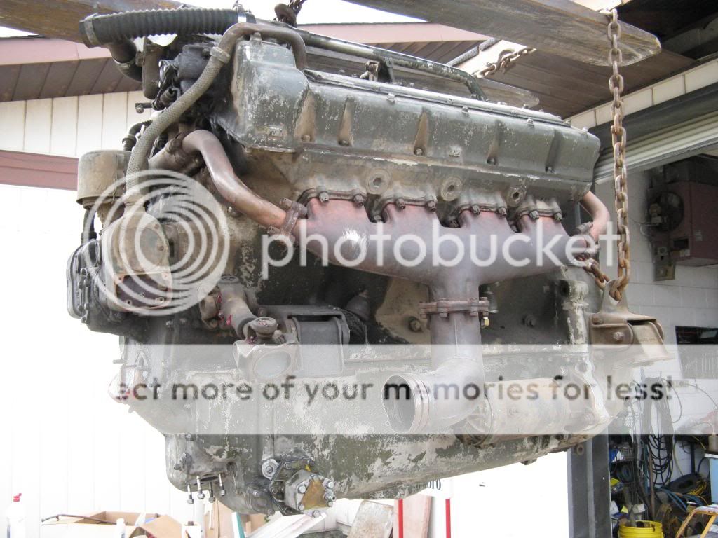

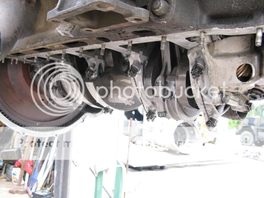

Coming back together.
The internals.

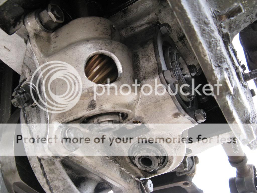

What spins the shafts on the sides of the engine to drive the cooling fan gear boxes.
