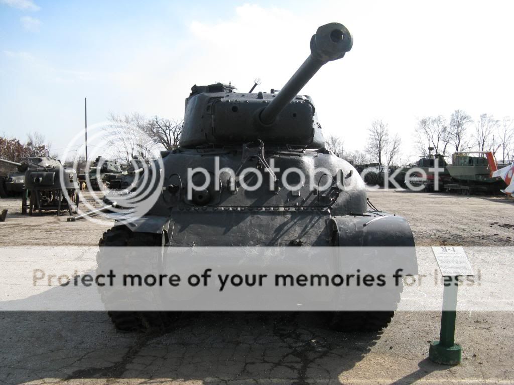

What is the tank destroyer in the back left of the picture on page 5 please?
I assume you're talking about this picture.
Biggest Ford I've ever worked on...
Those aren't tank destroyers, though they'd do a pretty good job of doing that against any tank from ww2. Those are vietnam era and newer M47 pattons Main Battle Tanks and an M60 MBT.

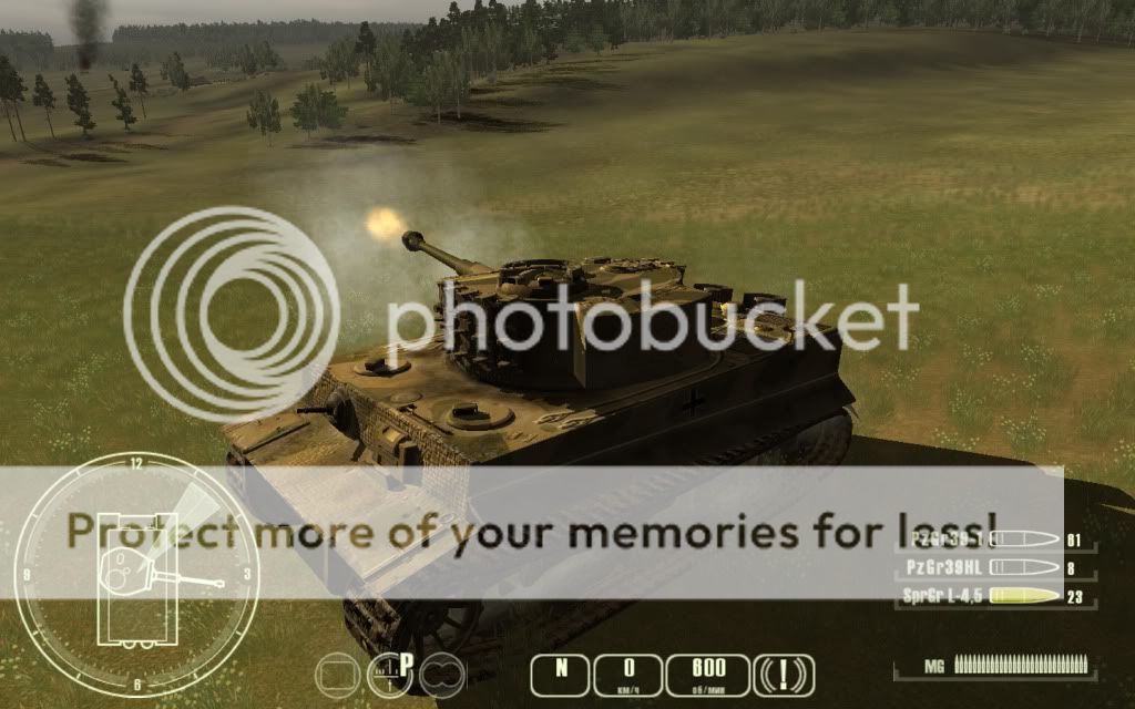

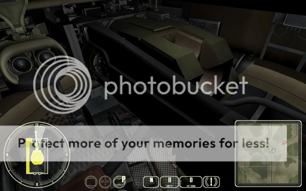

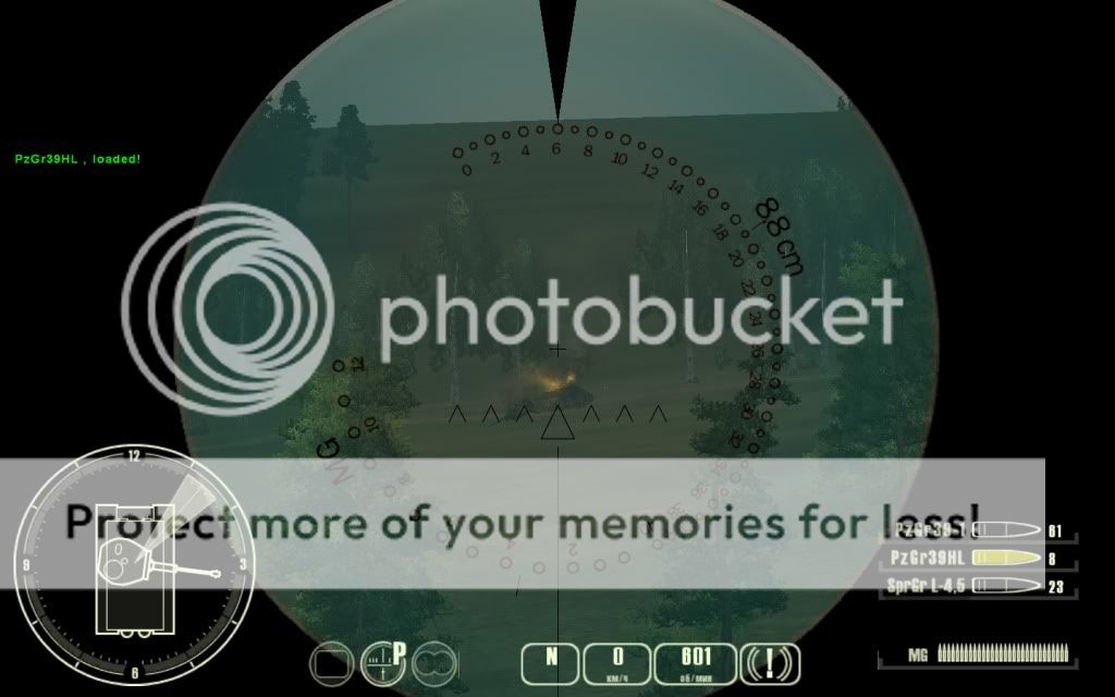

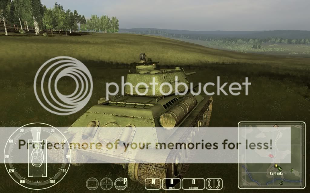

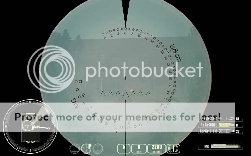

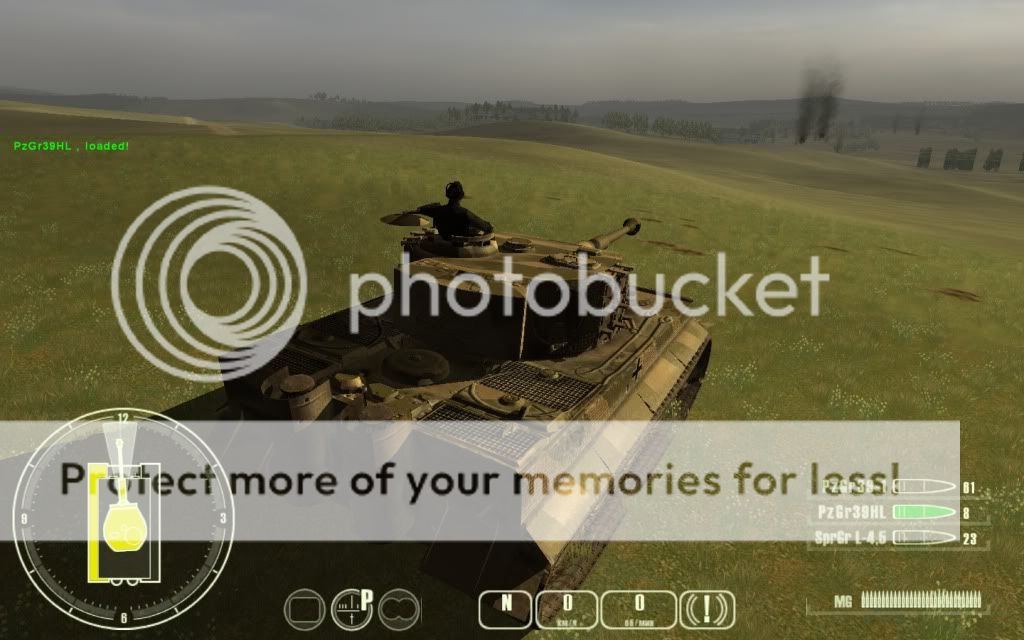

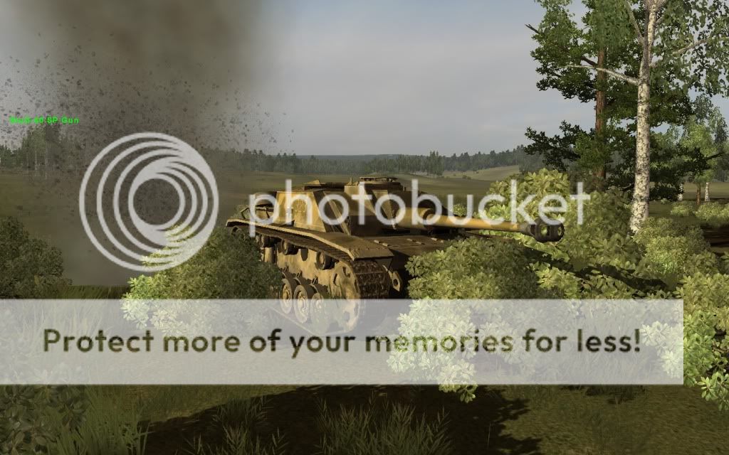

The best tank simulator, and probably best tank game all around would probably be Tiger vs T34. Here are some screen shots I took of some action. I had a thread on this game a few months ago.

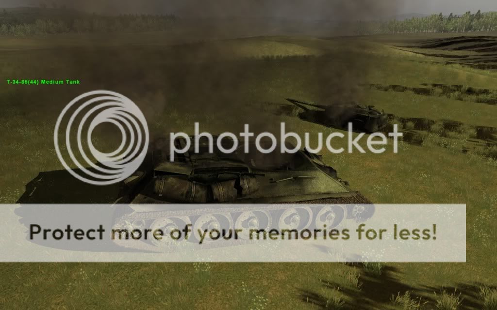

You can also be a russian in a t34 and hunt germans, but I'll just post one pic of that.

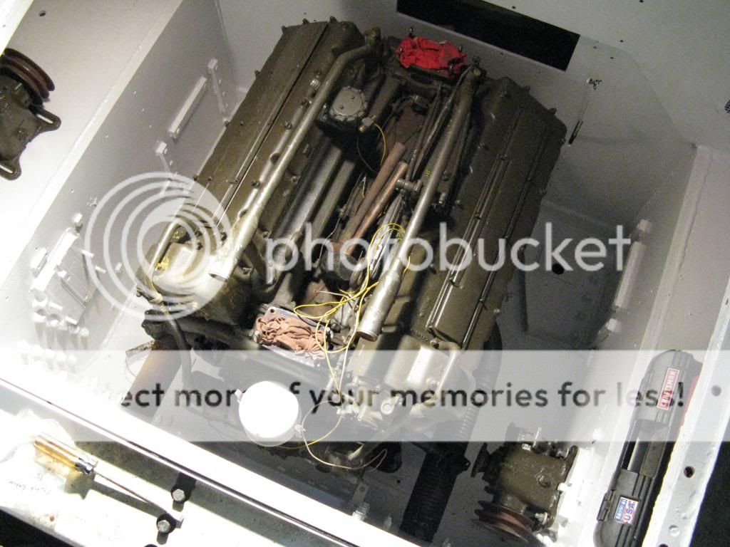

Put the oil pump in, filled it with oil (8 gallons), and was within minutes of starting the engine to check for leaks and to retorque everything, only to find a leak before starting. The person we sent the oil pan to never checked the pan for leaks after he patched the hole. So, I'm pretty pissed. If we had a tig setup, or even if I had one myself (will be getting one soon) I could have done the welding myself and would have had it done a month earlier and it would have been done right. Should be sending it out to be welded and hopefully back by Sunday, i'm not holding my breath though.

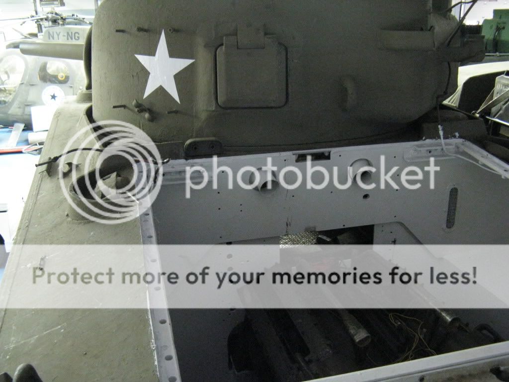

On a more positive note, there's other things to work on. Things need to be put back in the tank before the engine goes in, so that's what's up for sunday if the engine isn't back.
Well, the engine roared to life today. A combination of camera issues, and trying to check for leaks/problems, prevented me from getting a video. Tomorow it goes in the tank, but it'll be a while before it's driving...lots of stuff to hook up. Will have pics tomorow.

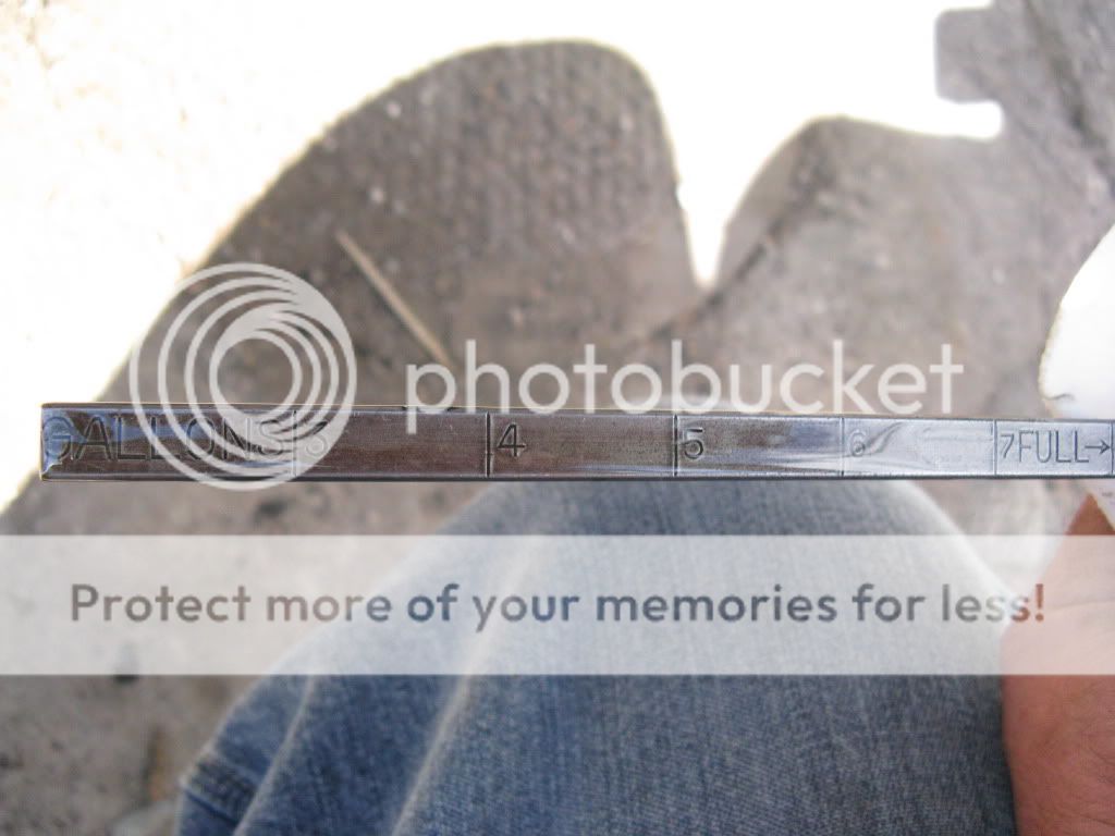

Never seen a dipstick marked out by the gallon before... although a lot of things that come in the door are close in quanity (for just the engine, tranny's are quite a bit more)

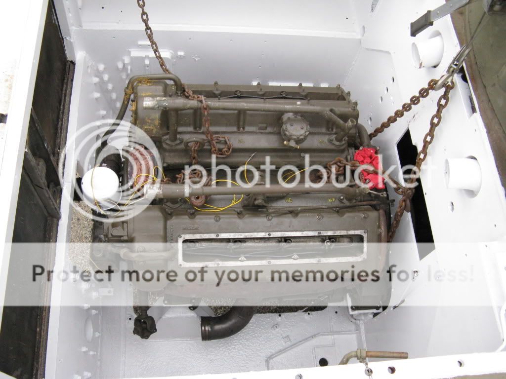

It's in and bolted to the mounts now... Took two times to get it right. Had to reset the chains at longer lengths to clear the turret with the forks. But it's in, now on to the easier stuff...putting the small things back in.
