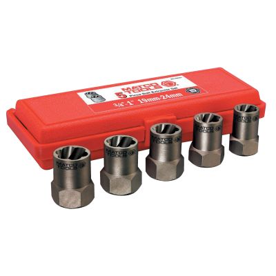

Have you tried these? (they only work if the bolt is sticking out of the head)
have a set, bolt isnt sticking out anymore...
