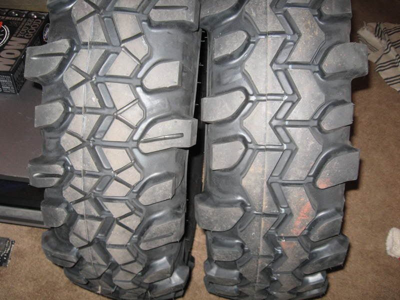

Having wheeled both BFG A/Ts and various mud tires... I can and have gone places in the snow on 215/75 AT's in my stock '88 that my '86 that is lifted and on 33" mud tires can only dream of going.
Why? A/Ts are an advantage in snow and I would take them over mud tires in that specific situation. Reason being, mud tires dig down so when you get stuck you're really stuck. A/Ts will not dig as far plus the fact that they have more lugs with smaller voids means you have more surface area to grip whatever the tire is touching. This is why you see people cutting and siping tires, like this:
