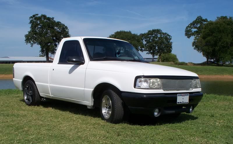

Hazmat, nice truck!!! where did you gat the grill?
Thanks
