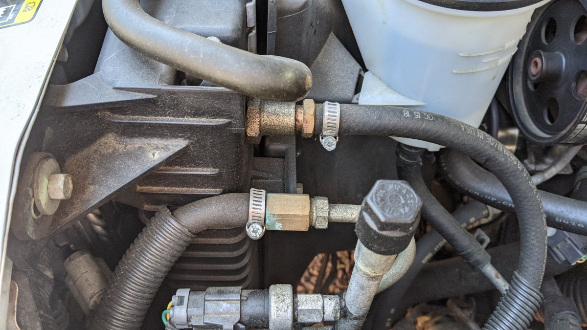

And here is how it's plumbed. The oem steel line just got moved to the side. I should bend it over a bit more as I just now realized looking at the picture that the one hose is rubbing the radiator lol. It moves quite easily so I think I'll find a way to hold it over farther with some kind of bracket or a zip tie for now.

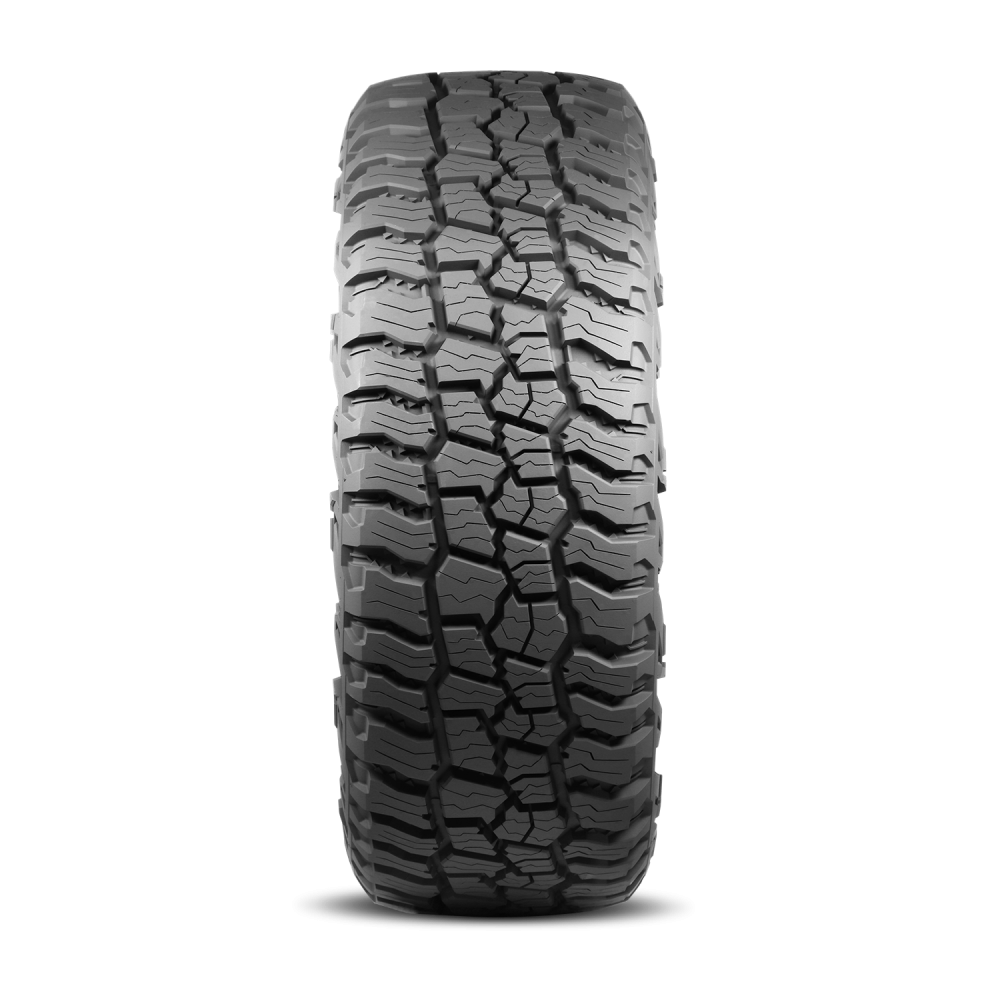

forsure I will look into the u joints, and I did not know that about all terrain tires. I will mostly be driving it on the street but plan to do a small amount of off-roading. My next set of tires I will look into getting some mud tires. For now I will just avoid mud lol, luckily it’s very dry in Colorado from June-September.
Most tires are like that really except for mud tires. A word of caution before you buy. Mud tires can be very loud and they wear faster because of the rubber they are made out of.
If you are going to be the occasional “weekend warrior”, All-Terrains are probably going to be a better match for your needs. They are more quiet, wear better, often times handle better, and can be less of a hit to fuel economy.

How would I go about installing a second transmission cooler on my Ranger?
The cooler is a loop. You disconnect one line from the existng cooler. Connect the line to the 2nd cooler. Then use some line or hose to run to first cooler
Actually the easier way is to find a mounting location for the cooler you get, and mount it......and then cut one of the metal transmission cooler lines going to radiator and use rubber hose to and from cooler to the cut metal line, cooler has no "direction" of flow thru it
There is no pressure in either line, but there is FLOW so double hose clamp each connection
My 2019 is the first automatic I’ve owned in a very long time. So, I may be incorrect.
I’ve read the best way to hook up an auxiliary cooler is to hook the output to the auxiliary first then have the plumbing run into the factory cooler.
The stated reasoning behind this is because some vehicles sense transmission temperature and will run the engine differently until the transmission warms up. With two coolers, the transmission oil could get too cool if run through the auxiliary cooler last. If run through the factory last, the engine coolant would warm the oil back up and prevent that from happening.
If that reasoning is incorrect, I’m sure that RonD, 19Walt93, or one of the others more in the know will correct it. I know it was a big issue with Hondas and could cause some long term problems if the oil was not reheated after getting too cool.
I ran MT's on my truck for years, I think I got my first set around 07.
I just went to AT's last year hoping to get a little better mpg since I am driving it all over the country now.
Performance on trail rides is the same, I was the only guy with MT's in our little group in Southington and nobody had a issue. MPG/road manners didn't change. Might be a little quieter but with the windows down it is a wash anyway. Snow performance vastly improved, like no comparison.
I have no inclination to go back to MT's.
