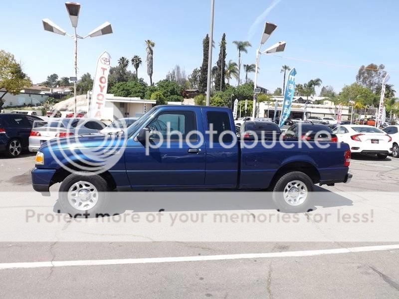

Took the Ranger into my local trusted shop for an alignment and tire rotate and balance. While on the way home from buying it (a week or so ago) I noticed it pulled right slightly and there was a bounce at certain speeds. Alignment was off a bit and all the tires needed to be balanced. The LR wheel was bent on the inside only...we'll use the spare for now...no jack or rod. Called the dealer where I got it, they will get me another wheel and the jack and accessories. I was surprised that they would take care of it......happy me!
