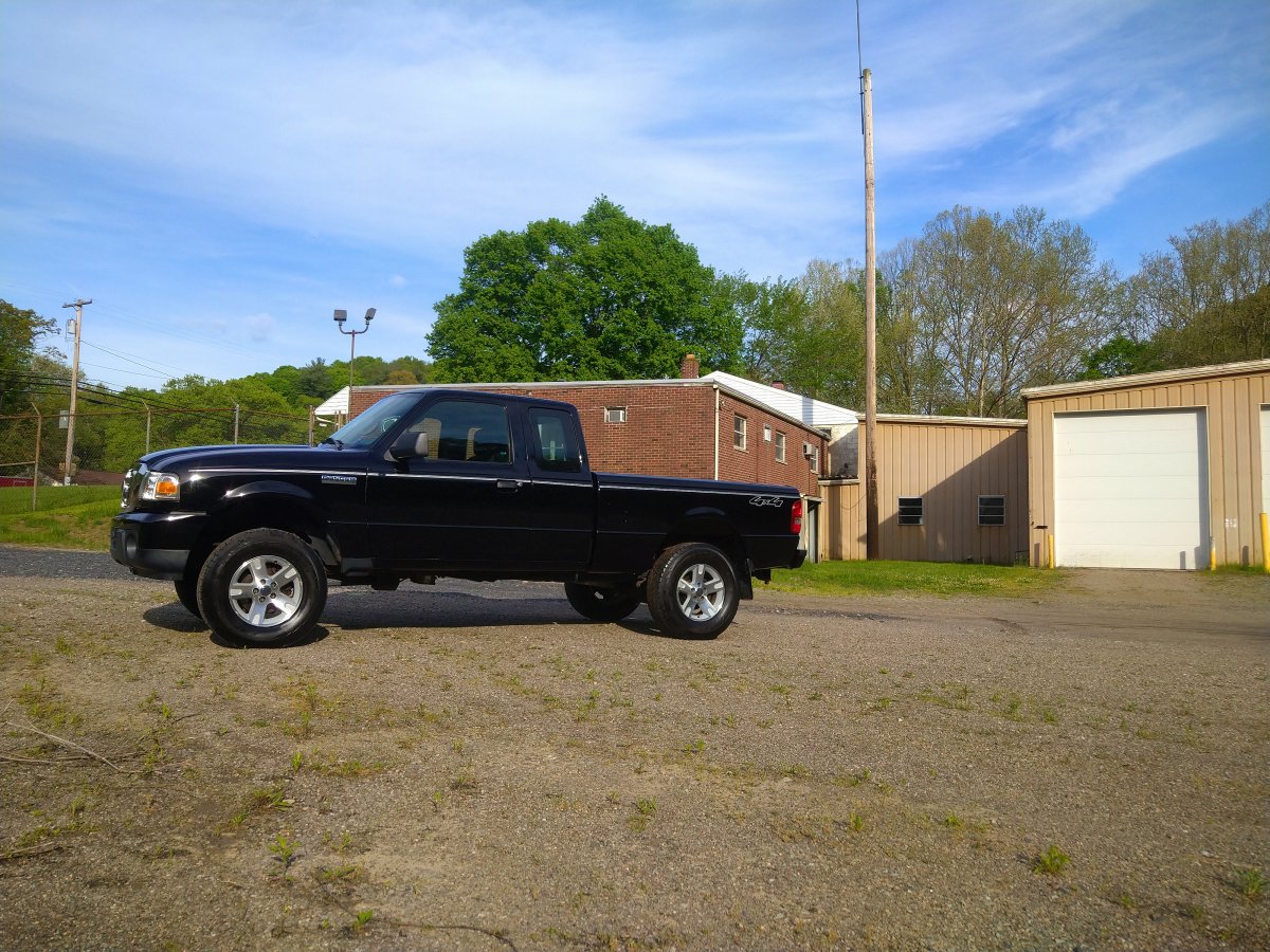

2011, factory halfer blocks, 1" lift shackle, 1750lb springs, #1 V8 expo bars, and rough country leveling keys.
It's no performance car, but it holds the road very nicely. Agile for its height as well.
that electronic anti rust gizmo must have worked. the bed seam and support rails look factory fresh.

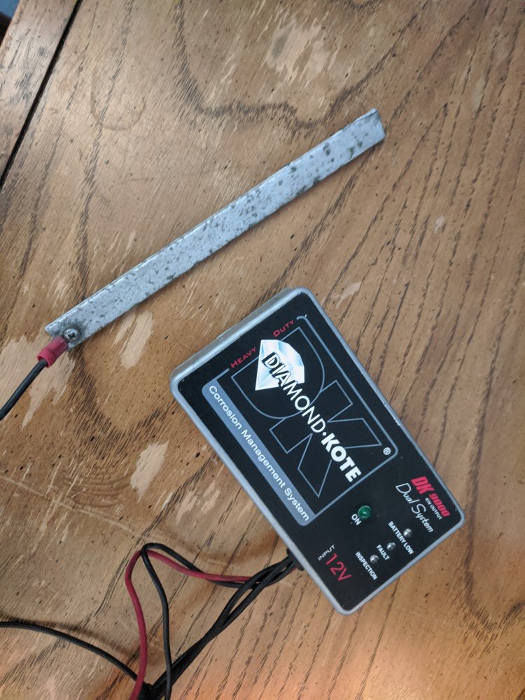

Here's that device for you
Its adhered to the truck in various locations with double sided foam tape.... All it's good for is killing batteries... The science behind it (if it worked) is that of rust removal through electrolysis. This device however lacks both a sacrificial material, and an electrolyte. The short answer, it neither works in the physics world, nor the real world.
