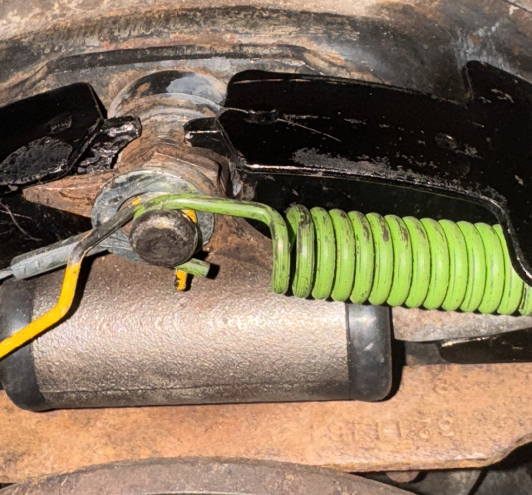

You still need to check brake shoes to anchor pin.
Just checked, they look like they're aligned right, I believe.
bent axles?bent axles?
That gap between the shoes and the anchor pin is your problem.
Pull the park brake strut... I'll bet the drums slide right on.
