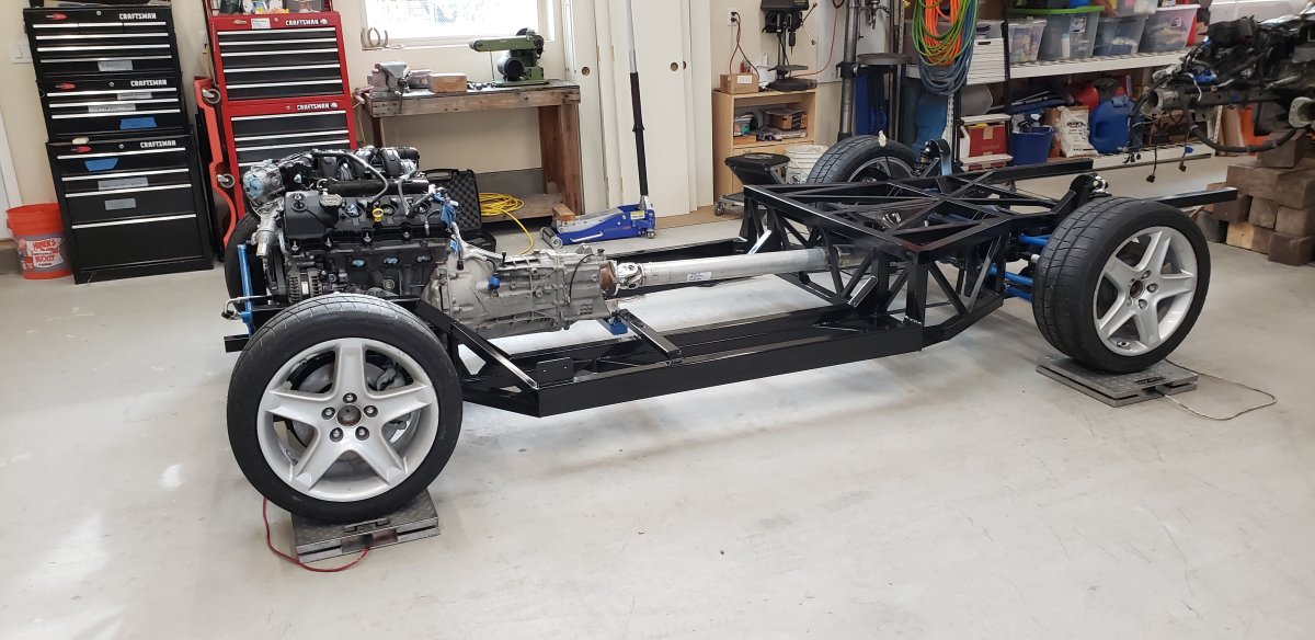

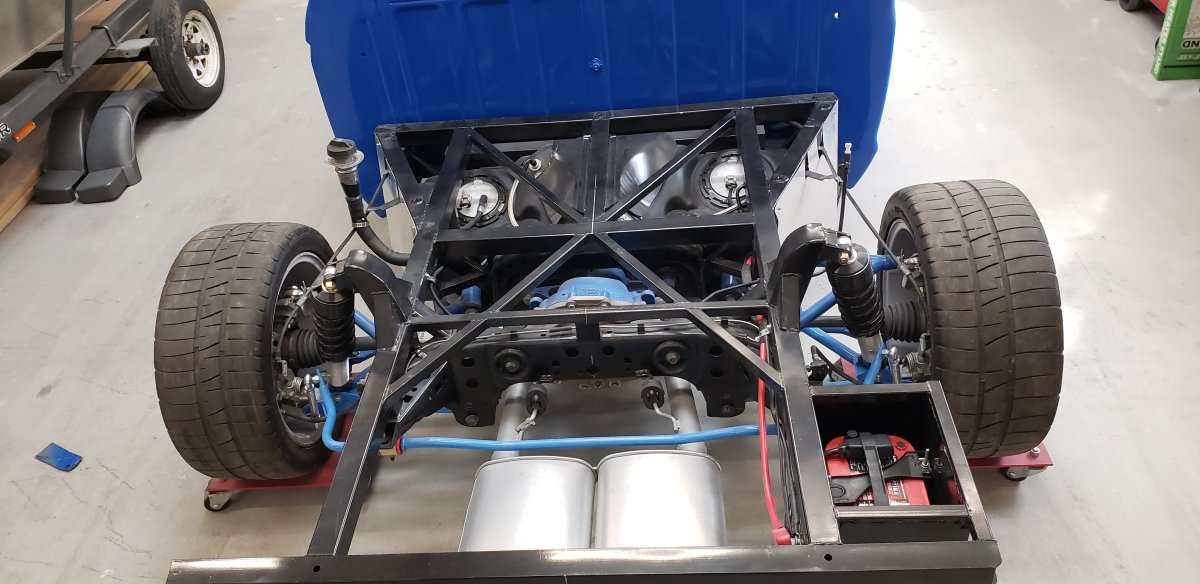

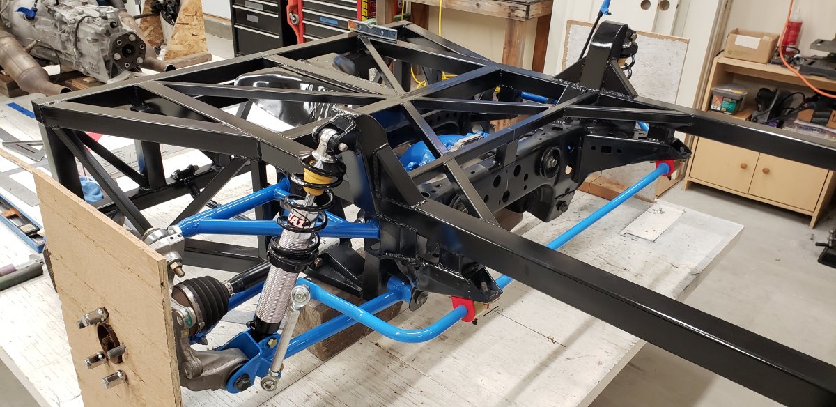

Hey, sounds like a fun project.
To begin a project make a list of the important goals and preparation needed.
1) Purpose of the vehicle. comfort, autocross racing, drag racing, daily driver, car shows etc.
2) Budget
3) shop/work place and needed skills
4) Time
example; I designed my Ranger to race autocross and to drive comfortably on a daily basis.
Handling was the highest priority and a lot of time was put into designing and building a custom chassis.
I'm currently working on adding electric power steering.
