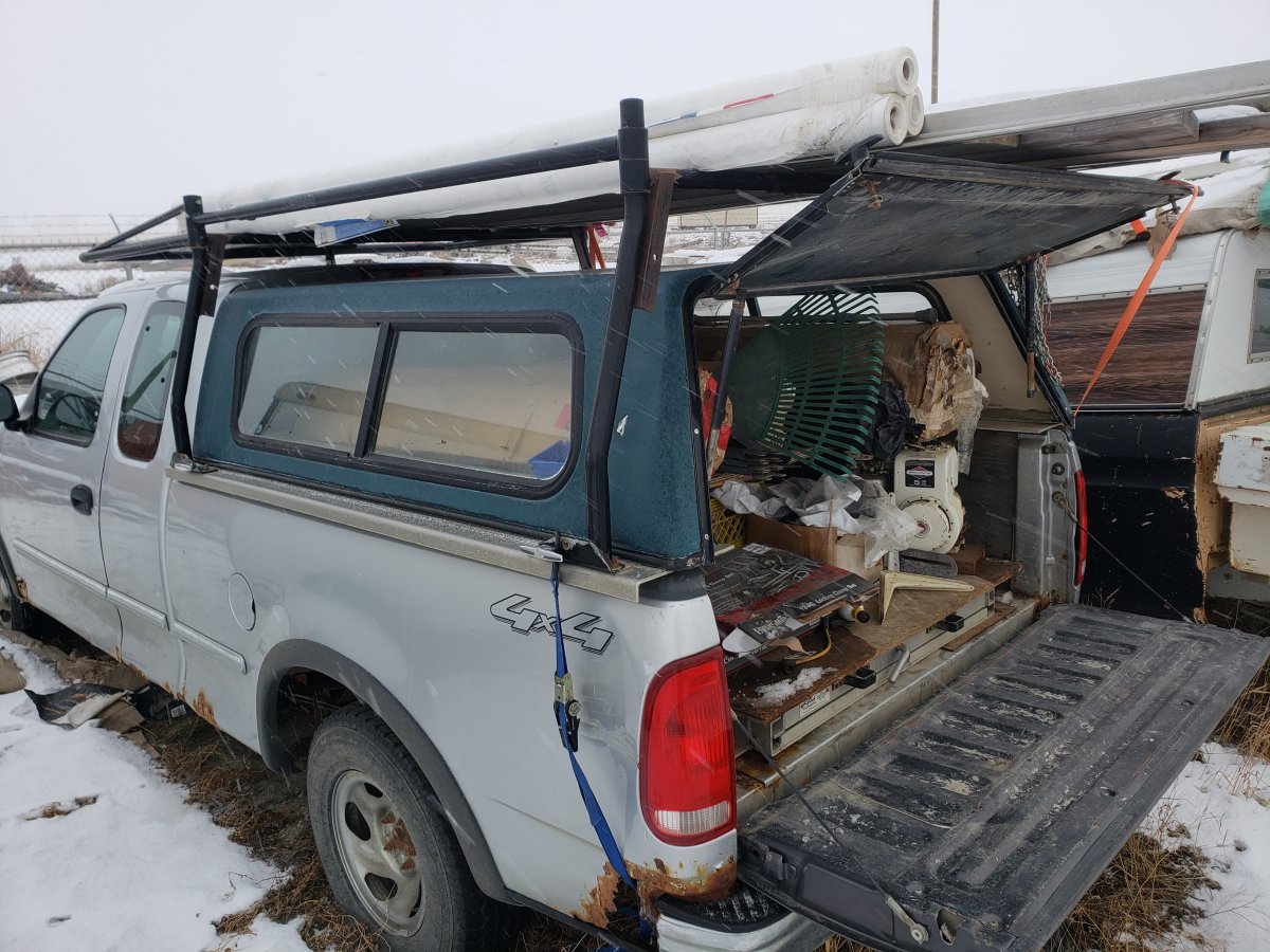

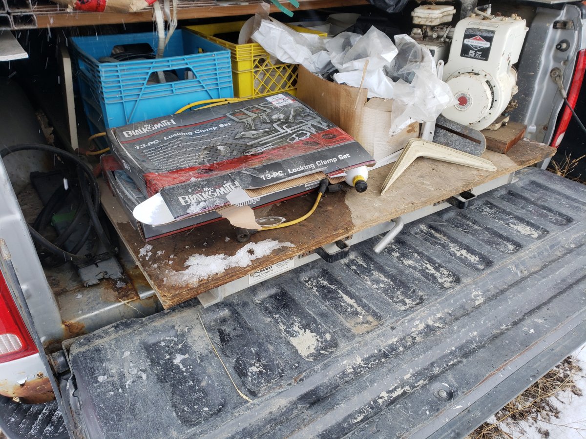

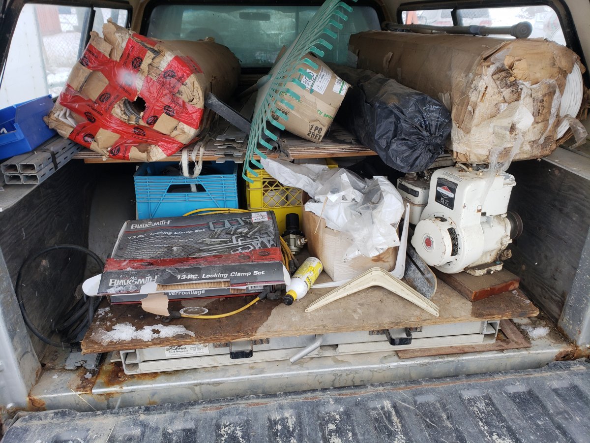

Ive had a fiberglass cap that i mounted home made roof racks to. Probably carried 500# or more every day of ladders and siding. Bought a rollout bed and that solved the problem of reaching to the back. Also made a plywood shelf that slid on the box rails for more storage. I dont have a pic handy on my phone and no longer use that setup.

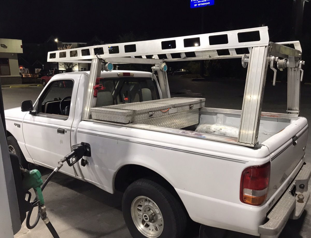

I have mixed feelings on it all. My first Ranger had an aluminum cap with ladder racks on it for years. It came off not long before the truck got wrecked. My F-150 has ladder racks with side boxes. I bought a steel ladder rack for it, then welded some modifications to it. Nice to use on a regular basis, but a big problem when you need to try and keep stuff in the bed dry. My green Ranger I resisted putting a cap on it for a long time but eventually got tired of needing to put stuff in the bed that sat higher than the bed rails and keep it dry. Until my red Ranger got totaled I was just running a bed cover and making do. Was starting to think about putting the cap on the red one and the bed cover on the green one when I finished the 5.0 swap on the green one so I could have both options at hand, but… now that I’m down the red one and the blue one is still wrecked… I dunno

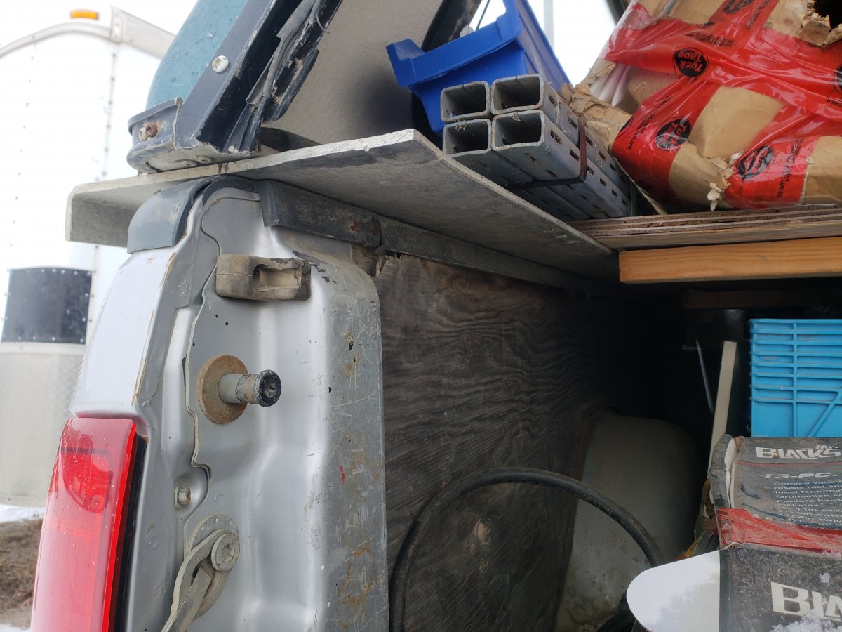

For my full size work trucks I had an aluminum side rail made that i could bolt to the bed sides and the cap bolted to that. The ladder rack also bolted to it. It was made so it would fit both regular box and flair side box. That also allowed the plywood shelf i talked about to slid back and forth. If i find a pic I'll post it up.

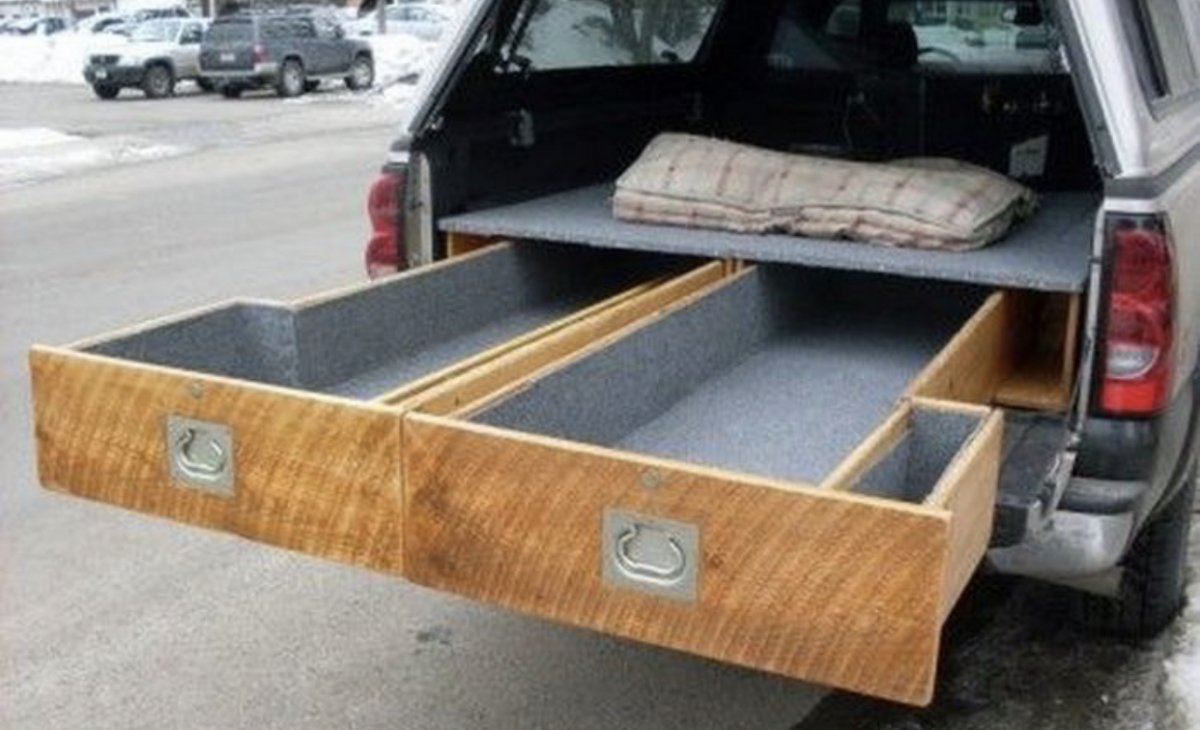

Are you taking about something like this? It seems like a good idea. These are super pricey tho. Wonder if wood can handle such a long drawer. On that note, wonder if a wood latter rack would work.
