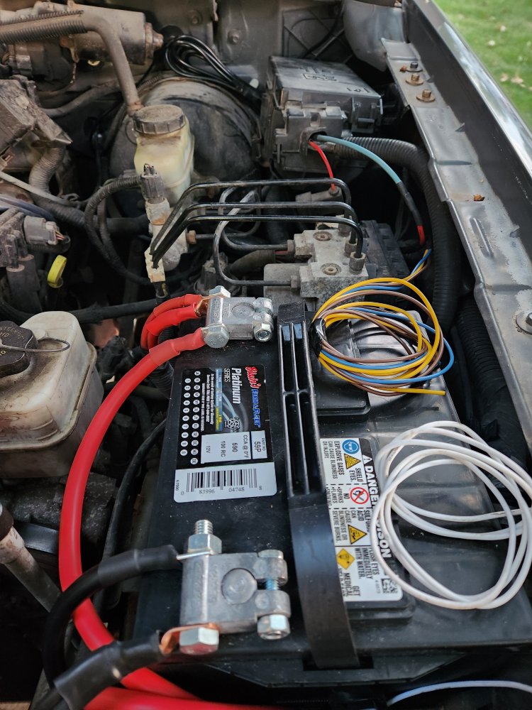

I have a question I'm trying to work on my 3.0 and I have the two red wires coming off of my power distribution but from what I'm reading they're supposed to have fusible links that attached to the terminals so those red wires aren't even supposed to attach to the terminals?
This is what I'm trying to figure out!
Am I supposed to have two fusible links going to those two big red wires coming off of my power distribution box going to my positive I thought they were supposed to go to my positive terminal I thought I took them off of my positive terminal but everywhere I read I'm told fusible links go between them so the actual red wires are not actually put into the terminal but the fusible links are?
I'm also told a fusible link is supposed to go from my black wire with the red stripe down it going to my alternator and I'm supposed to have a fusible link going from my always hot red wire going to the starter none of these are supposed to be in the terminal but all of them are supposed to have fusible links going to the terminal.. this makes no sense to me.. because I swear I had all these into one terminal and they were all just plugged in and I mean they had fusible links on them but to me it didn't even make sense then because fusible links are only good if they're between the wire and the battery post..

There are no fusible links on the 4 gauge wires. I’ve had these harnesses apart. On an 01, there will be a 4-gauge from the positive to the main distribution block in the engine bay, it goes under a little flap that covers the main fuse on the side of the main fuse/relay block. That took the place of a fusible link. The other big positive connections are a 4 gauge direct to the starter and the main alternator wire. No fuses on those. All three go to the positive. The negative should have a 4 gauge to the starter and an 8 gauge to the core support. I replace that 8 gauge with a 4 gauge on mine.
Also, a side note, I don’t see the repair harness on the ABS. Not sure if your truck was part of the recall, but I’d ask my local dealer about it. It’s a free thing since it was a recall to prevent potential fires.
