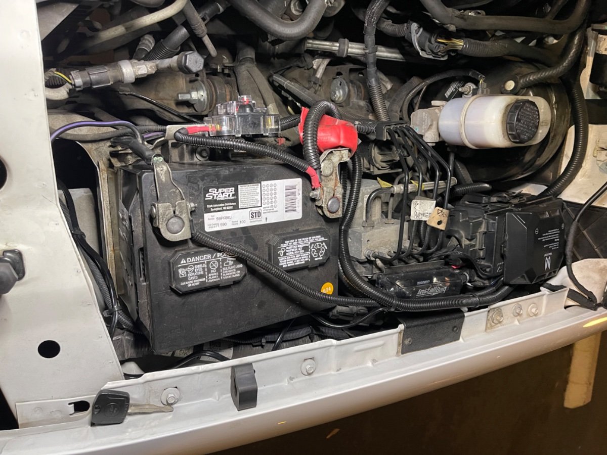

I have a 99 Supercab 4X4 and just installed a winch on the Affordable Off Road front bumper. That winch is an older Ramsey unit and it pulls a lot of amperage in use. I have only would the synthetic rope on it and the battery gauge indicated it took a lot of power to do that (the winch had sat idle for about 15 years). I put on a 130 amp alternator knowing the winch would pull some amperage. Everyone knows under hood space is at a premium in these trucks and I don't how I would put a second battery in it other than in the bed which is not too desirable. A group 59 battery is not very big. Does anyone know of an AGM type for these trucks and/or how to get a bigger battery installed, or even dual batteries without much effort? I am interested in how someone else approached this subject. Thanks for informative replies in advance.

Yeah the battery tray on a 1999 isn't very conducive to putting larger batteries in there, you're kindof stuck with what you have without significant reworking of the tray area.
Unfortunately I don't see much available in the way of group-59 AGMs.

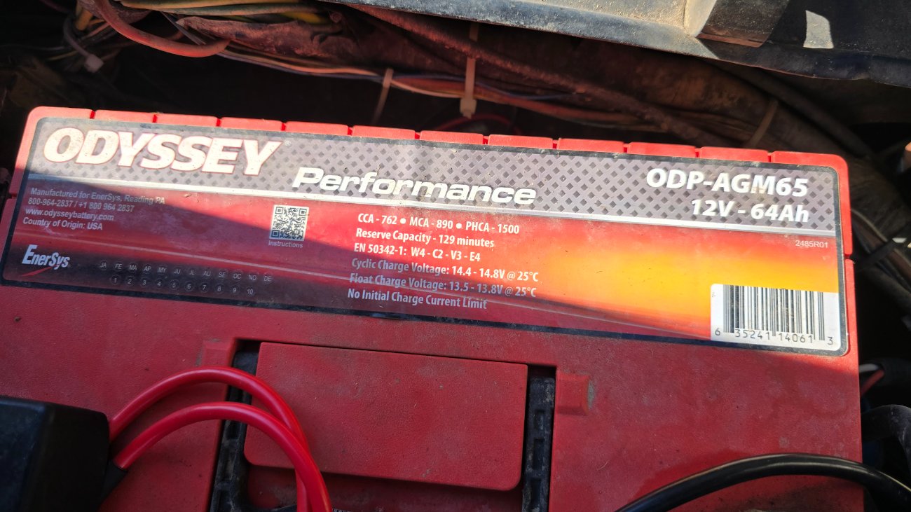

I did find this one from Odyssey... It doesn't specifically say group-59, but the dimensions seem to be close enough that it may fit. But compare them yourself just to be sure.

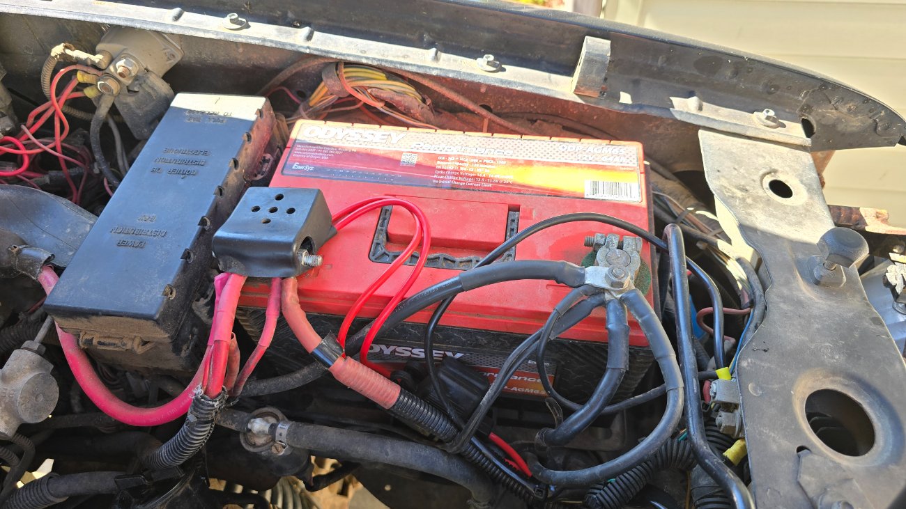

Dual batts are generally the better way to go, although as you said, the 2nd batt would have to go in the bed or back of cab area.
To run a winch off it will require some fairly heavy cabling (#0 at minimum) because of the distance (cable length).
I have a 1994 (different tray style, originally came with a group-65 battery), so I can't help much beyond the above. Hopefully someone else on here has figured out ways to get more battery capacity on a '98 or later, and can offer something further.
