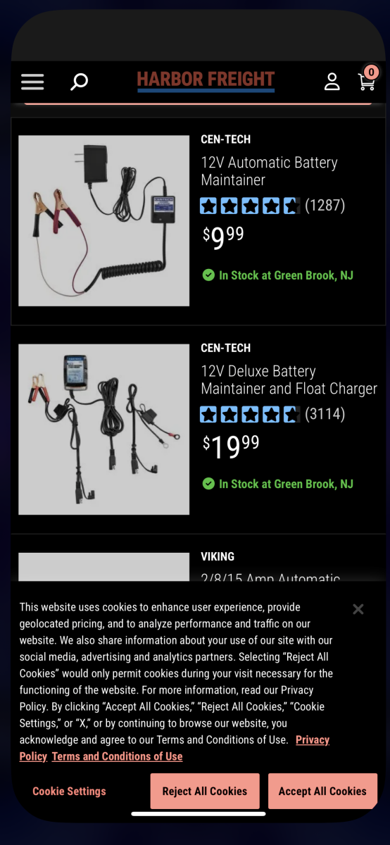

I bought 2 maintainer from Harbor Freight 4 years ago for my truck and generator both still keep my batteries up to par.
