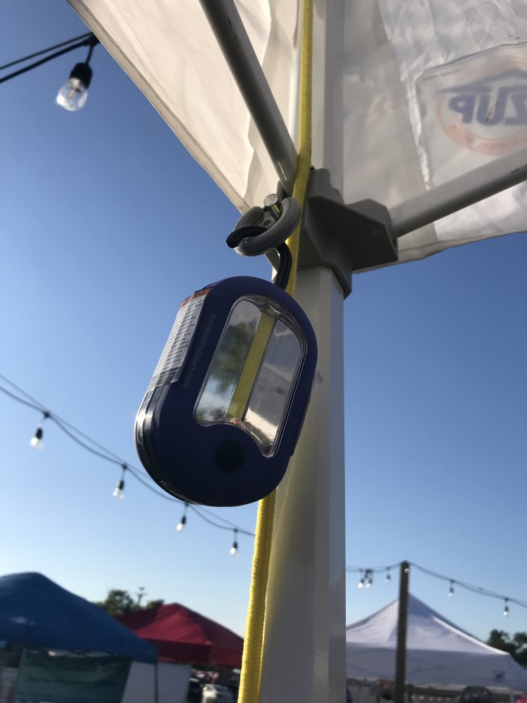

My lady does farmers markets and the night time ones are starting up. I got a handful of these from Harbor Freight for $1. They run on two AAAs. I’d really like to have lights like these that all hook up to a 12v car battery or something. That way I’m not changing batteries all the time. Any ideas? I could rig these up to run on 12v external power, but I’d like it not to be janky. And I’d like an amiable clip. Ideas?

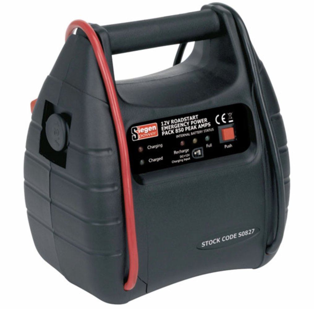

My dad has something that looks like this but without the jumper cables. He could have just cut them off. He uses it to power cooling fans on a telescope. This would be better than an regular car battery… has a handle
