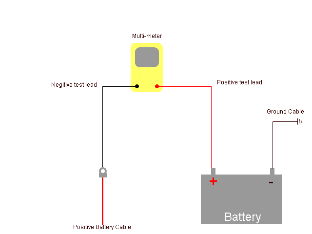

ok here is a little diagram of what ive been talking about. im sorry its not that great my paint skills are some what lacking and hopefuly you can see it.
im not sure how to make it any bigger. i hope it helps.
haha, damn man, i appreciate you takin the time to do that. it is too small to read, but i have adobe photoshop and illustrator and i may be able to enlarge it somewhat or zoom in a bit.
again, thanks alot for puttin so much effort into this. i'll let you know if i figure it out.

Had a few minutes, thought I'd help out with a larger diagram of what I think Bronco_Chuck wanted to show ya with his diagram.
