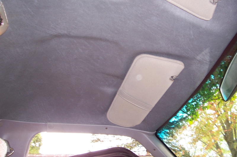

And then I went really crazy... took out the headliner and lined it with vinyl cloth that was on sale when I went to get some foam backed headliner at joann's fabrics. Its heavy enough that spray on adhesive wasn't going to get it done... so I went with brush on contact cement.
The trick is not to stretch the fabric when laying it on... it's basically a rubber band that will bend the flimsy headliner. A heat gun will release the glue for a second try if you get to it in the first day or so... slow and easy.
The headliner is pressed layers of what I'm sure is cotton fiber with a glue to hold it together. I'm sure it's cotton because when I used superglue to get the separating layers at the edge back together, the fibers actually smoked and got really hot - superglue on cotton - who knew?
In places where the thin inside plastic layer (that you glue to after rubbing all the old foam off carefully) came off, I soaked it with wood glue... otherwise, the cotton layers will soak up all the glue/cement you put on it and still not hold. A $12 quart will do a headliner (and I put it on thick)... if most of it doesn't get sucked into the cotton fiber. It might be a better choice for even the foam backed liner given the price of spray on adhesives... roll it on... it's thin out of the can.

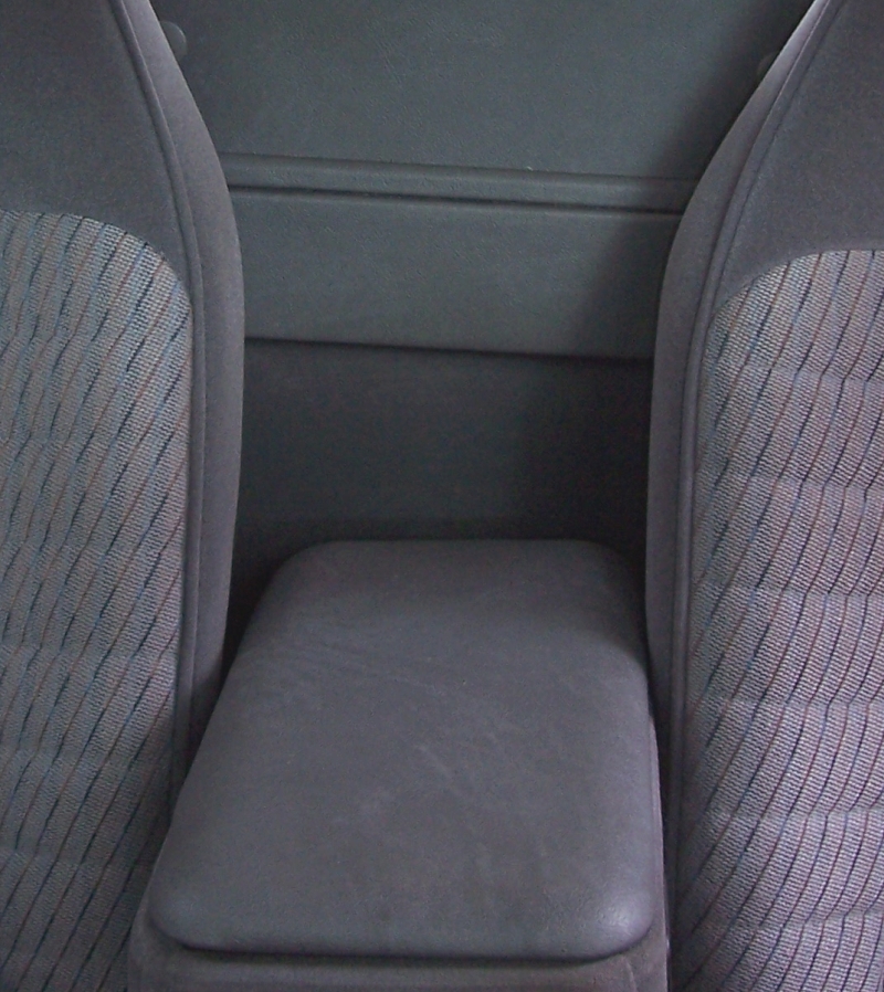

and then I recovered the lid of the center armrest / console because my arm had worn it out. 1/4" staples into the plastic lid.

Normally, it would have been an expensive idea, but the clearance table vinyl was only 4.50 a yard off a 54" roll... and then they took off half of that for what was at the end of the roll... so like $12 for all of it - less than what the foam backed headliner material would have cost me.
It was a bit of a pain at times, but worth it to me... the vinyl cloth is easy to wipe down. With a sliding back window, dirt from the bed always collected on the old fuzzy headliner.
pics.. it has a bit of lighter gray stripy-ness to it making it appear uneven in the pics... but it's all smooth.
