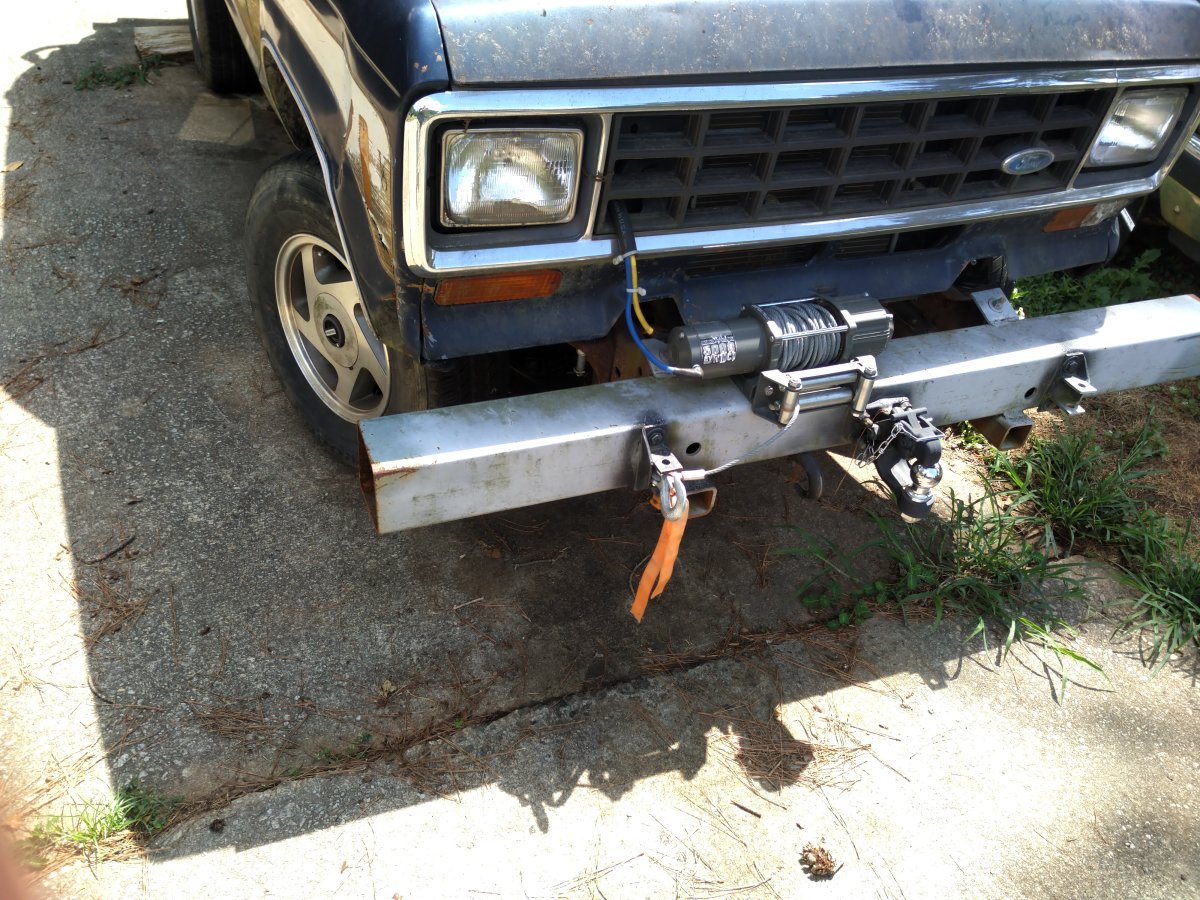

It is like asking where is the best place to put a winch on my steel bumper, without posting pictures of the bumper, and everything attached to it. Location location location.

I see. Interesting mount location btw.
