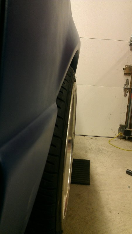

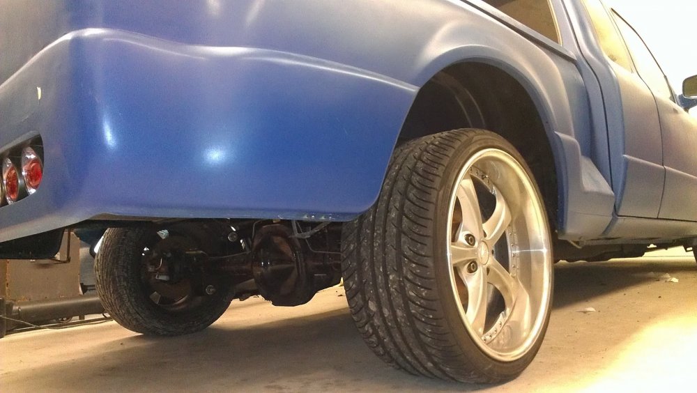

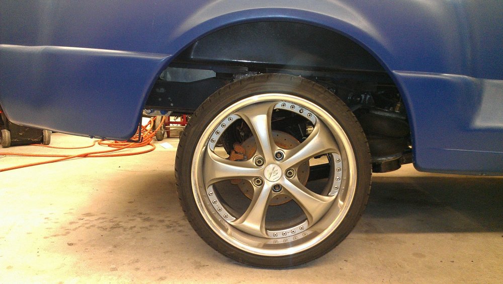

Here are a few pictures of the history of this truck, I bought it new in 2000 and immediately 4 linked, bagged, and shaved it. So it looked like these pics from 2001 until 2012. I have been collecting parts and redoing the truck on and off as a backburner project slowly between 2012 and now.

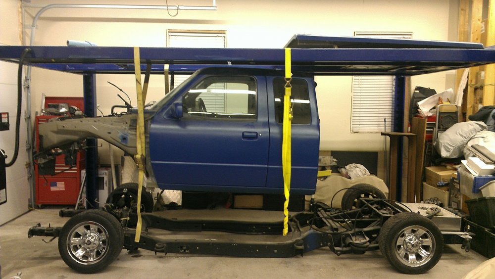

Using the lift to pull the cab and slide the frame out from under it:
Put the cab on some dollies to be able to move it around:

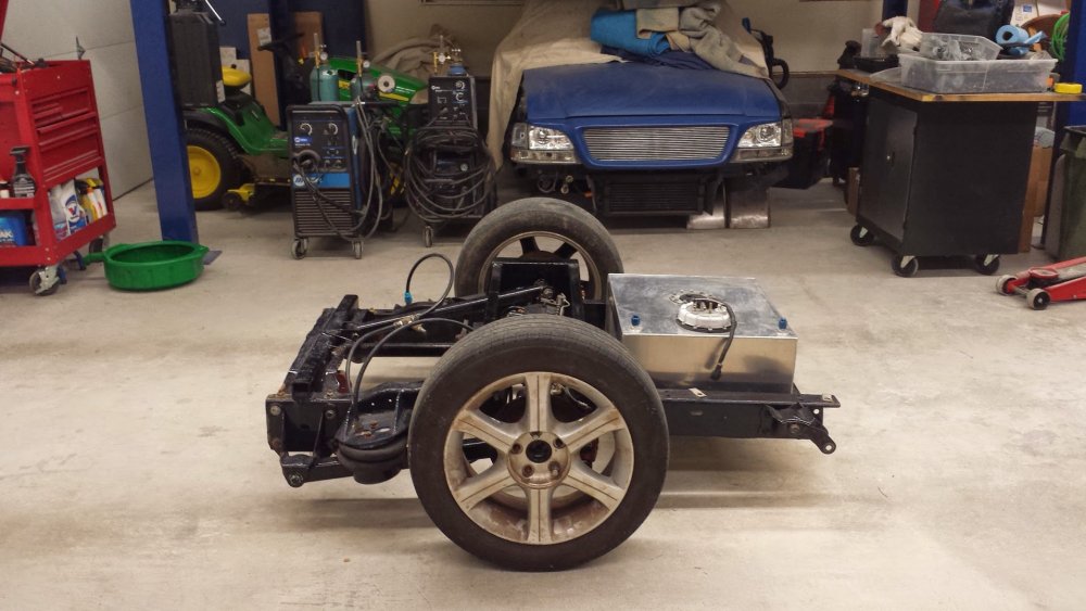

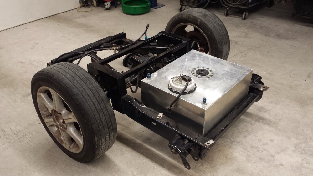

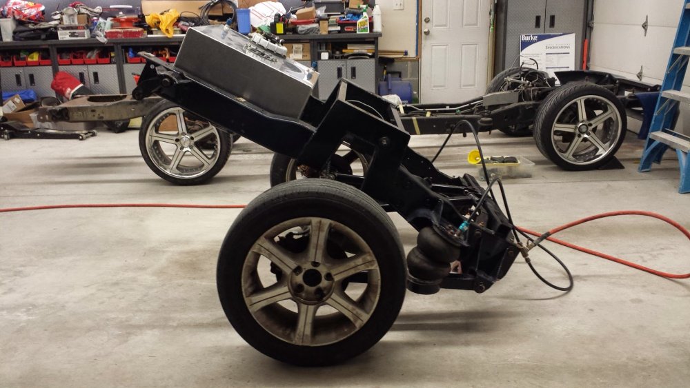

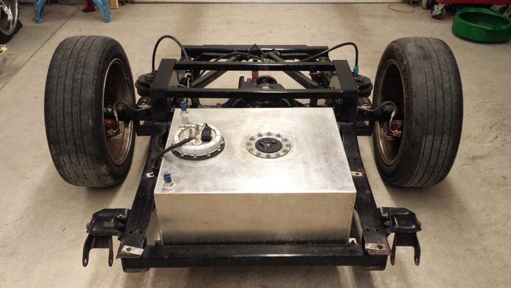

Here is the old 4 linked frame and fuel cell setup:
Interesting build. I like it. Looking forward to more posts.

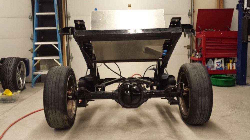

The old 4 link setup got plenty of rear lift. Nice to have so much lift but really unnecessary.

Here is the truck with a new rear half bolted on I pulled from another stock truck to start over from scratch. The old frame setup worked and rode great, I just wanted to have some fun and redo it and will have fuelcell, 12gal air tank, and 2 batteries all under the bedfloor.

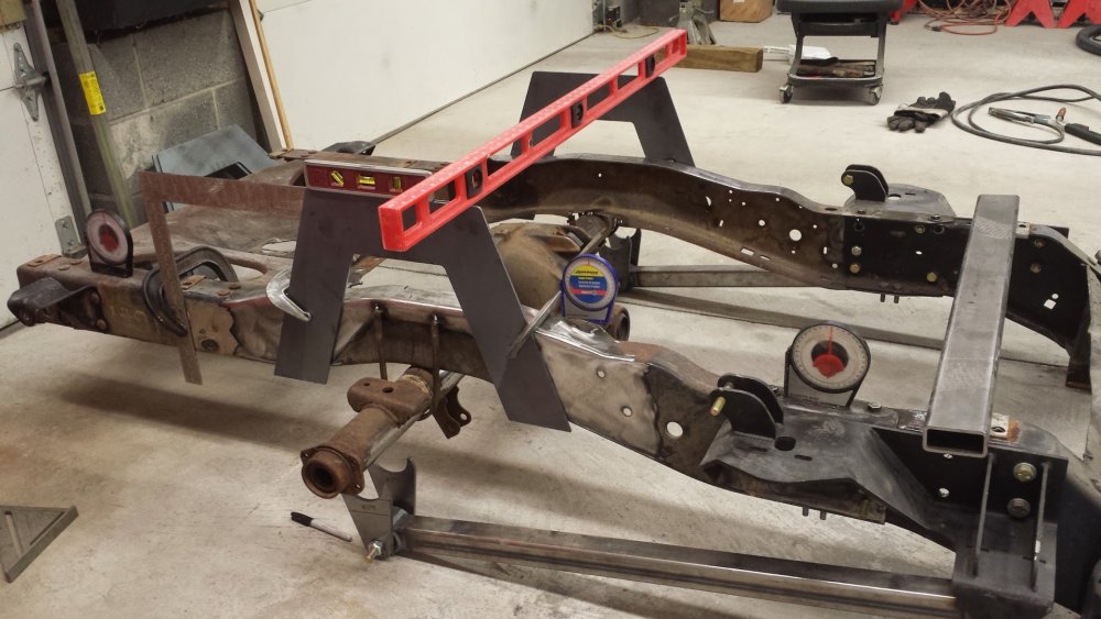

Lots of measuring, and more measuring before welding anything.
And as you may notice I am using the rear lift brackets from the KP Components 4 link kit but with them mounted on the front, haha.. These are mounted against the cab making the link bars 10" longer than when using the stock leaf hanger location for the bars. The one piece brackets take care of the shock mounting and spacing the bag away from the frame as well. I used them just because I thought it would be interesting.

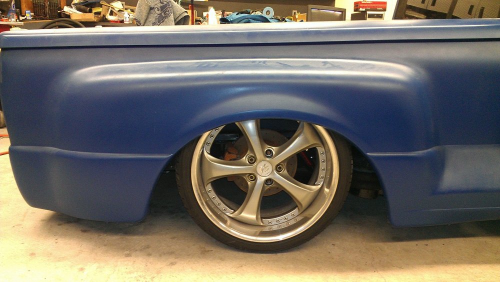

I am using a 1992 Ranger 8.8 axle housing here, as it is 56.5" wide, where as the 2000 8.8 axle that was in it was 58.5" wide (and an explorer 8.8 is 59.5"), I am using the shortest axle to increase the available backspacing to be able run wider wheels (19x11)..

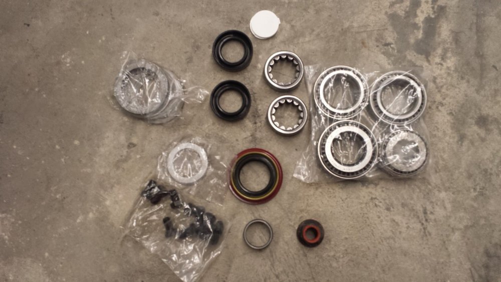

I will be using the Mustang disc brake conversion and the 3:55 LSD internals from my original axle in this housing along with a full Timken rebuild.

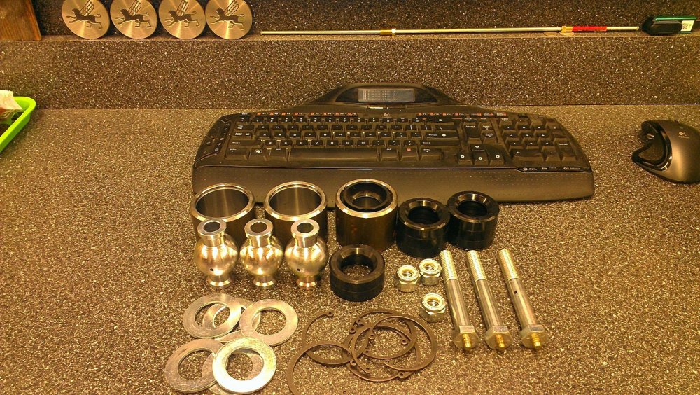

The rear wishbone and lower bars will have superpivot joints on the frame ends for more aggressive side to side.

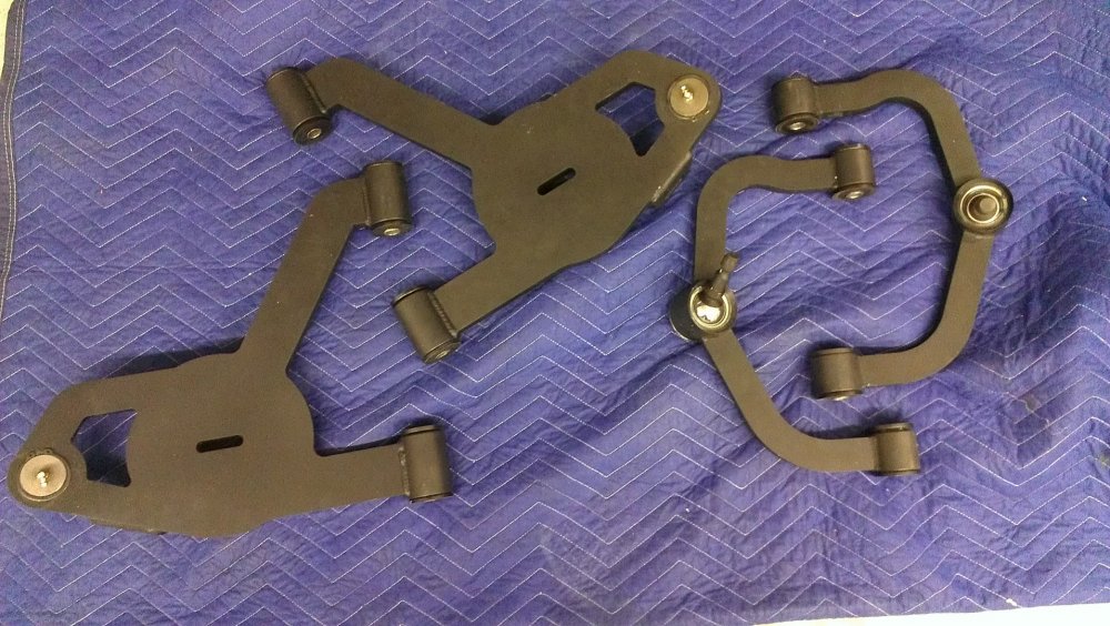

The front is using MMW control arms, which I already had upgraded from DJM on the truck previously before the teardown. They fit well, I had ordered them +1" forward to give more firewall-to-tire clearance, and -3/4" inboard to allow wider wheels up front (19x9.5).

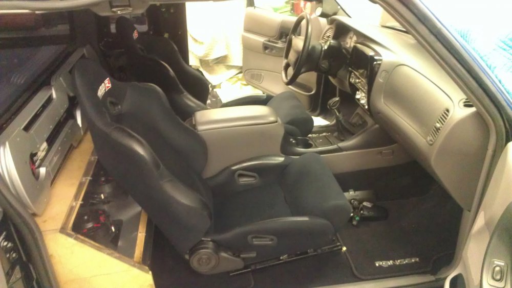

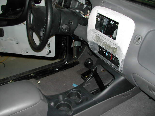

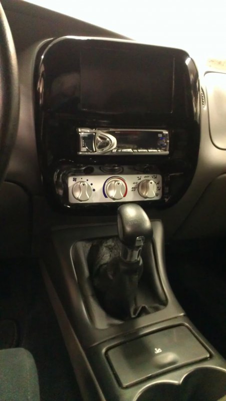

This is the stock dark graphite interior, I have since bought a complete FX4 Level II Black/Ebony Interior which I have not installed yet, I will do this after the truck gets painted.

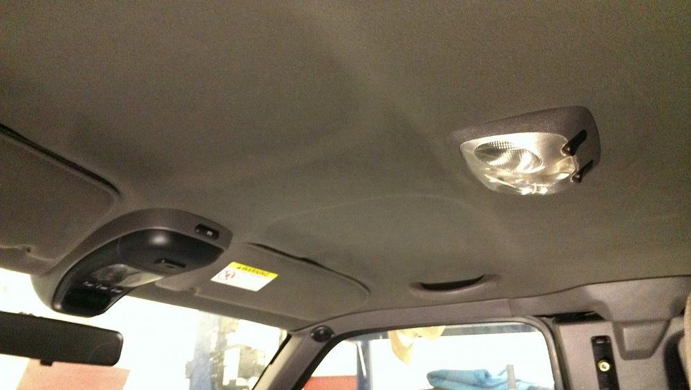

Explorer Overhead Console, Center Console, and Dome light Conversion. (These pieces will have to be dyed black once I swap the FX4 interior in..)

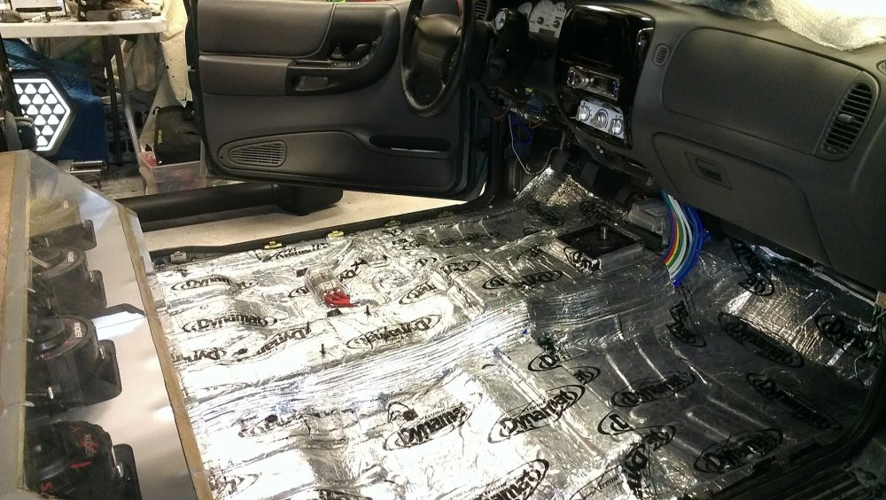

100% coverage floors/doors/backwall/roof with dynamat and all voids spray foam filled x4 L7 kickers with dual PPI 1500.1 amps
Took the sub box to a friend that made an upholstered bezel for me, he did a great job.

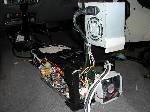

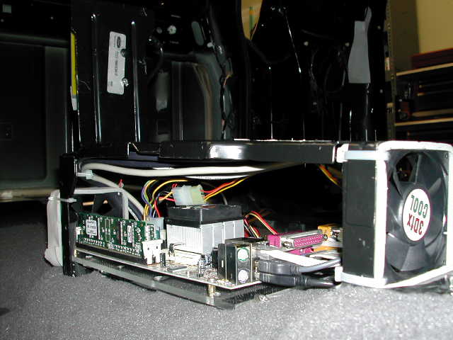

Back in 2000 I had built a mini pc that fit under the explorer console that had Earthmate GPS software and Winamp with all my mp3's on it, and an external 802.11 B (haha soo slow) so I could sync my music folders from the driveway (this was pre-usb sticks and bluetooth days), it was fed to a Touchscreen 7" VGA monitor molded into the dash, and the stereo I used was a Panasonic Dolby Surround dvd headunit with motorized flip out center speaker, the video output of the dvddeck was was fed through a rca-to-vga convertor. Pretty cool for the time but extremely dated now!
