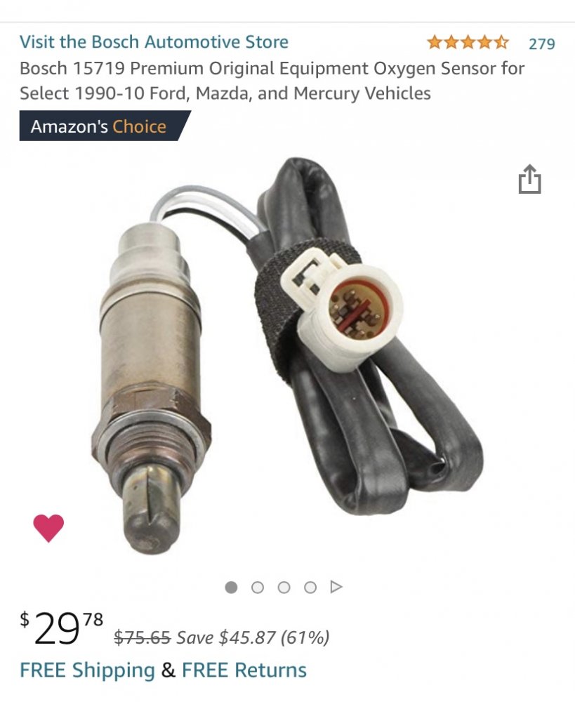

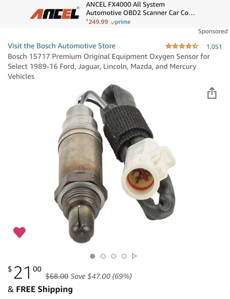

Can I use this?

Upstream Right: Bosch 15717 $21.79
Upstream Left: Bosch 15716 $21.79
Downstream Bosch: 15719 $22.79
These prices and part numbers are from Rock Auto. I just did mine a month ago.
