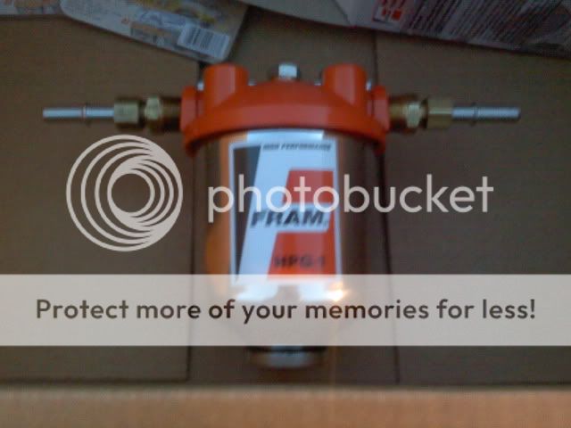

I ditched the factory style with the silly spring lock fittings.
I put a cartridge style housing in its place and run a 10 micron Wix filter.
No glue to fail, the cartridge is squeezed together by a bolt and sealed with an o-ring.
I will admit its a Fram housing, but I didn't even use the filter it cam with.lol
-PlumCrazy
I've thought about doing that sort of thing since I want to say that I've seen ones like that for fuel injected motors.... care to share exactly how you did it and where you found the filter setup?
I cut the quick disconnect fittings off an old stainless Motorcraft filter and used 5/16 compression to 3/8 male NPT adapters to screw into the housing. the new filter housing will just connect to the stock lines easy as pie.
Only pic I have of it installed.
Rated to 100psi working pressure.
-PlumCrazy
