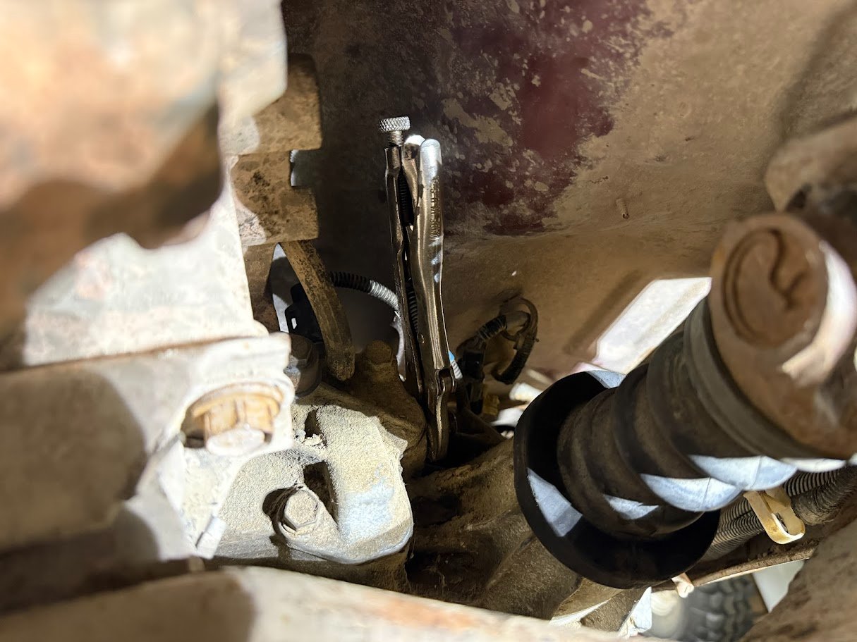

My original plan was to put a 1350 manual t-case in this so that it is still 4wd and I did do that but I do not have the right shifter parts. I don't know if I ever did - the little arm on the t-case is mainly what I am missing. I think it might be a one or two year part - 88/89 truck with a 4 cylinder and M5OD and I've only had one of those ever. Those would have also come with D28's....... and I also don't have a driveshaft... I have one from an automatic but it's too long by at least an inch. I found one that had "FM-145" written on it that's almost too short but it'll be good enough. Plan for the shifter deal is to just leave the floor plate off and I'm going to leave some vise grips attached to the t-case in case I need 4wd.

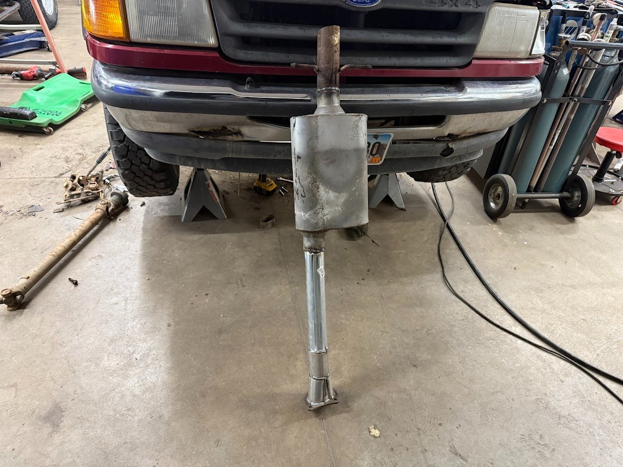

After confirming that the clutch and stuff is working and bled, I moved on to exhaust. This truck will never see the road again but I don't want it to be really loud. I'm going to leave it parked in the woods so I also don't want it straight piped with no spark arrestor. I did a lot of digging in my muffler parts stash and came up with some things that fit together: my Y pipe adapter, a piece of chain link fence post, a minty knockoff Flowmaster that I found on the street in front of my house, and a short driveshaft chunk to make it long enough to fit into the rear exhaust hanger. The only other muffler I had is huge and wouldn't fit. Sounds pretty stupid but it's not super loud!

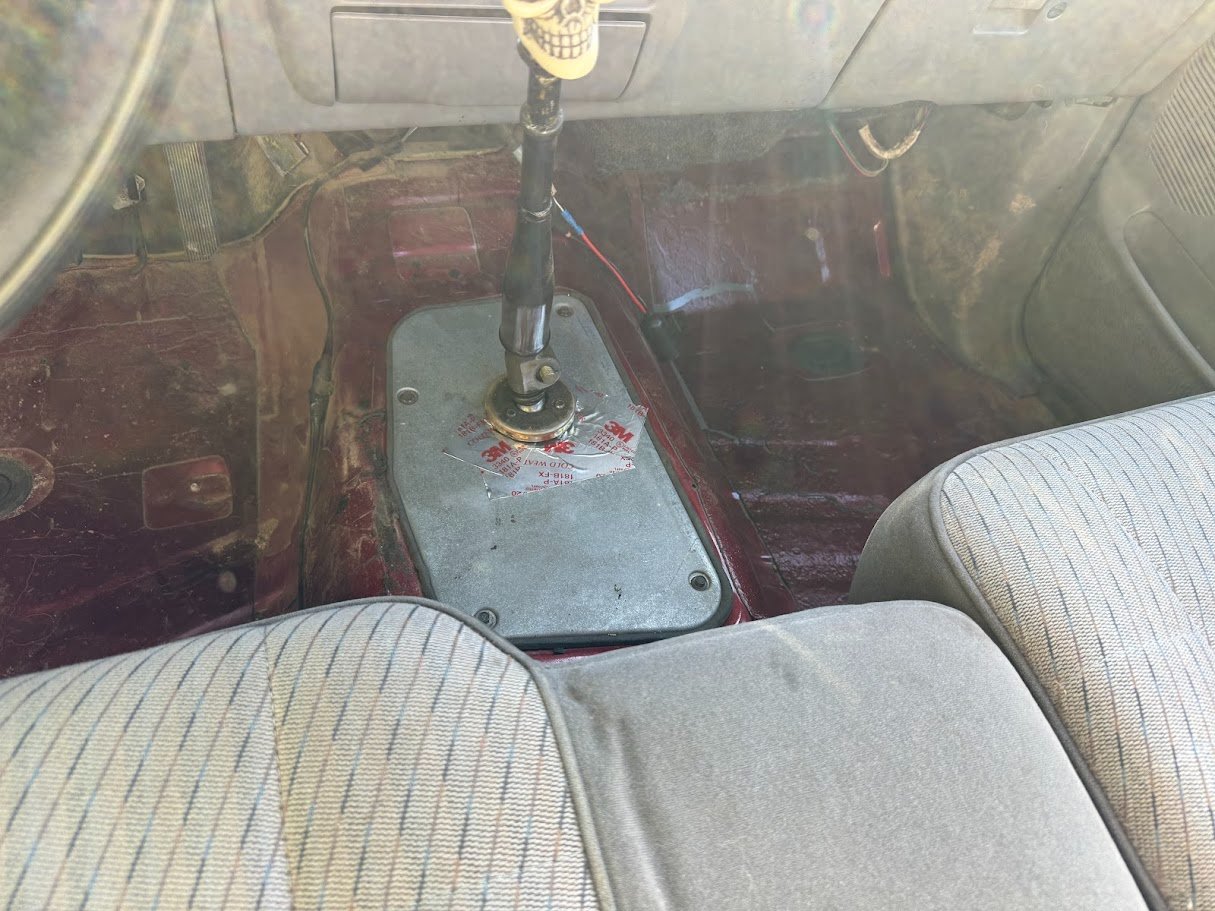

- make new floor plate to close up the hole where the t-case shifter was (for storage purposes mainly.)

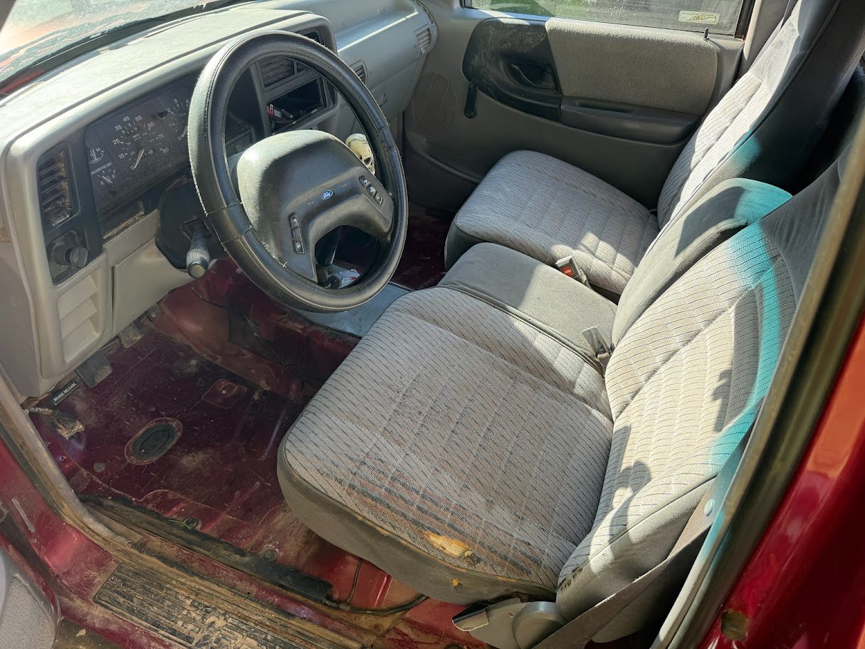

I got the interior cleaned up last night. Threw the carpet away and spent over an hour shampooing just the seat bottoms. That seems like a lot of work for such a piece of crap truck but the passenger side one had something brown spilled on it. Maybe poop, maybe a chew spitter, maybe who knows what but it was so bad that I couldn't sit on it, much less ask someone else to sit on it. The driver's side was just dirty. Weather looks pretty nice the next few days so they will dry out and be ready to go by the 1st.
Floor plate is done, just took a blank one from an automatic truck and cut a circular hole in the middle for the shifter to poke out of. Taped around it, should somewhat keep the mice out when I'm not using the truck.

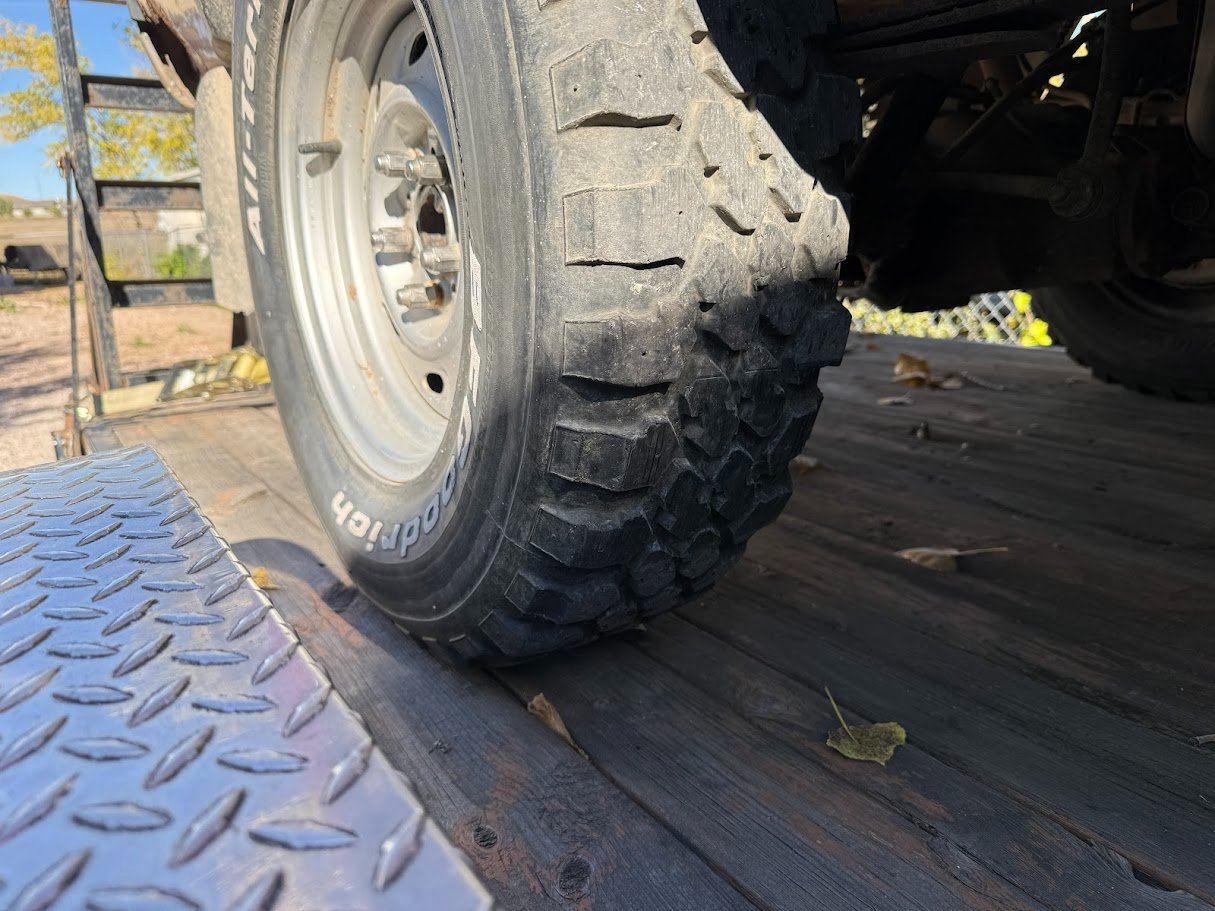

Pretty jacked that I get to use these tires on something finally. They are horrible old retreads but they look cool and hold air long enough to have some fun.
