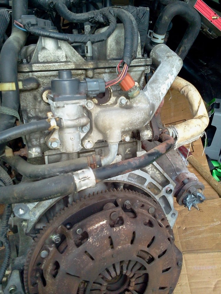

by the way, that's a 2002 engine. other than the aluminum valve cover and the intake flapper it is identical to a 2005.
45 pipe is coolant outlet (or inlet, not sure which way its flowing) from the head. it turns and goes towards the front, above the exhaust manifold.
there is an O ring inside it where the next tube attaches.
pump looking thingie is the EGR solenoid.
in the head, exhaust port #4 has a side hole that feeds some exhaust gas thru a tunnel in the head going to the EGR solenoid.
solenoid then allows EGR gas to pass out the front of the head into the intake manifold.
