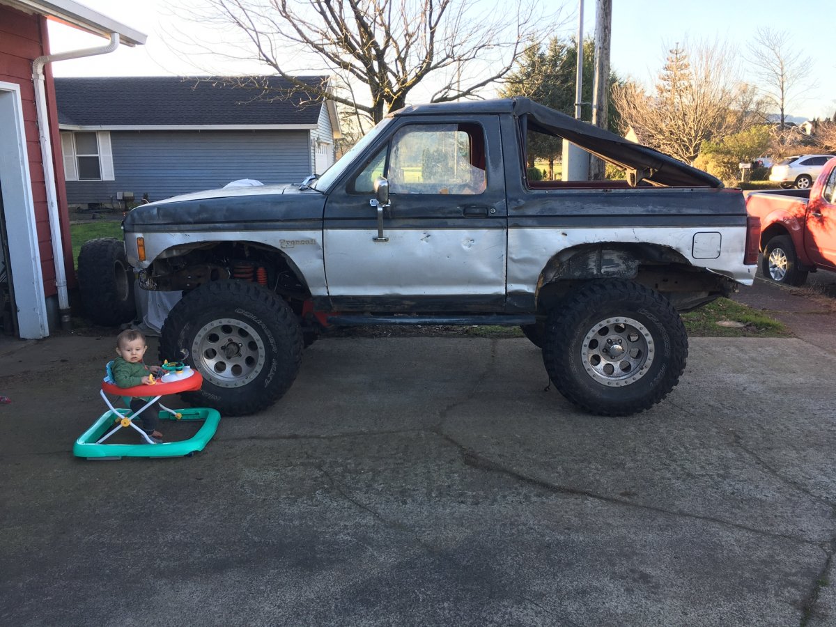

I’m sure there is a thread but I cannot figure out how to use this site (first time here). I’ve tried searching and couldn’t find anything but I’m trying to figure out axle gearing. I have a 1988 bronco 2 2.9l manual front TTB rear stock welded and I’m just looking for a quick answer to what gears I should run. I’m on 35’s and will be doing some highway driving but mainly woods driving. Here’s my ride also! 😊
