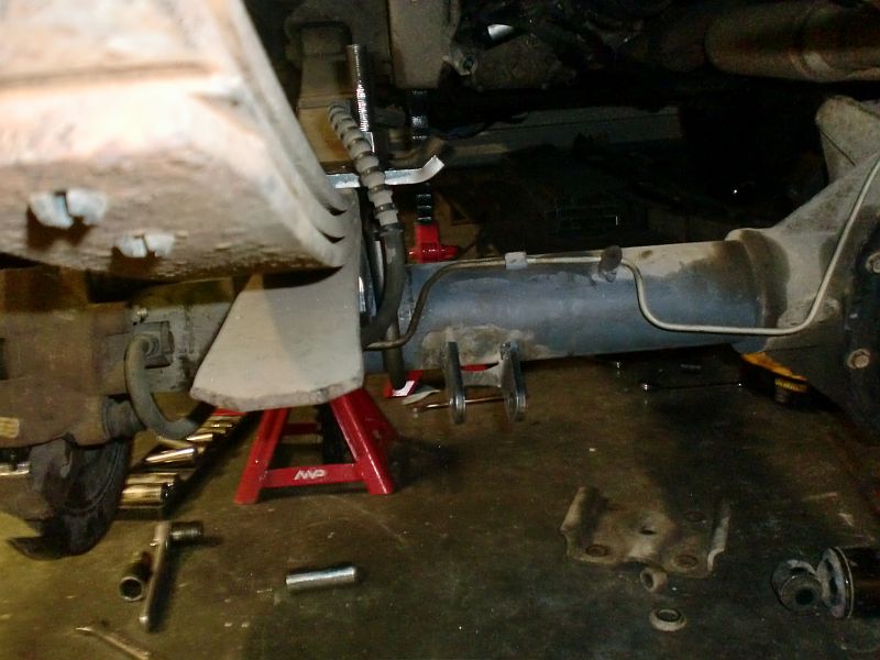

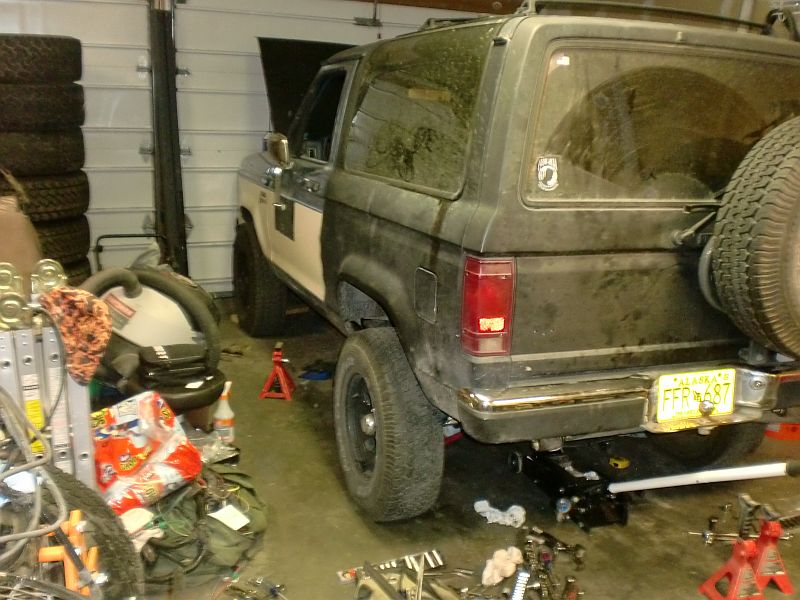

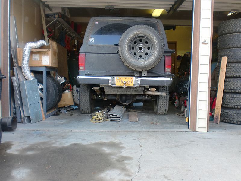

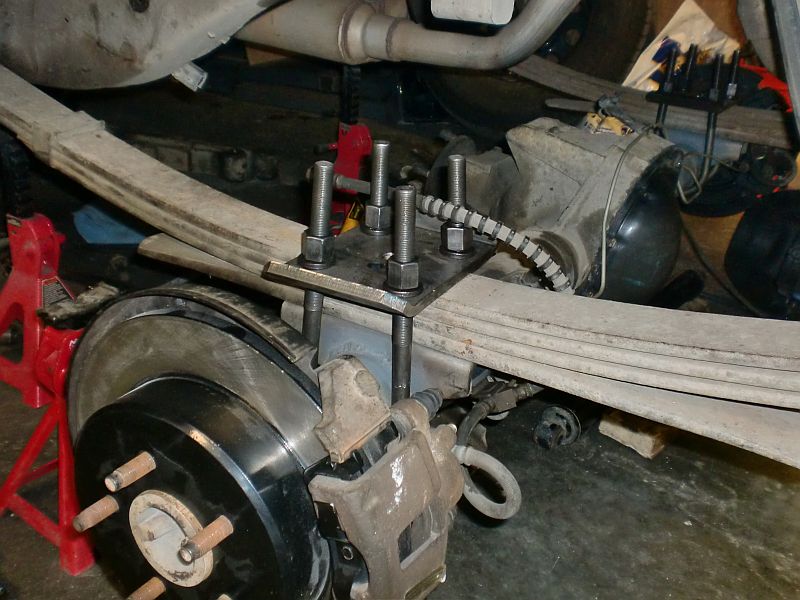

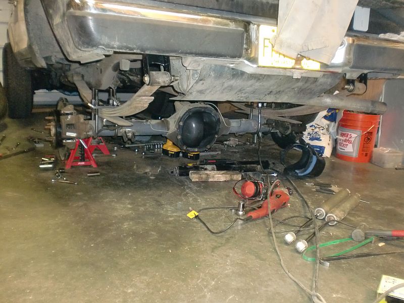

Okay,
here are some pics of the 8.8 installed along with 4" belltech shackles. 4" Skyjacker lift getting ready to go in now. And no it's leaking. That is WD-40 from when I had is standing on end to tack on some metal for the disk brake lines to attach to and drilling and tapping the holes. I cleaned it up later...
