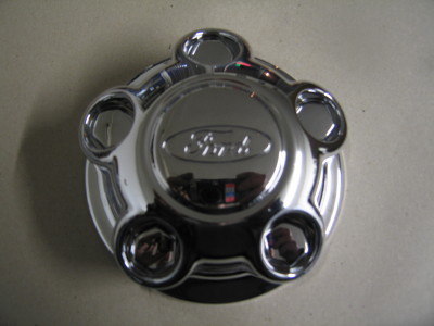

i'm ordering my avm hubs. how do i use them with center hub caps? do i need to cut a hole in em or do i need to just keep em on till i need to lock in my hubs an take them off to lock them in any suggestions?
Are you talking about this center hub cap

If you're talking about the first picture I would leave the center caps off all winter for easy access and leave them on in the summer and take the hub caps off whenever you need to use 4x4.
If you're talking about the second picture the AVM hub takes the place of that so you just toss the stock one.
