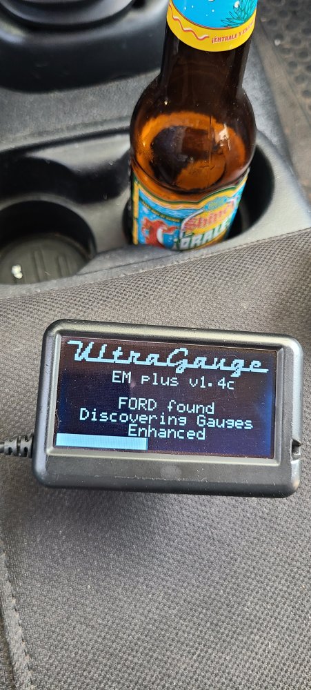

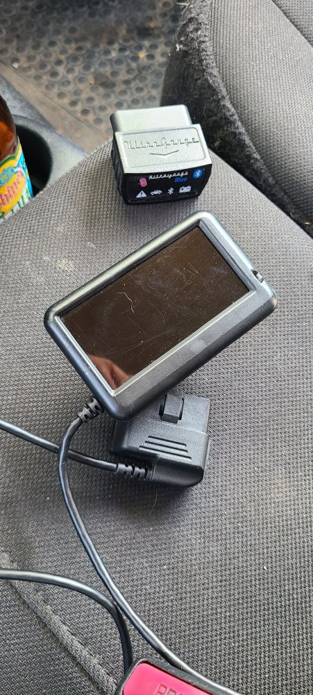

Turns out i have scangage and ultragage. I think i have had them in the truck but don't know enough about that kind of thing and took them out after trying them for a few days

I'm about to pull the trigger on either the Scangauge II or the Ultragauge, do you have any preference at all or opinions?
the ultragauge has a larger screen so you can see more stuff. thats about the only thing i have noticed that is really that different between them.

Would you be interested in selling the ultragauge?I'm over here in Canada, but the utlragauge website is asking like 90$+ USD just in shipping. I'm sure it could be done cheaper.
thats actually my son's. he bought it and never uses it but i can ask.
