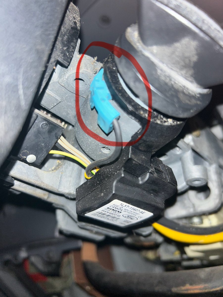

Any idea what this blue plug is? I noticed it was loose when I took the steering column cover off to check the wires on the column.
  • Auto to manual swap
Pretty sure that’s for the dingger that tells you the key is in the ignition.
I messed it up while screwing around with my steering column a few years ago and the key dinger goes off any time the the door is open now regardless of if the key is in or not.
