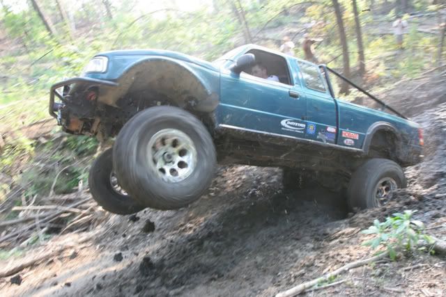

that looks like a fun ride, have to give you props on that one...is that from UA?
Ya it was, that launch is what killed the detroit.
