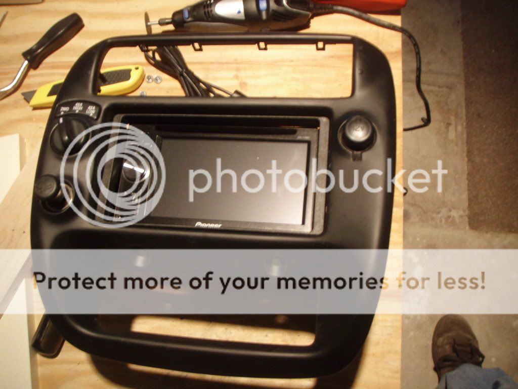

Installing the Head Unit Part 1
Supplies:
Ratchet set w/ a 9/32 socket
Box cutter
files
Dremel with cutting edge and sanding edge
Pioneer AVIC-F700BT (or a double DIN HU)
metra 95-5600 dash kit
flat head screw driver

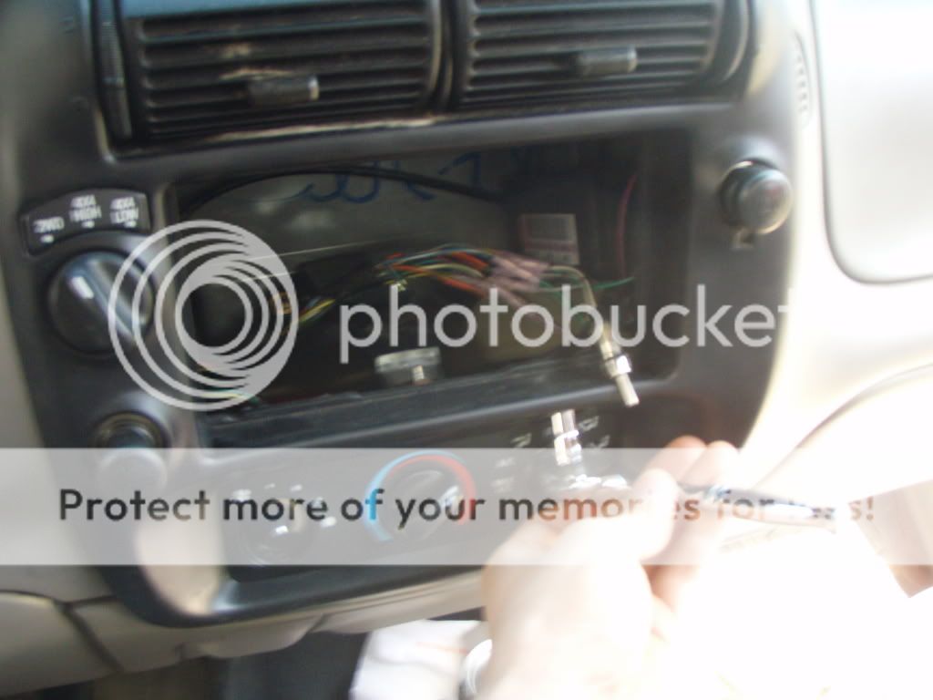

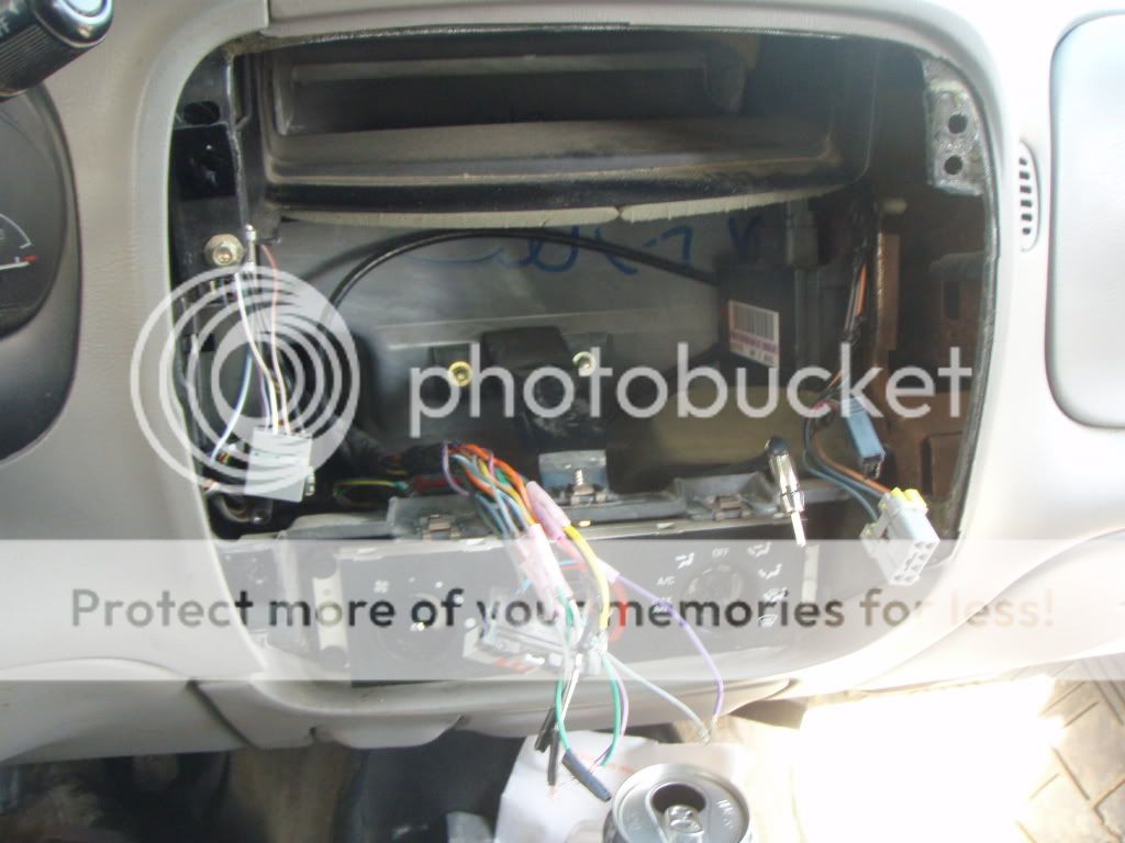

Using a 9/32 socket, unscrew the the two bolts holding in the dash piece
Disconnect the 12volt plugs and cruise control (use a small flat head screw driver to remove the plug)
to give yourself some room, remove the air duct ply gently popping the clips that hold it in place.

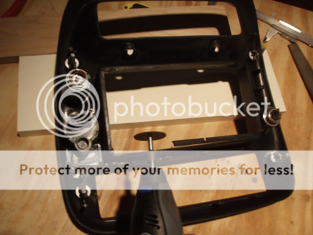

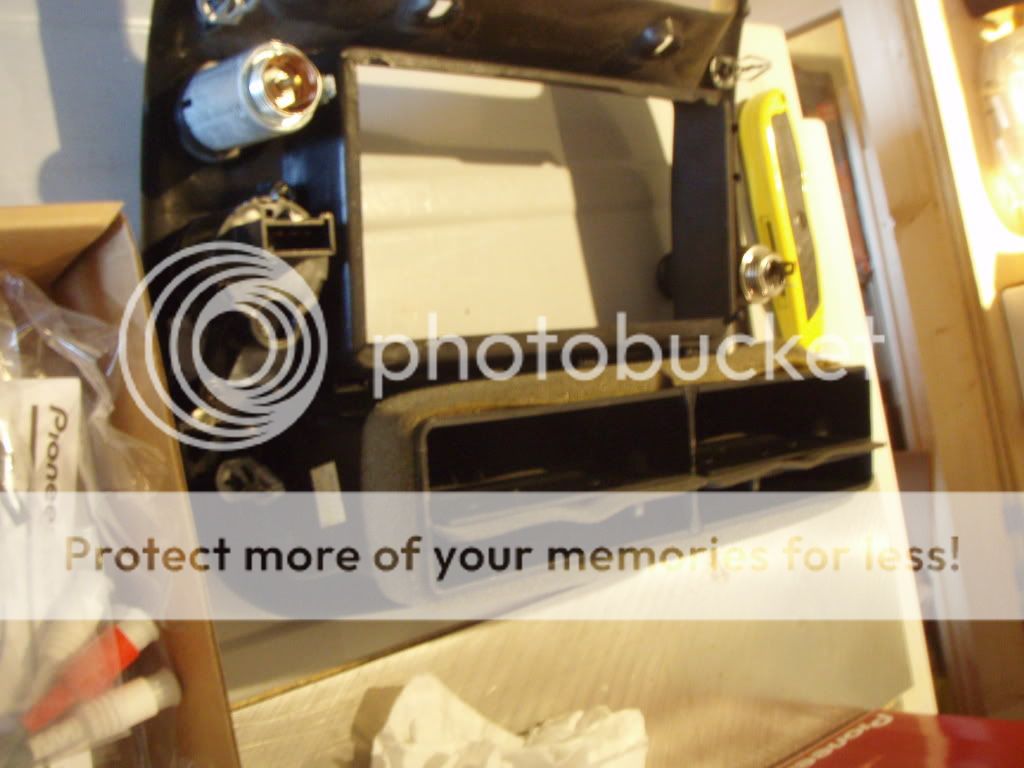

Using a dremel cut/sand away the upper and lower lips but keep the sides intact. Use a file and the box cutter to finish the edges.
cut off the small nub to allow the dash kit to mount flush.

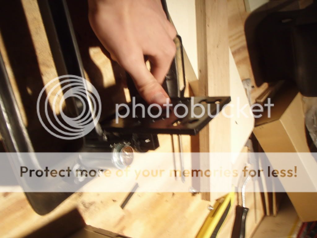

Mount the front trim piece.
attach the left and right slots by hooking the tabs into the sockets inside the trim piece
Slide the dash over your head unit and screw in the slots.
And you have successfully mounted your AVIC-F700BT to your dash!!! You can run a bead of silicon behind the dash to close the small gaps or you can leave it as is.
part 1 looks pretty good damn, nice HU, looked it up.
anyway, try and get some more clear pictures, a few of them are great, but a few of them are really blurry.
looks like a good beginning mod for somebody to tackle, as it's not too difficult.
