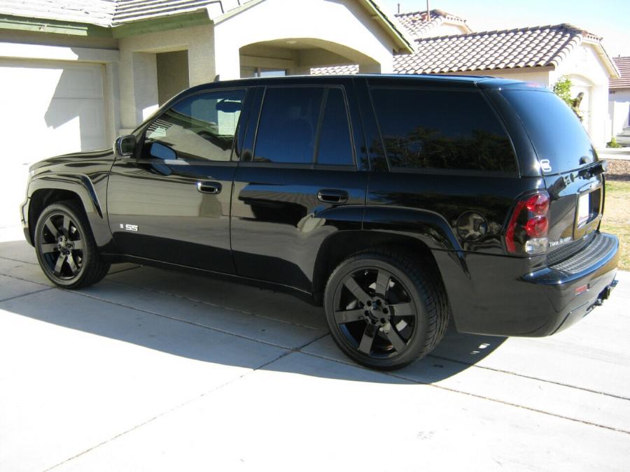

Well just a lazy weekend cleaning the garage and changing the oil on the ss . Thought I take a pick with my all 3 rides and my customers mustang snuck in for a photo bomb lol
I just wanna go fast [emoji48]
Not going to lie....your garage is pretty sweet man. How's that stang coming along? Any updates on ranger?
Just need to find a crank pulley smaller then the 6 1/2 on it now since the water pump and crank are touching but must work with mustang setup . The reason why that last pump failed . Trying to find a smaller crank and keep the bigger water pump pulley it has now
The ranger is running great and putting mileage on it quick . Need to get the tach Recalibrated still .
My ss not so much . My wife got tboned by a teenager running a stop sign two days ago . Taking it to the body shop today . And picking up a rental . The teenager was cited so all should be good .
Hoping to getting stock rep 20x10's for the rear now .
Another fellow tbssowners forum member
With the 20x10's rear , stock 20x8 front
