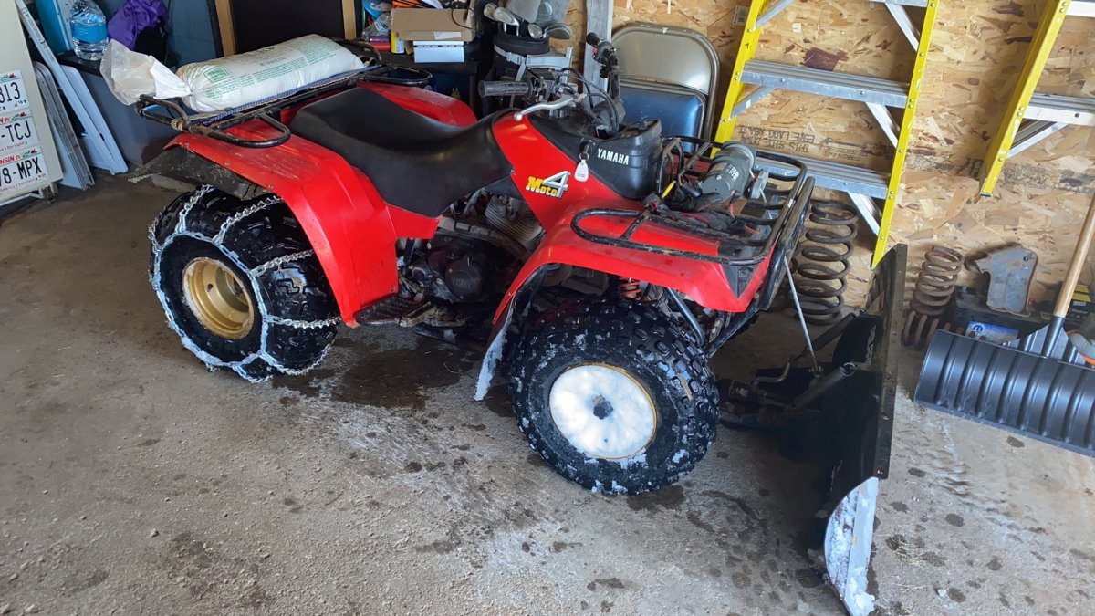

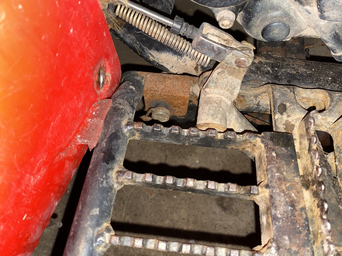

I run a 48” Polaris blade on my old ‘88 Moto 4 4x2. It’s a home brew mid-mount that uses small pieces of angle iron welded to the factory foot boards. Harbor Freight 2,500lb. winch with synthetic line mounted to the front rack. It will push 10” of wet crap with the chains clawing pretty hard at the black top. Took me 2 winters to figure out how to plow my driveway with this thing.

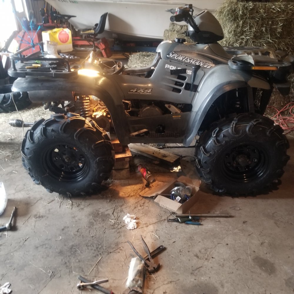

Heres mine, not quite done but givrs you a idea.
Before tires and lift. Ill get better pics tmw.

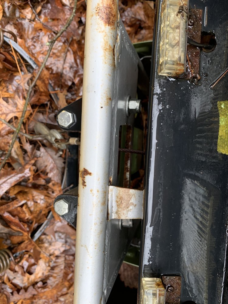

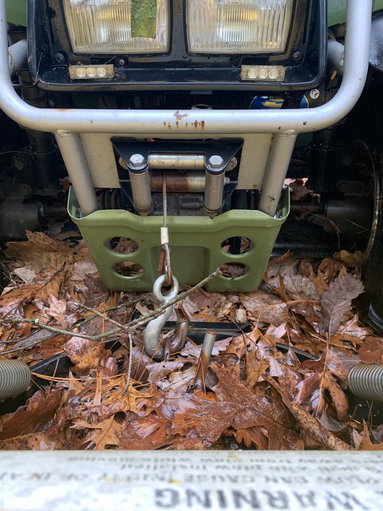

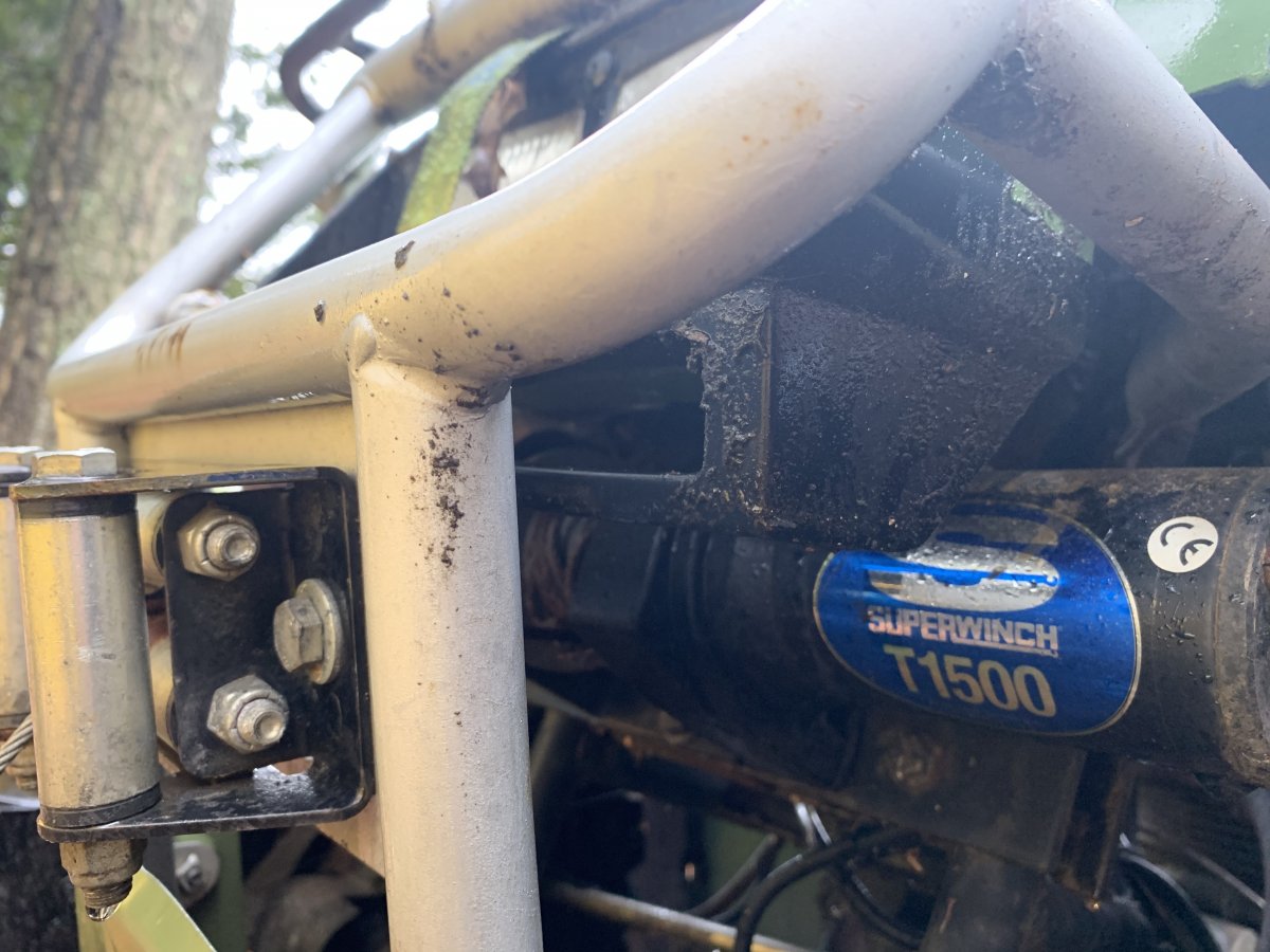

I made a plate to mount the fair lead to the factory push bar and welded that in.
37003
37004

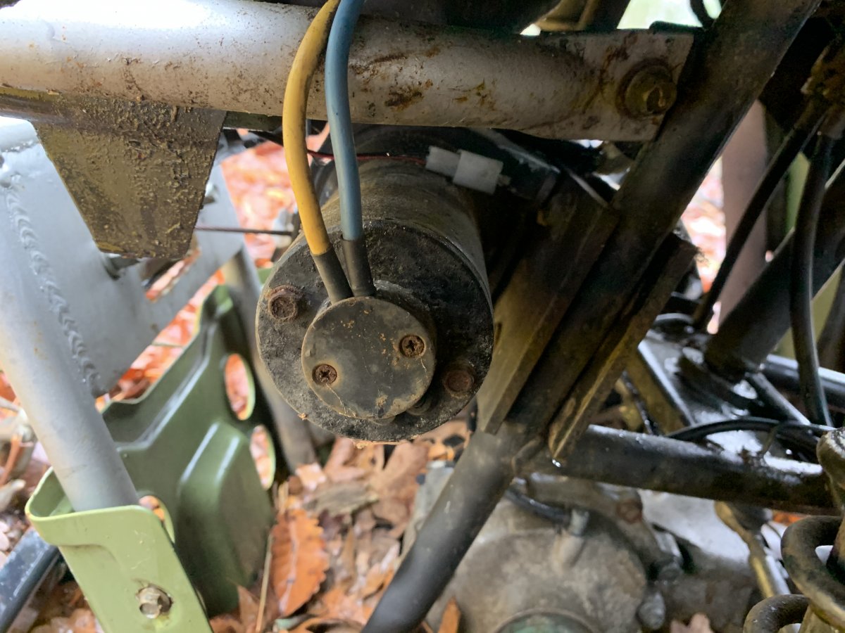

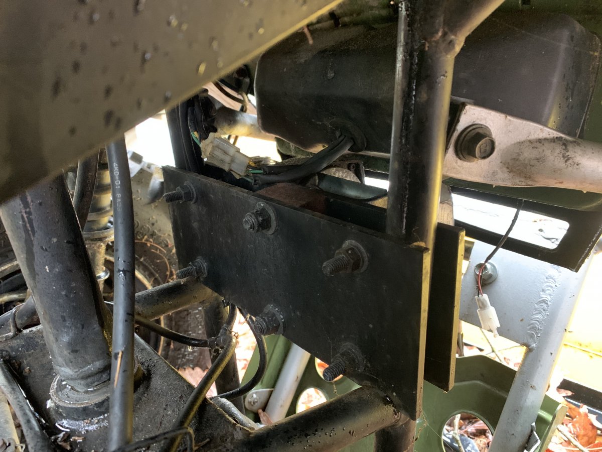

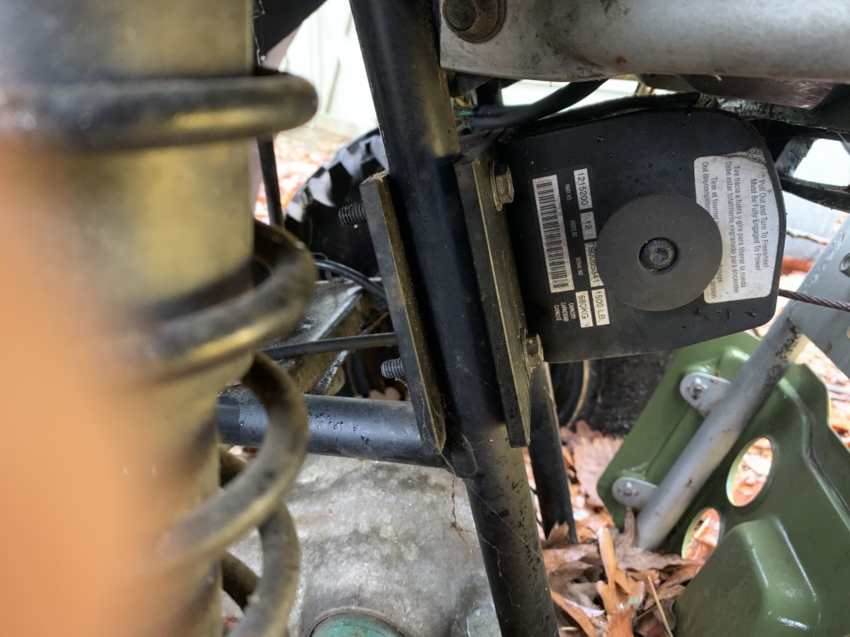

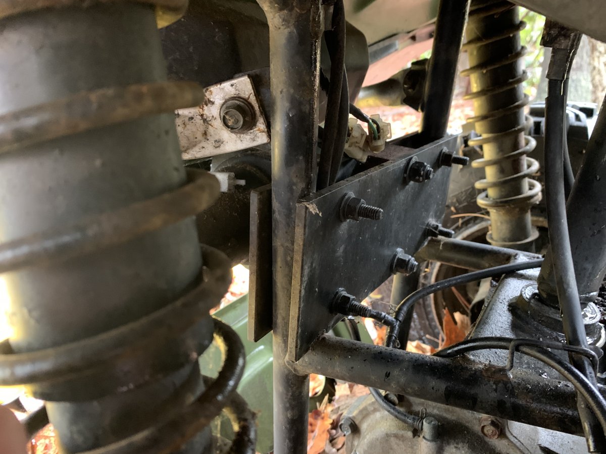

Then I made 2 plates and a spacer to clamp the winch to the frame behind the push bar.
37005
37006
37007
37008
37009
I like that idea. I had a similar idea but wasn't as heavy duty as your idea. I was worried about how much stress that part of the frame could handle. My quad is only 400 (600 with me on it) but first hand experience is best. Does your winch have a wireless remote or did you mount a switch somewhere?
The frame is strong enough there. It has the 2 bars the run back right under the mount, it’s not just in the middle of unsupported tubes.

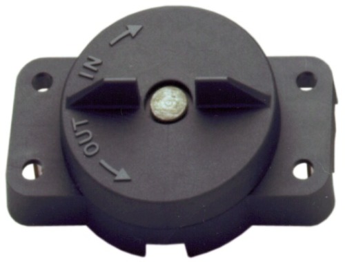

I have a big, old school rotary switch (see pic below) mounted on the left side. I’ll get you a pic tomorrow, I’m at work until midnight.
