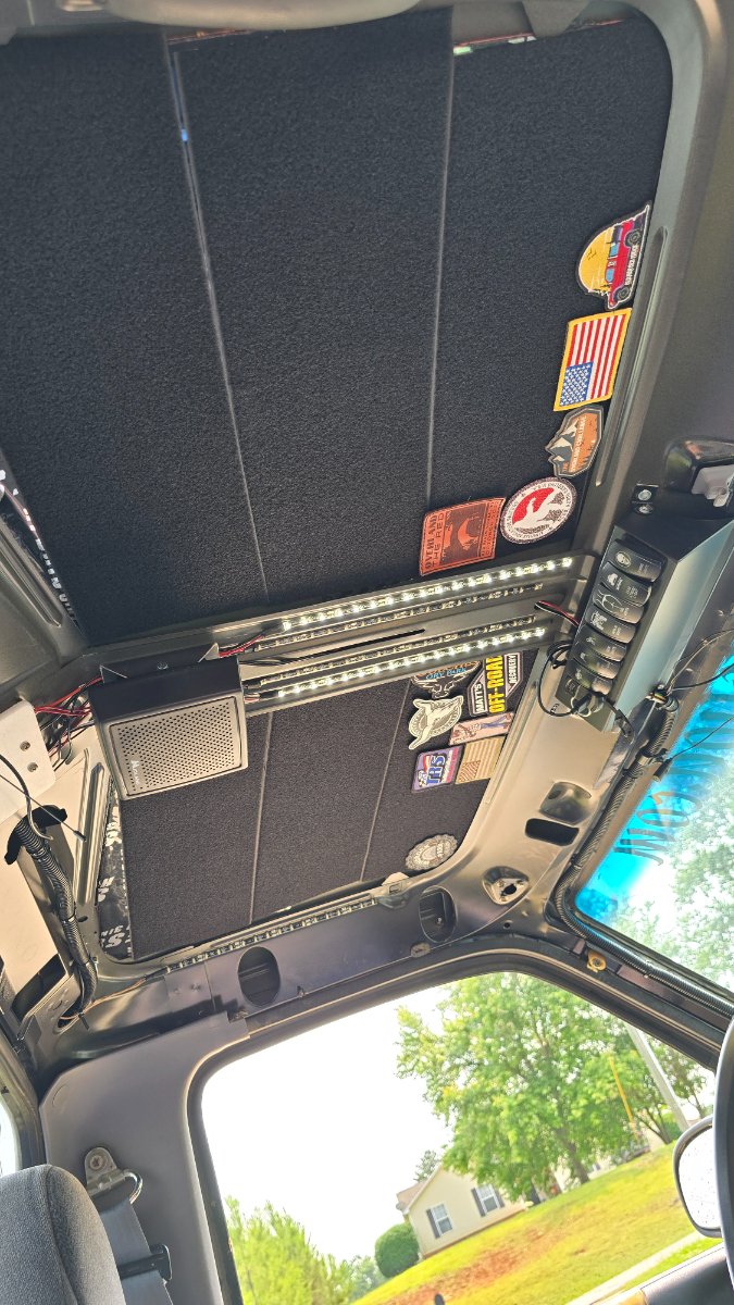

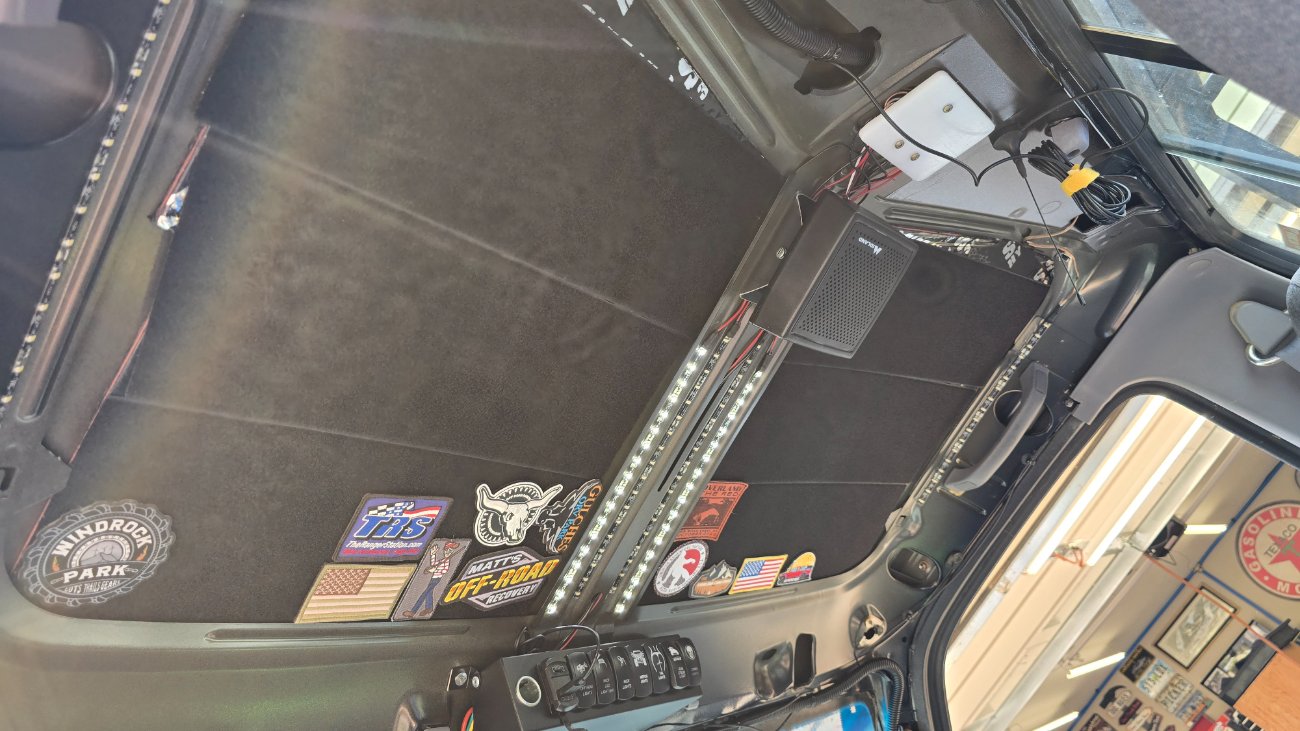

Recently, pulled it out completely. Covered the flat areas with sound mat and velcro loop material.

Velcro...I like that. Another way to show your stuff and stick things outta the way. My headliner is in pretty good shape, but strategically located strips might come in handy.

The "board" itself is good. I was thinking similar....ly.
I got my headliner at the local U-pull. $35 in like-new condition.
no trouble removing it? I have some good yards around.
Not at all - mines an 05 extra cab so I don't know what the differences might be, but I'm guessing not much. Philips to remove sun visors, small socket (like 6mm or so) to remove the grab handles, the trim just pops out, with maybe a couple of those plastic push fasteners in the back corners. Oh, and dome light, Philips also IIRC.
I'm thinking the 2 door is probably even easier. The second time you do it it's a 10 minute job. 😆

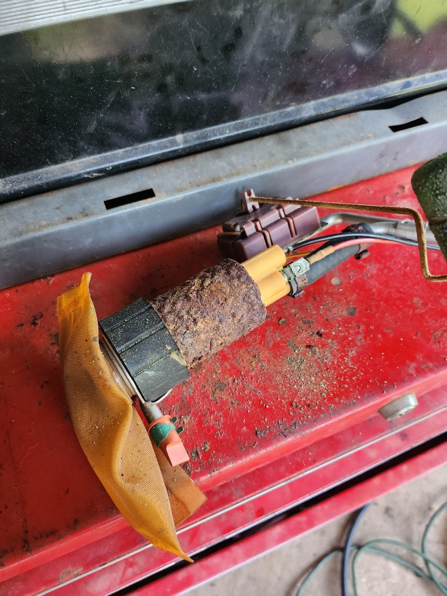

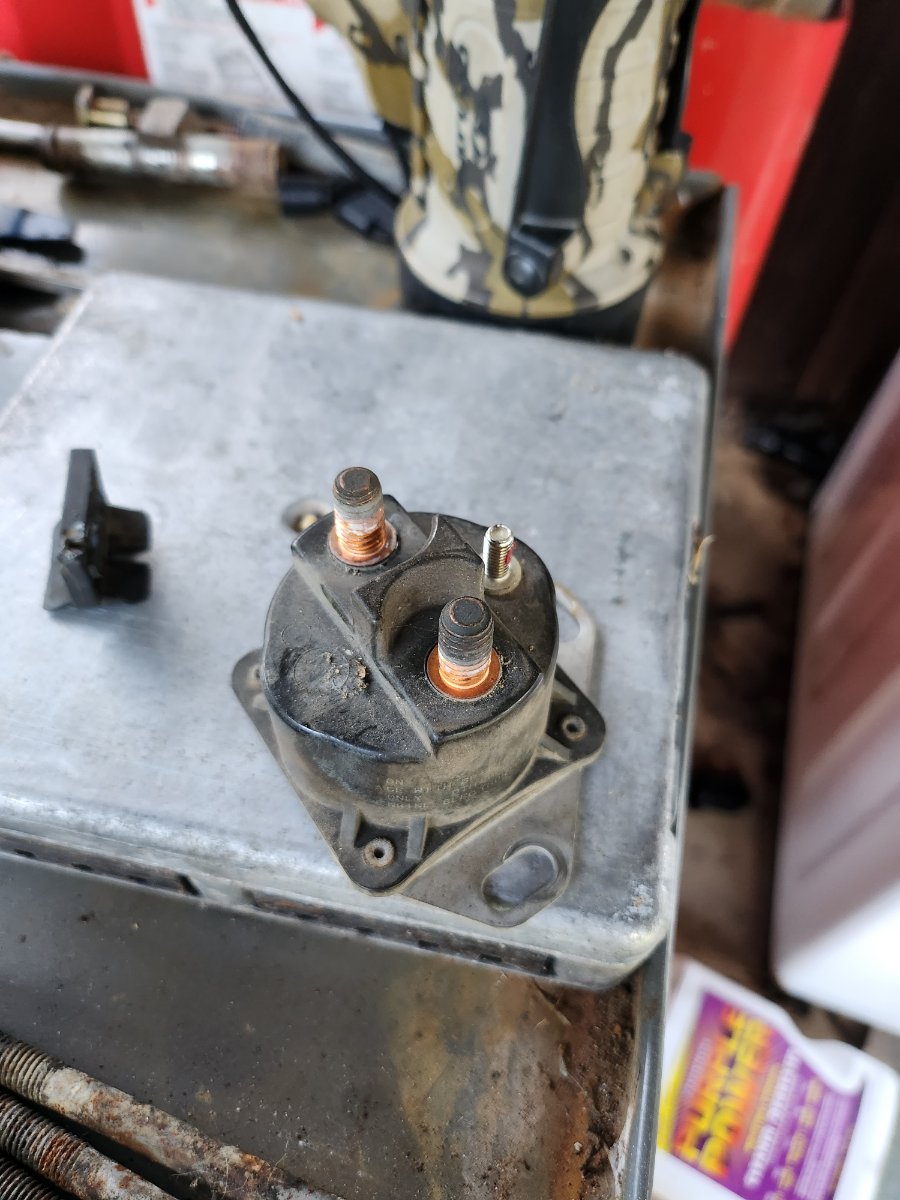

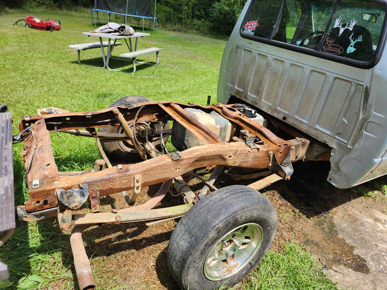

A few things that I knew were gonna be bad. So far ...pump of course. Tank was surprisingly clean. Starter relay trash. That frame rust...I see it's common for these years. Man it's hot in Arkansas..
>frame rust
You dont know what I wouldn't give to have my 1988's frame look that good.
That's about what my frame looks like. It's never been registered more than 80 miles from here.

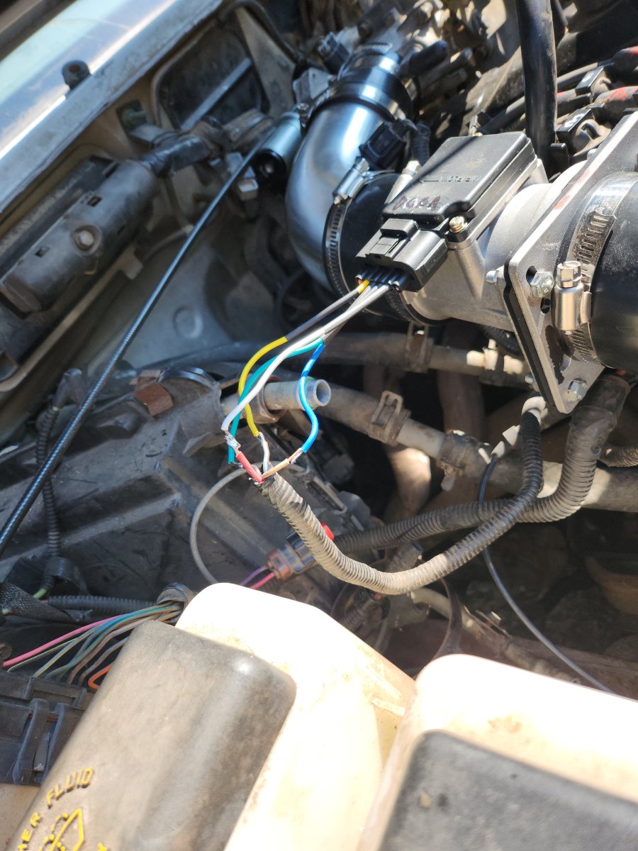

I do have a pic to post. This is the correct pinout for this MAF conversion.
Arkansas ranger owner.
It's a-b-c-d right to left. Red, power black ground, White/blue strip, not sure and blue/red stripe, that's the signal wire.
I initially had it 180.

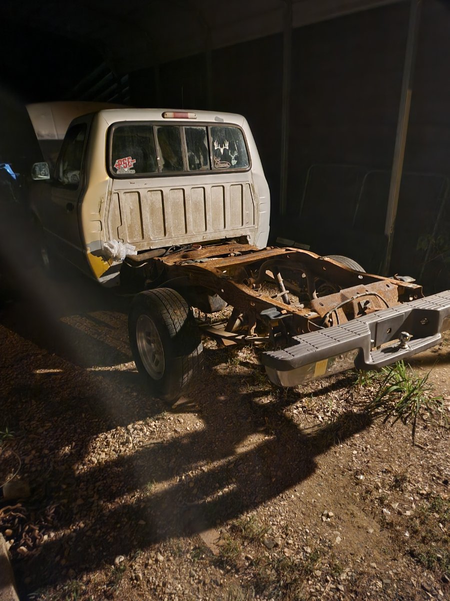

Permanent account ban on u tube. I can't tolerate a platform that allows terrorist to post indoctrination content. I spent 5 years in that war. Anyway. I'll figure it out. Got to drive it around the house and put it in the project area under roof since it's looking promising.
