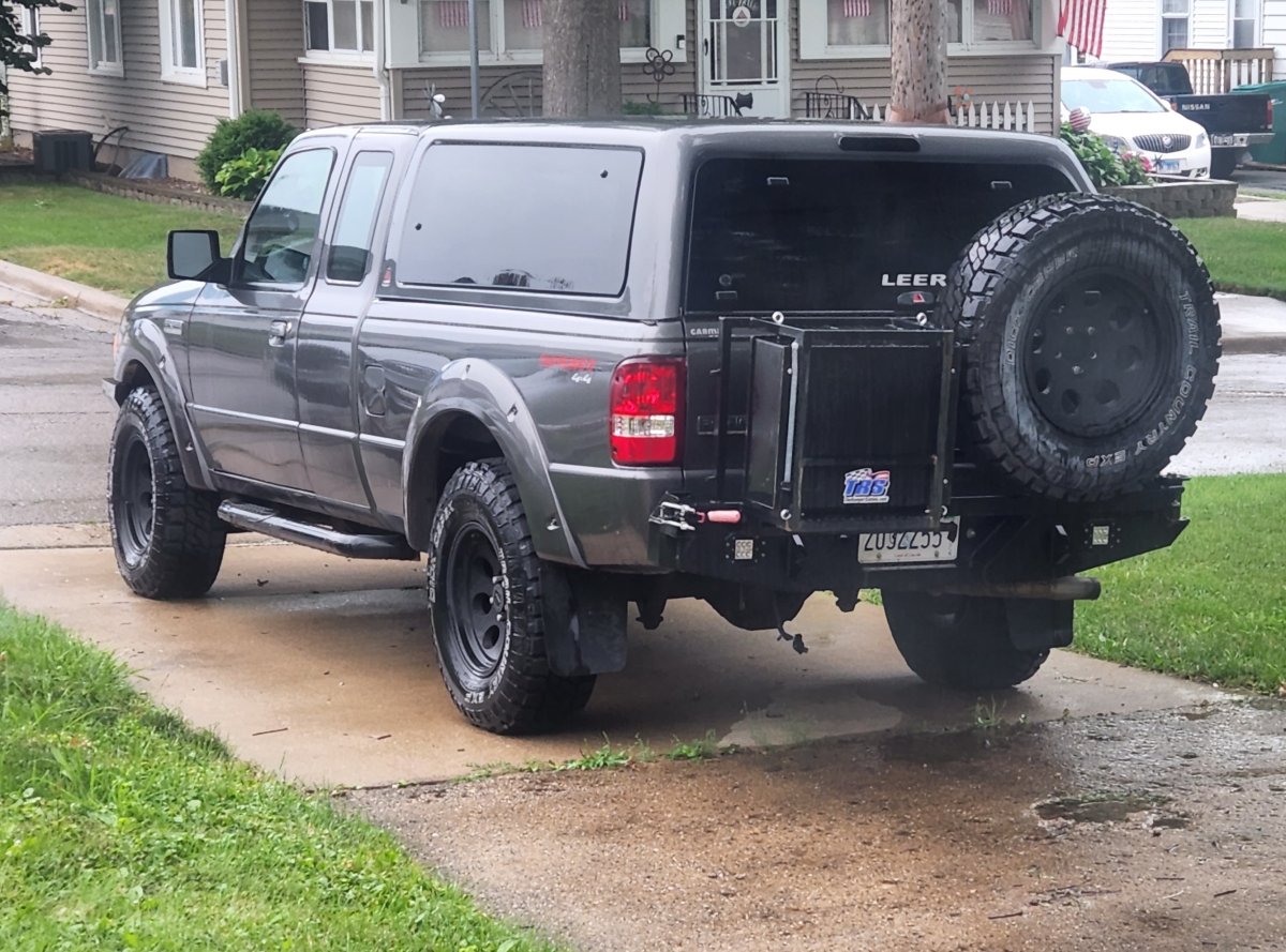

I'm kidding of course. But I did consider adding Spacers on the rear to make the track width the same front vs rear. The pair I settled on was north of a $100.
I also think "rugged looking" is in the eye of the beholder. I see a Ranger with stock wheels and a 4 inch wider track width... I see a Ranger sporting $100 worth of wheel spacers... not rugged.
