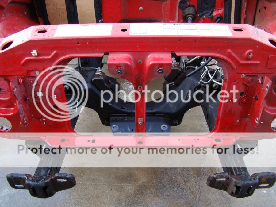

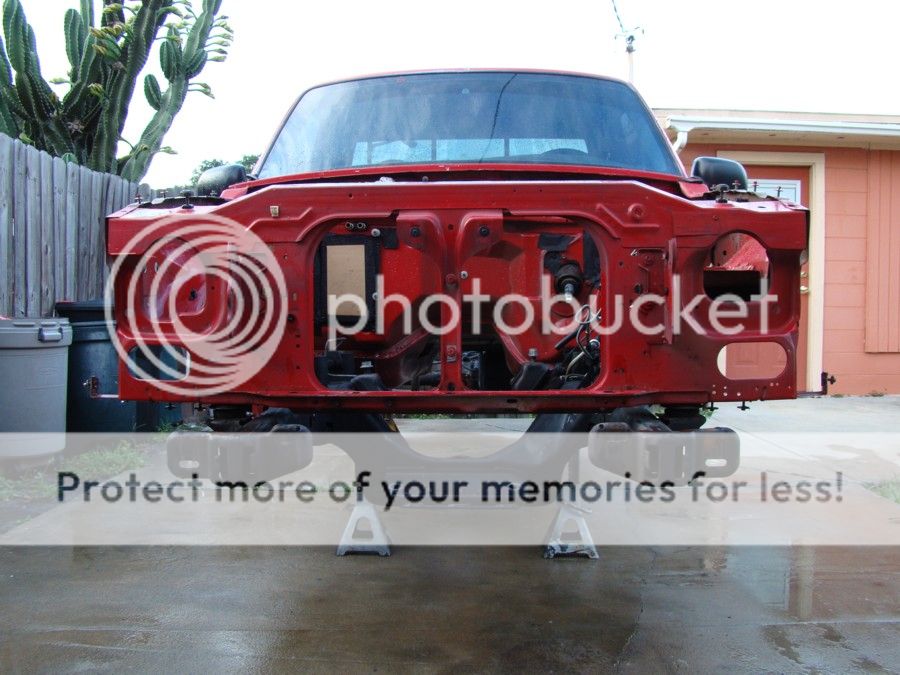

Ok, now for the next question. How much does the cab weigh. Full interior minus seats? Nothing at all in the engine compartment. No fenders, bumper, header panel, etc.
Heh heh I stabbed my first 3 speed transmission with it on my chest at 18.42 yrs later, I have a bad arm and that is the good one. My backs not too sharp either. When I installed the 5spd in the Rat I used a milk crate and scraps of wood. I rocked the the trans front to back, adding wood as I rocked. Using different thicknesses of wood, I was able to regulate things fairly well. The tranny slid home with no drama. Puttering along, setting the lift up took me a morning. With the trans on, the transfer case was nothing.
You might want 6 or 10 guys for that.
It is generally accepted that a full BII shell can be lifted with two engine hoists and two large tow straps, and that has to weigh more than a bare Ranger cab.
I'm betting the cab is still in the range of +200 lbs.
Cab is considerably more than 200 lbs. I would say my extended cab with front clip and seats removed hit in between 7 & 800 Lbs. (Maybe more...It's most of the truck) That's judging by the amount of effort I had to use on the chain hoist to lift it. You also need to be able to lift it high enough to roll the chassis out from under it.
If you have the front clip removed subtract maybe 150-200 Lbs overall. Core support and sheet metal are not that heavy.
Hint: Don't use a crappy Chinese come along if you plan to lift the cab. Get a real hoist.
Thanks for the info. That is about what I thought for the cab. I plan to block the cab around 30 inches off the ground and drop the frame out the bottom.
