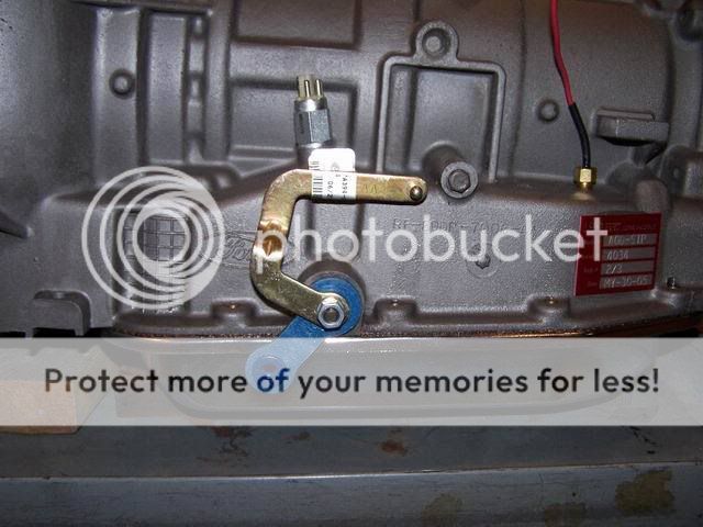

Still kinda stumped if it's a aod or aode I found a plug I isn't see before it has like a 7 wire plug that fits into the top of trans pan is it the aode?
simple, if it has 2 levers 1 for the shifter, the other for a TV cable its a AOD, if it has 1 lever and usually a black box behind that 1 lever(used for the shifter) its an AODE
AOD, (if its thats plugs, its the neutral safety switch and a A4LD is a direct plug for it)
4R70w(similar to AODE, but wired different)
driver side of the tranny

soo from that plug and the linkage this must be a aod-e??:sad:
e4od ok i need to do a little research on trannys... is this thing anygood? and or is it computer controlled? thanks a lot bruce!
It is computer controlled 100%. This tranny is used from a F150 all the way up to F350 Diesel and 460 depending on bellhousing and internals...Diesel bellhousing is differant than the big block and then there is a small block bell also. Its sort of a C6 with overdrive and its the biggest tranny of the Ford brand.
