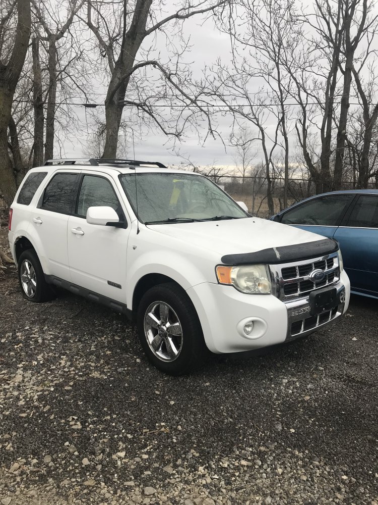

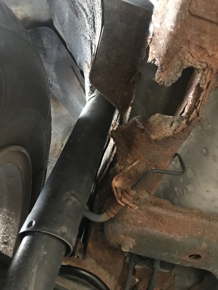

Heres one other one I was looking at, bad rust in unibody framerail at drivers side rear axle. Miles and price aint bad but the underneath sure is. Outer body and tailgate seem to be fine. Not sure what state its spent most of its life in but its seen some salt for sure! My ‘11 came out of new york originally and has some rust but not to this degree.

holy cow, I don't envy you guys... I would be surprised if there's even any surface rust on the one my brother got for the same price... It's wet in Oregon but what they put on the roads doesn't seem to hurt anything...

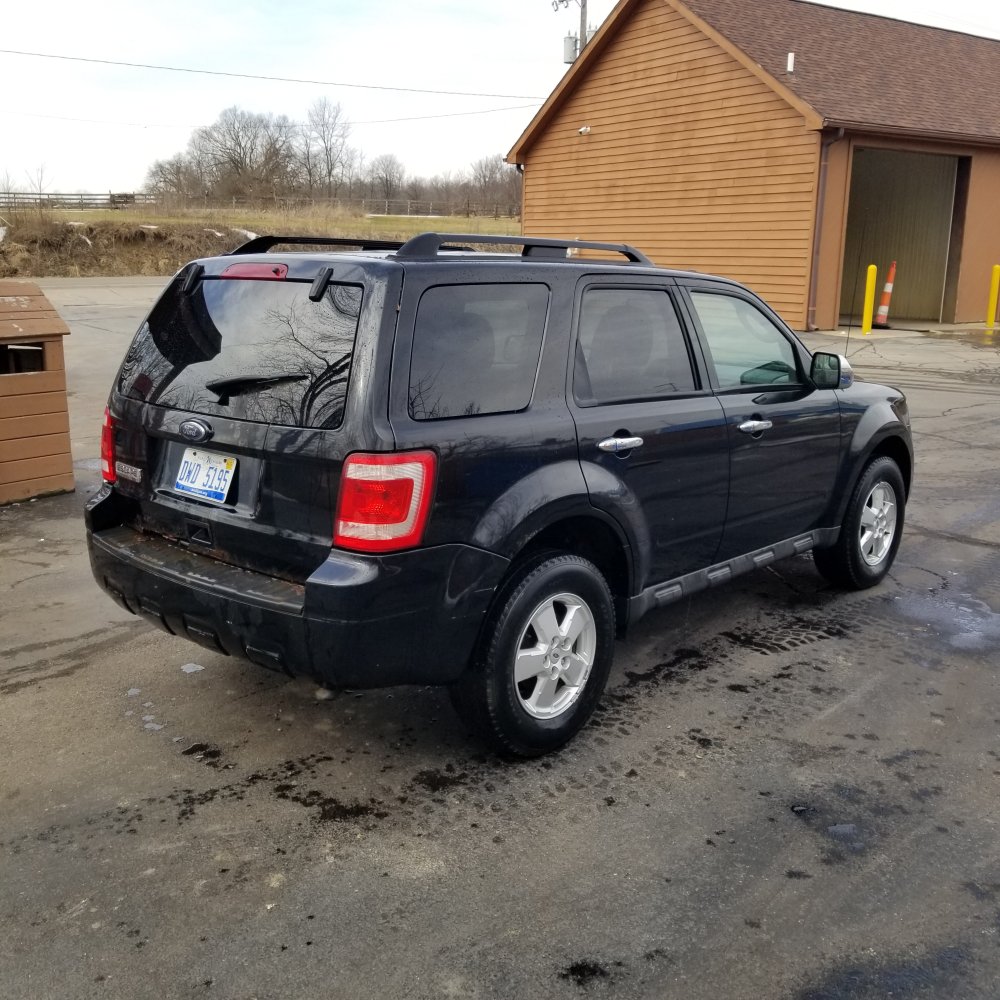

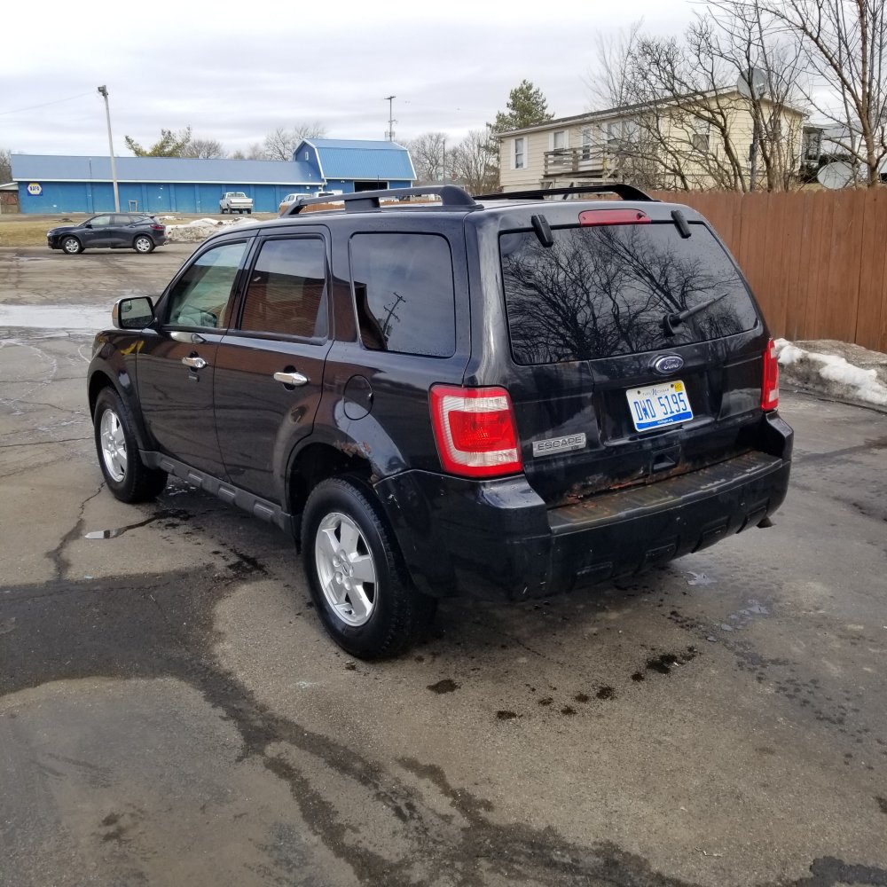

this was my wifes. You can see the rust got it pretty good

The rust on @rusty ol ranger 's Escape is minor compared to what is on her's. For some reason, the '08-12 were terrible for rust over rear arches/tailgate. The older '01-07 seems to do much better.
