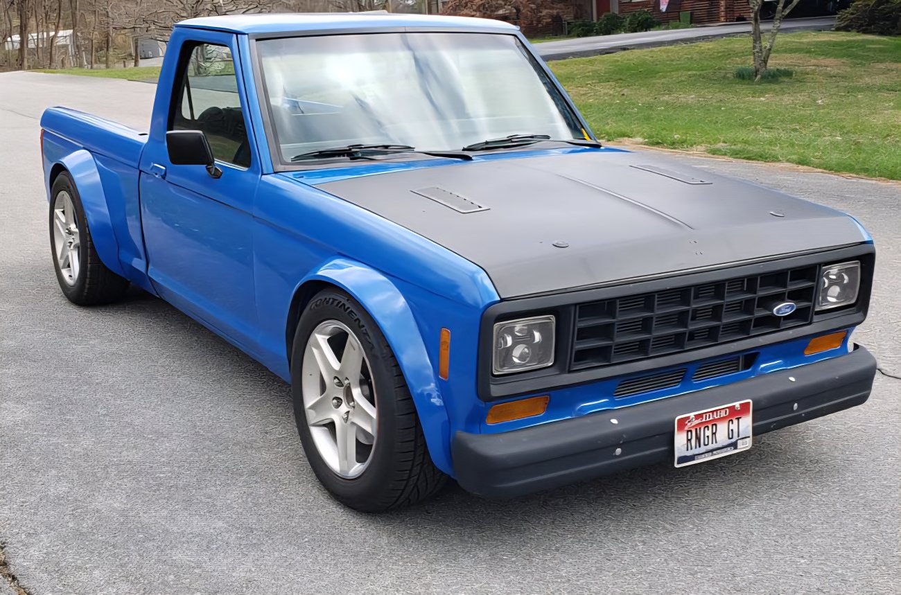

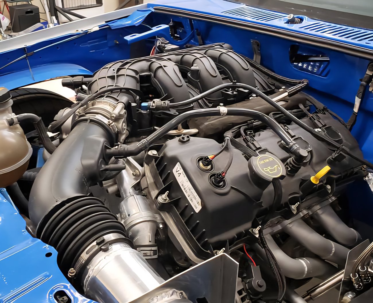

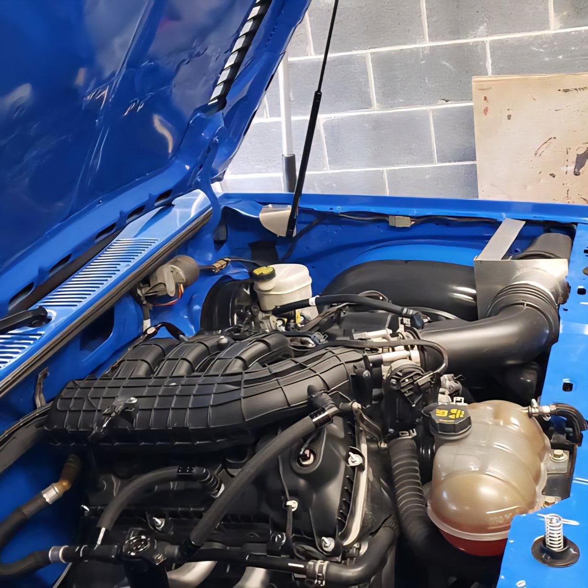

At first I thought that fit better than I would've thought. Then I noticed the complete lack of a heater box. Wonder if they just avoid rain or have some other method to keep the window clear?
What would you rather have, heat or horsepower?
Go look at the truck again... it is either a race truck or a show truck.
I don't know if it is a lack of room so much as reducing weight/cleaning up the engine bay.
