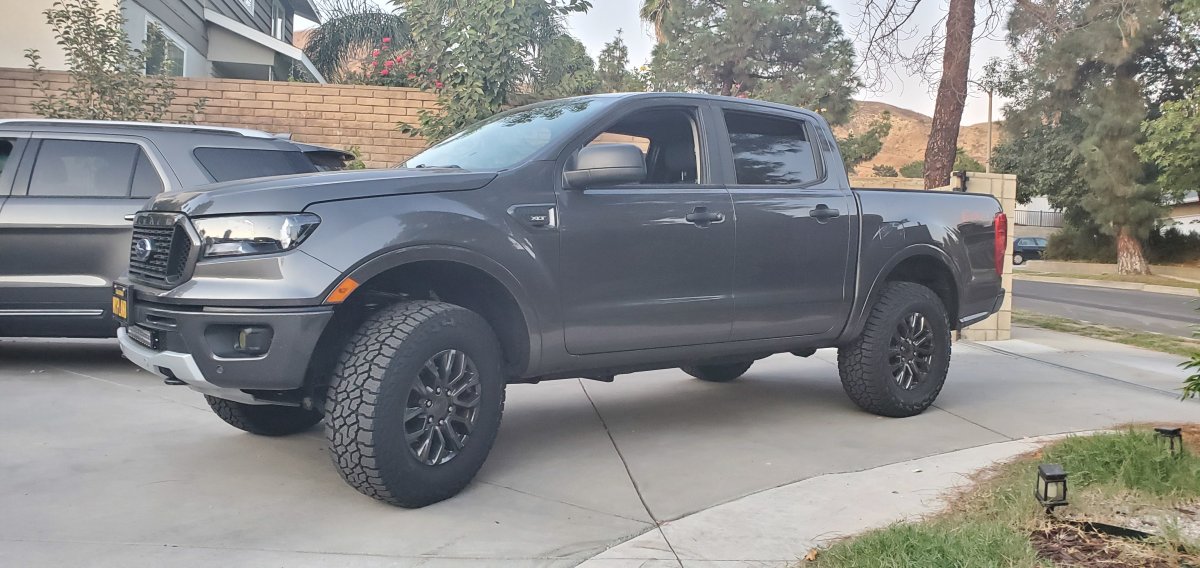

Installed over the weekend. ;)
SVC leveling collars
285/70/17 Falken Wildpeak AT3W
Looks awesome.. Does that work on a 2wd as well? I'd actually prefer to lower the rear an inch or 2
