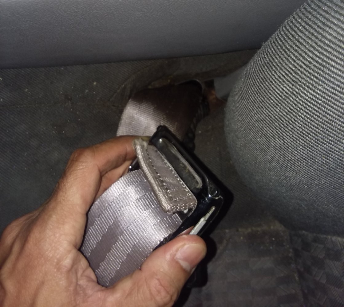

Okay just for reference you need a T55 AND a t45 or close to get the bolts that mount the waist seat belt out for the driver's seat as it's smooshed through it. I'm gonna try to 'smoosh' the belt out of the buckle I guess if I wanna get this done by tomorrow morning.
Good luck with that since the reason it is folded over and sewed is to keep it from coming off. You could pull the threads with a thread ripper and unfold it. To attach it again a thimble and heavy sewing needle. Total cost for every thing should be under $20. As a temporary fix till you can get the items needed use tape to keep the fabric from unraveling.
You can get a sewing awl like what is used for leather
