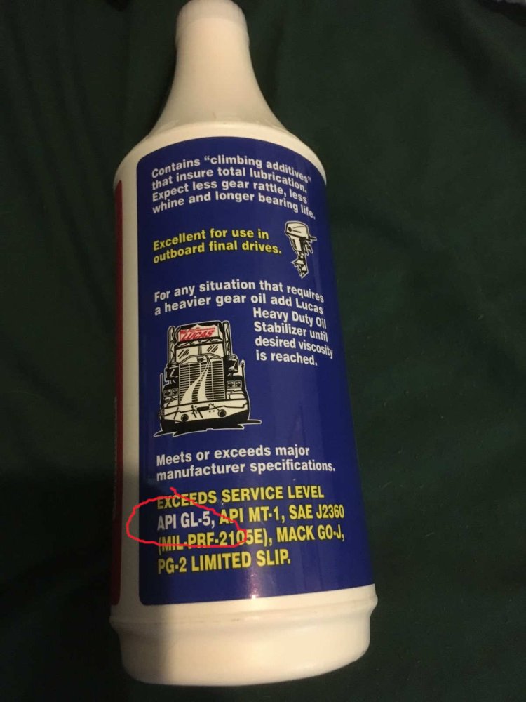

I ordered a couple quarts of gear oil for my old datsun transmission (brass synchros) from rock auto- their website pic claims to be GL-4 and GL-5 compatible. However, what I received only says GL-5, otherwise it's the same label.
I called Lucas and got the most confusing answer possible. They said "We've changed the formulation and the label. It used to say GL-4 but it wasn't yellow metal safe. Now it's GL-5 only but our technicians say it's definitely yellow metal safe now. However, I can't advise you try it in your transmission"
Super fishy. Why would you _remove_ the GL-4 from the label if you specifically went out of your way to make it yellow metal safe? Even Lucas doesn't seem to understand the difference. I'm now leaning towards not even trying this stuff but I'm curious if anyone has any good, solid insider info about this situation.

Seriously, I'd be hesitant on using anything that didn't state 'safe for yellow metal' on the label, or in a printed spec from the company.

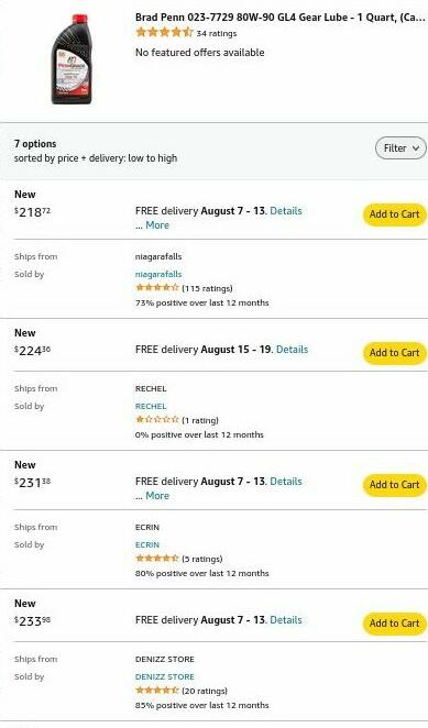

I can't really speak with authority on how Amazon does whatever it is they do, but it seems at least that anything that might be a "chemical" they just avoid dealing with. Very large amounts of products you can get in the USA on Amazon aren't available here. Another example, on Prime day a week or 2 ago, they had a great deal on the Topdon TopScan dongle... unobtanium in Canada, not even through 3rd parties.
If I try to add your suggested item to my cart, I get several options which are all third party sellers charging... ahem... "fair" prices.
EDIT: so I guess to be fair, some products are actually unavailable, in this case it may technically be available at 3-4x the price. But I also don't buy from 3rd party sellers on Amazon, especially cross-border, for a whole other set of headaches. Seller 2 there has a 0% positive feedback. :LOL:
