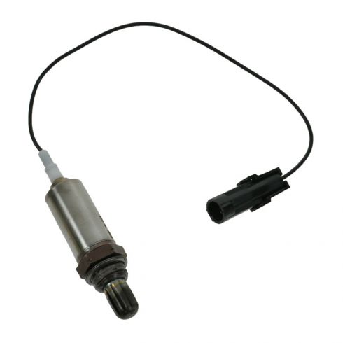

Also found another plug that was burnt against the exhaust manifold. Took car of both not sure what the random plug is for yet
Is your O2 sensor(s) hooked up? I know on my other friend's old Buick Century it was the most random looking single wire just hanging off the firewall. When I asked what the hell it was, he said O2 sensor. Google shows that 82+ Camaros at least had a single lead O2 sensor, and since you said it was by the manifold, might be that. Was the plug still intact or was it just a burned off wire when you found it, because the plug end might help determine what it was for.
I'm not trying to sound like I'm pulling stuff out of my ass, I'm just trying to help on something I'm not terribly knowledgeable about :dunno:
The O2 Sensor is plugged in, As for function I do not know. I have not made it to that point. Today I will be going to the county fair so I wont be doing to much work on it.
