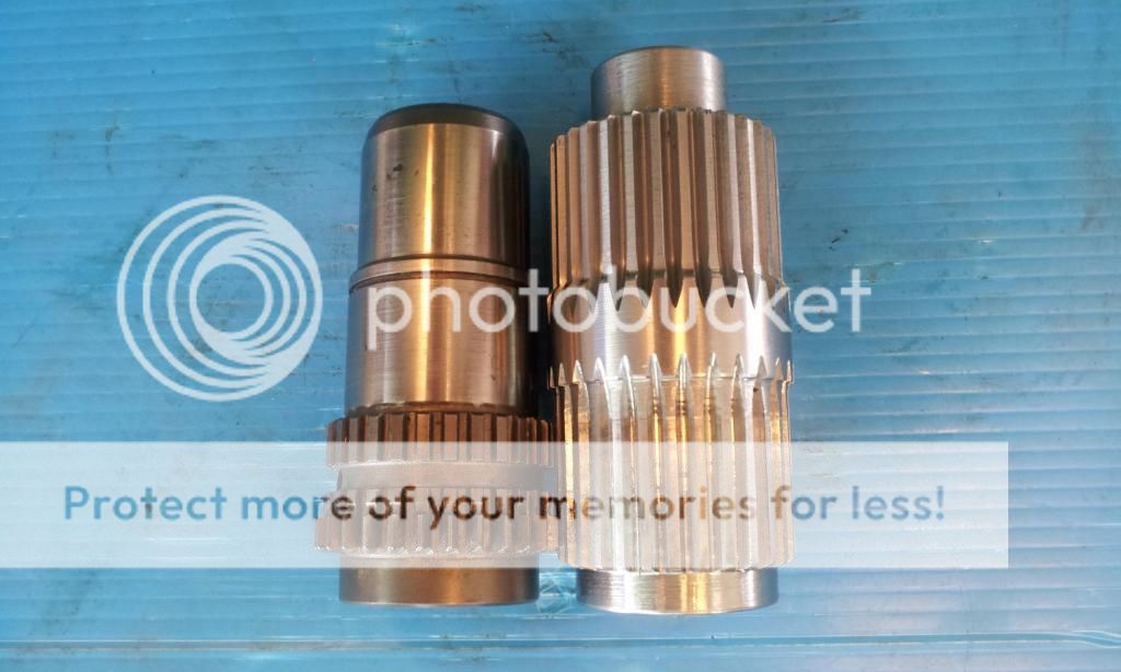

Prototype 1354 shaft came back from heat treat a couple days ago and looks great.

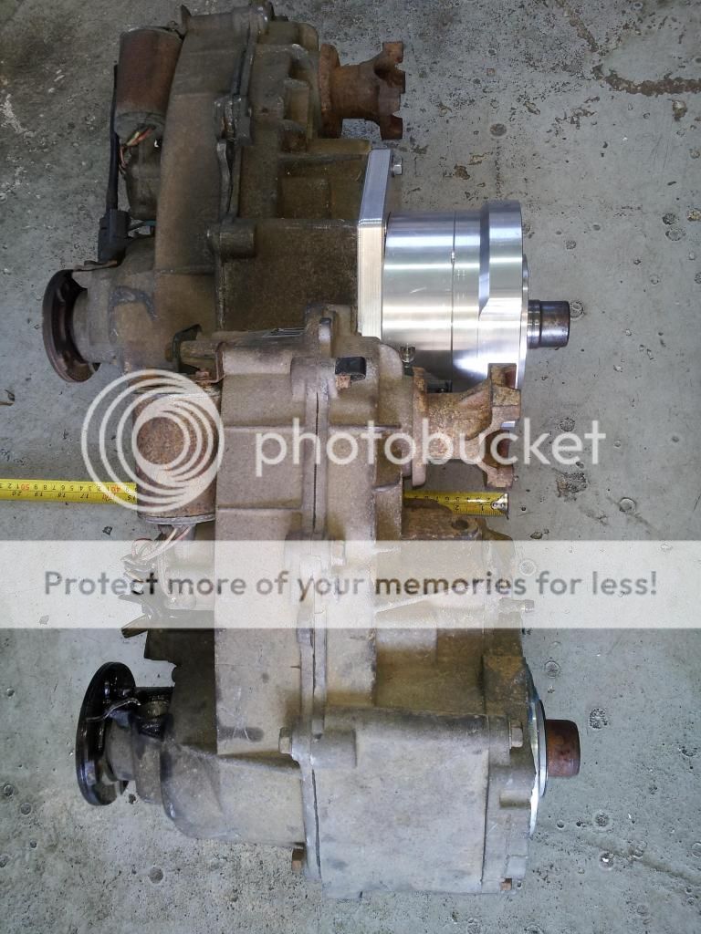

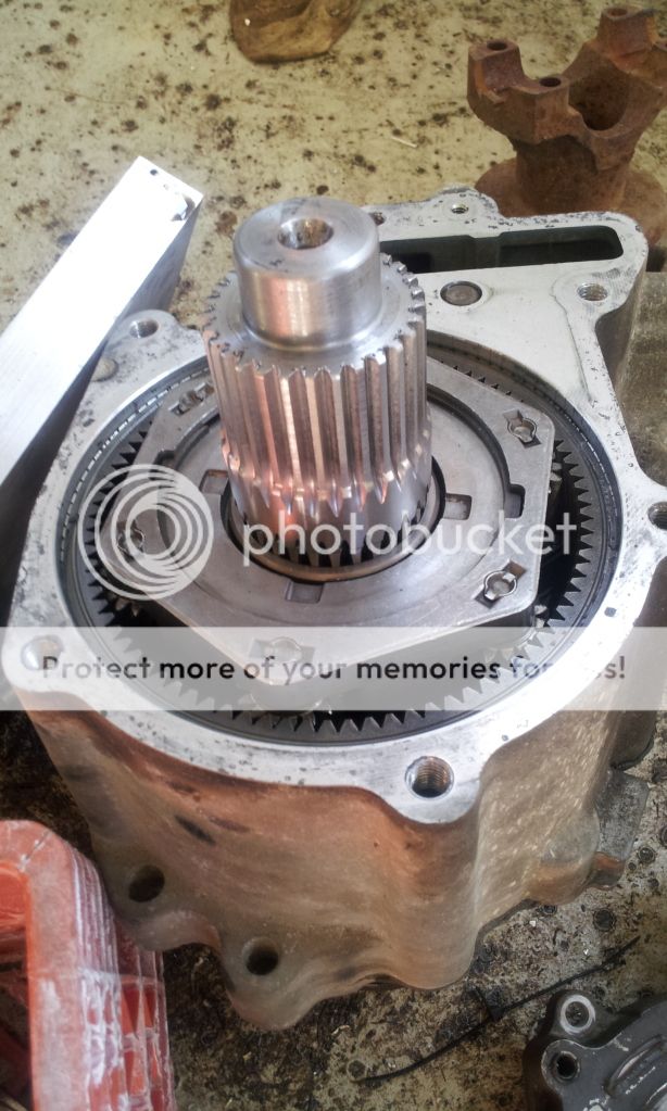

Here are a few pics of the 1354 shorty kit. 17" total length.
intermediate shaft actually replaces the input shaft of the rear case for a shorter and much stronger union.
