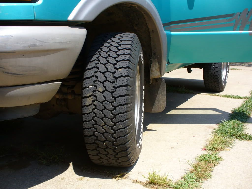

These tires came on my Ranger when I bought it (235/75 R15).
They have good tread and aren't dry at all but my right front tire shakes like crazy between 60 and 65. It's bad enough that I'm sure people driving next to me can see it.
I need to replace it but haven't been able to locate this brand locally. I did find some online from Hercules Tire in Canada but they are pricey there.
Does anyone know anything about them?

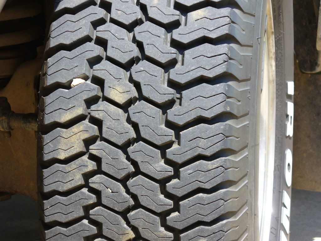

can I see the tread on the tire? they look familiar

I've seen those, they are not the most common tires available, as common as my Roughnecks are.
Check on the inside of the tire, there should be company names on opposite sides.
Nice tread pattern though.
