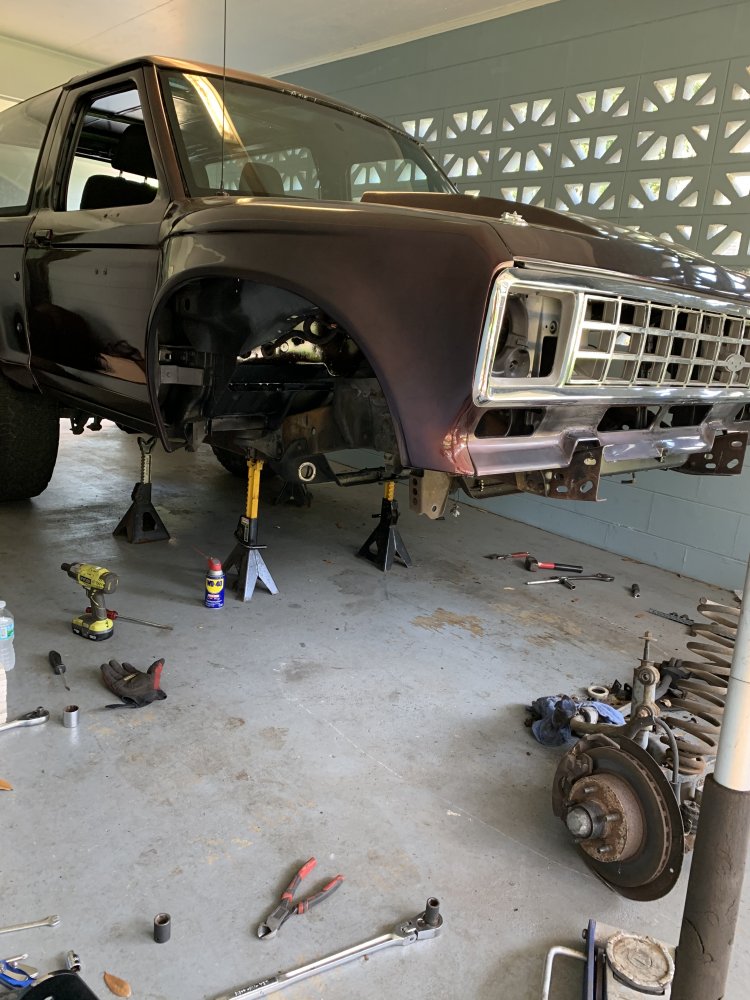

Life got in the way, parents passing and got married twice had kids etc. I’ve never felt with the 2.8l and it’s smog pump garbage. Also the ac system is really weird. I’ll have to get pictures of it. It runs/drives great no rattles or anything. I’m gonna have to rebuild the carb and bleed the brake system. Other than that it’s in horrible shape other than the firewall being rotted at the brake booster. Here’s what I’m working with.

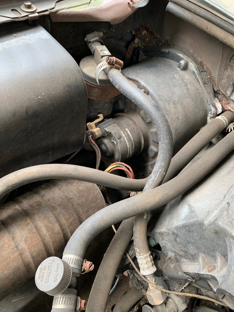

Here is the ac line coming out of the hp port on the evap core going to a filter? Or something and into the fenderwell. I have some fiberglass fenders to put on it later so I will trace it to wherever it goes.

That's an aftermarket accumulator / drier stuck by the fan (sight glass, push-on hoses).
The air box looks stock (missing upper low pressure hose in the earlier pic?), but if so you have aftermarket parts mixed in. Looks like maybe the original drier and orifice tube was replaced with the aftermarket drier and an expansion valve in place of the orifice.
Or, it could be all aftermarket (the box is throwing me), but more pics would be needed.
Box doesn’t look factory from what little I can see.

It is stock, the low pressure hose was cut off flush
Yeah, I can kinda see it now on my computer. It has had some work done on it.
