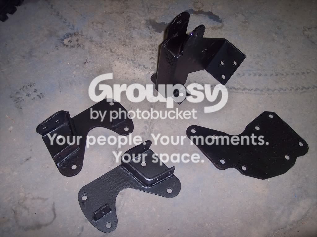

anybody know what lift this is?

I brought it of another ranger frame for 200 bucks and now just getting ready to put on i am wondering who makes it also if thats the bad drop plate that hits the diff if someone could help me out that would be great its a 4in by the way sorry for the huge pic

found it out its a bds and looks to be the bad drop plate is there anything to fix this problem? can i just buy a newer drop bracket off of skyjacker or someone that has redone the plate? really need a input here guys seems like i post stuff and never get a reply :annoyed:
This kit is from Rought Country. You will need front coil for that lift.
Go on ebay and you will see the lift kit and it is the same. Good luck
You can clearance the drop plate and add an extended bump stop so that the drop plate cannot contact the diff on compression.
While I can't tell you what it IS....I can tell you it is NOT a BDS.....
Looks absolutely identical to the SuperLift I used to have.
You can clearance the drop plate, but I'd look for a bracket if you plan to wheel it.
so i can just get diffrent bracket instead of buying whole new kit then ill start looking after silver lake ill just take it easy hopefully it will be fine till i get back
