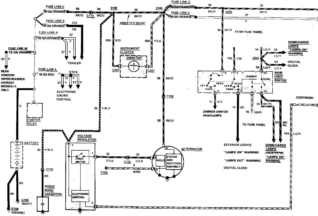

1st thing to check; When you turn the key to run, but do not start the truck, do you have 12v on the lightgreen/red wire? This wire should go to the "S" terminal of the regulator. This wire is what brings the alternator system "online" to charge.

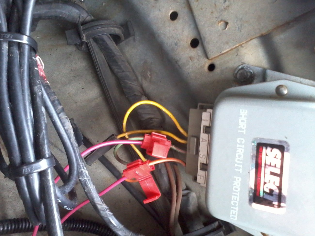

my wiring is a bit different from your diagram. i have a ground from alt to the base of the regulator. and two new wires that are "jumped connected" to the existing wires that go to field and S on the regulator. The bat connection goes directly to the battery. nothing to I. hope that helps
If you have a connection from the "S" of the regulator to the "S" of the alternator, take that wire off. It does not belong there. In this configuration, there is no connection to the "S" terminal of the alternator unless you are running a electric choke. Only connection to the regulator "S" is the one from the ignition.

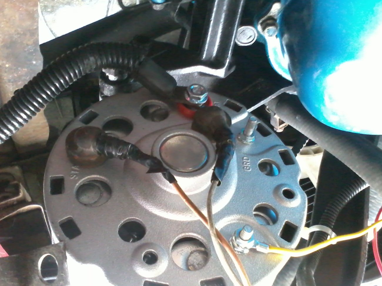

not sure if i did these tests correct as the results are all over the place.
the F wire test had the volts climbing, stopped at 17.5.
A had 12+ volts engine off key off....
now wasnt sure if the A and F were correct hooked up so did both terminals and switched them. first time both A & F showed 0.0 volts .... switched the two on alt A & F ... got A 0.0 and F hit 3.5 Volts

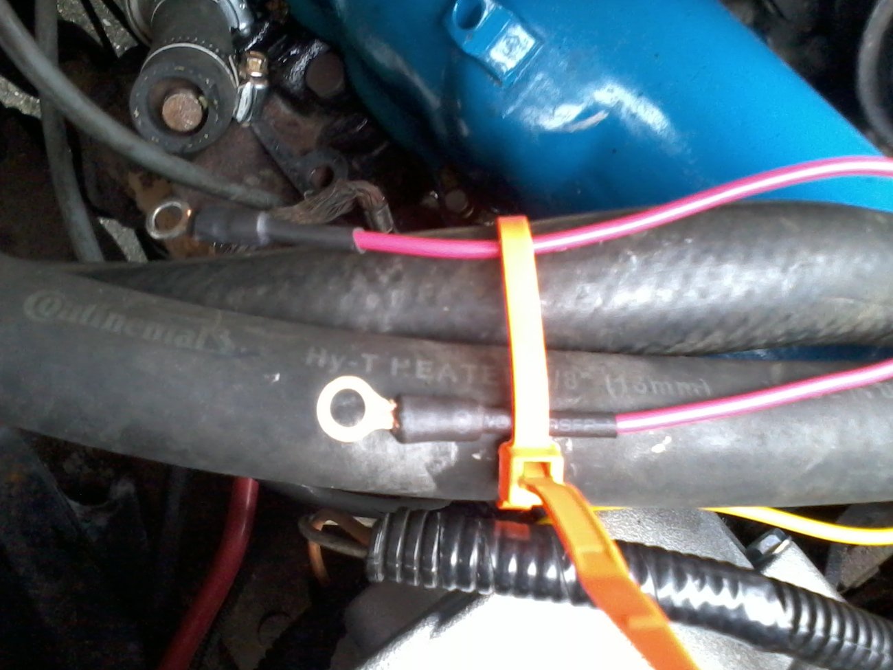

pics are showing the hook ups. cheers

F wire being at 17.5 volts means the regulator was online, and telling the alternator to put out some power.
You did not do the output wire test on the alternator (I didn't see it if you did). With the engine off, key off, take your meter and read the voltage on the large stud on the alternator. It should be battery voltage. If not, there is usually a fusible link in that wire that burns out.
If the alternator output wire tests good, and you get it running again and you have 17v or whatever voltage on the F wire, then you should have something more than 12v on the battery with the engine running. Some of these older systems will put out about 13.5v-13.8 v. Most of the newer systems put out around 14-14.5v. With voltage on the F terminal, and it's hooked to the F terminal of the alternator, if you do not have the higher voltage on the battery the alternator is bad.
the big output terminal is hooked directly to the battery and is a solid 13 Volts key off not running. is that wrong to hook there>? as there seems to be no other place to run a wire to or from ... wasnt any before and was just hooked to the battery
It's supposed to be run across the engine and tied into the harness on the driver's side.
That might affect some things being powered in the truck, but that should not affect the battery charging the way you have it hooked up.
You said you had voltage on the F wire, so no rise in voltage at the battery, the alternator is bad. 13v is a little high for a battery at rest, but you must have had it on a battery charger or your meter is a little different. Whatever it is at rest, it should be higher with the engine running and the alternator charging.

oh, where does that S wire go to that leaves the page on the diagram you posted?
That s wire from the regulator goes to the keyswitch. This is what tells the regulator to come online and get ready to charge when you turn the key to start and run. If this wire stayed hot all the time it would drain your battery.
