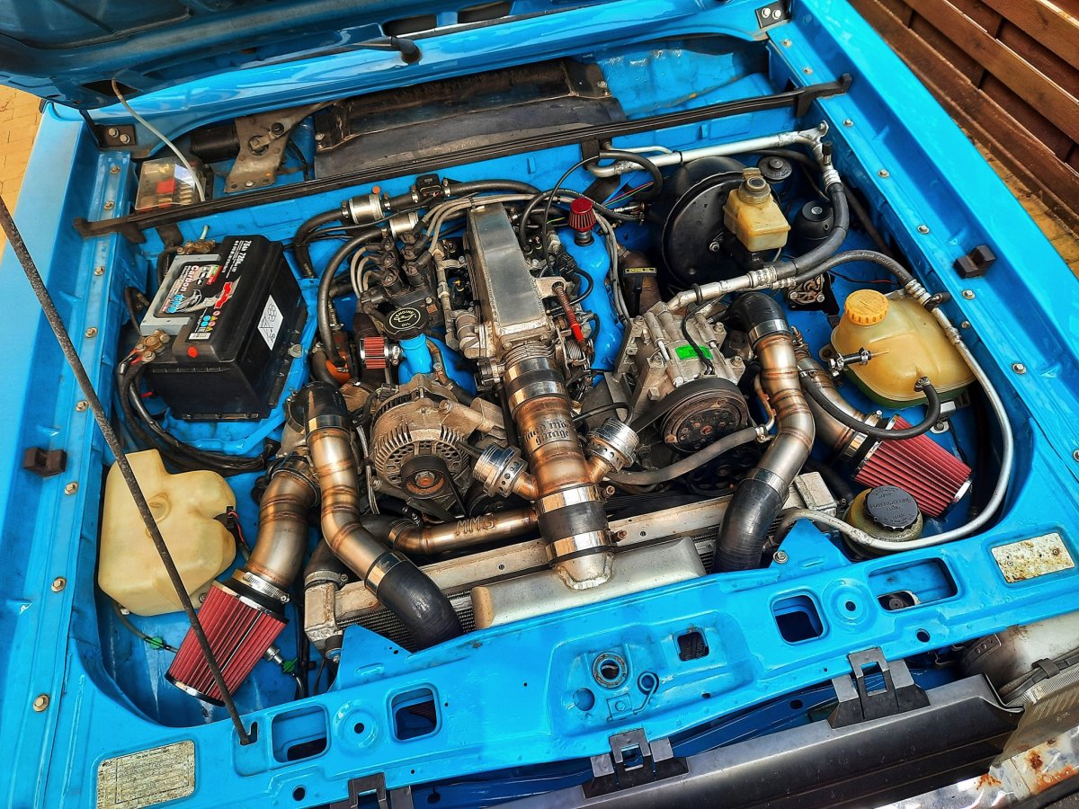

Check my current thread 2.9L w/ MegaSquirt to 4.0L w/ Ecumaster Black and a Turbo build
maybe it will inspire you. Neither cheap nor a quick way to get more power, but theory and other builds confirm you can get 2-3x more power than stock with stock crank, con rods and pistons. Unfortunately I need to start with a full engine rebuild, and then seek for the horses :D

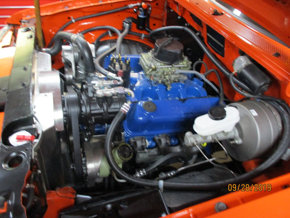

I am curious abut the intake pictured in the above pictures? Is it modified from a stock. I like the low profile, compared to the factory one on my 4.0 OHV V6.
It may be an answer for a replacement for my stock one.
I expect it's a custom modified intake.

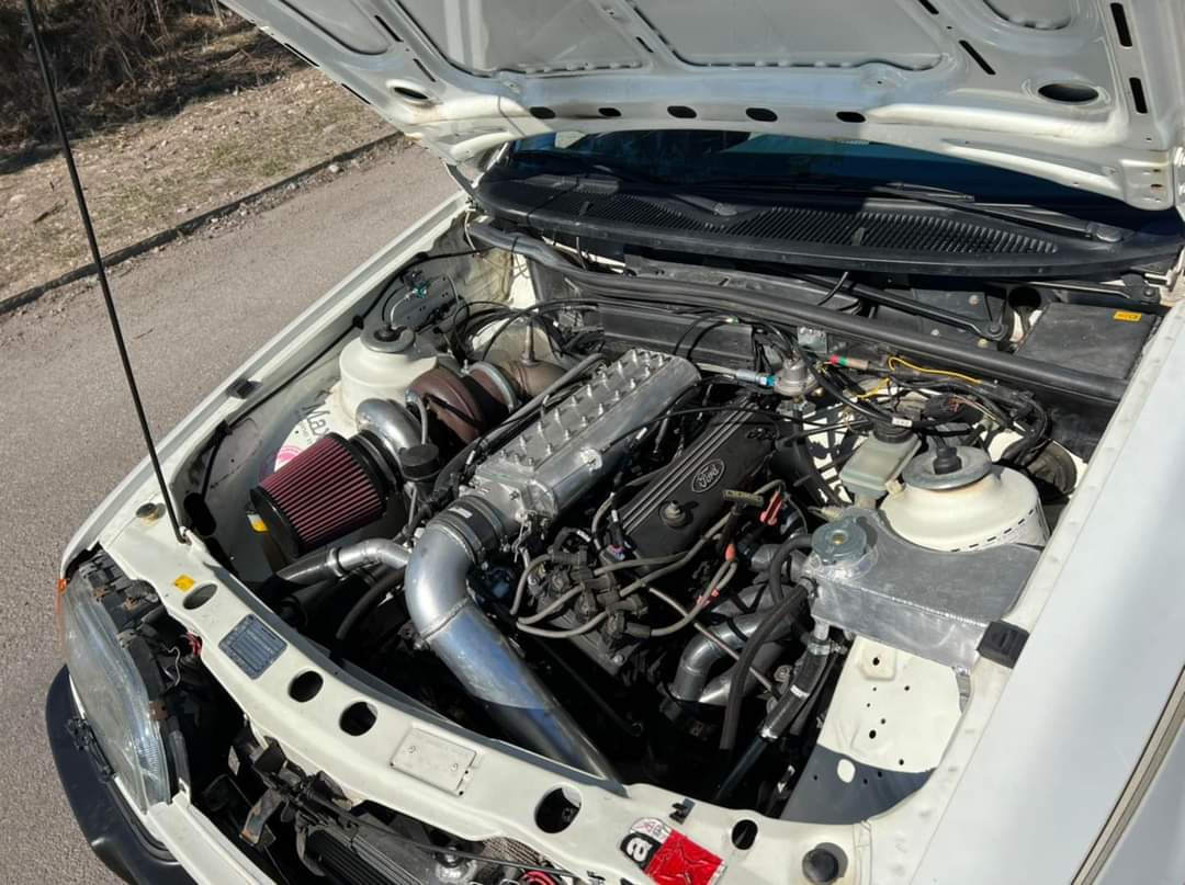

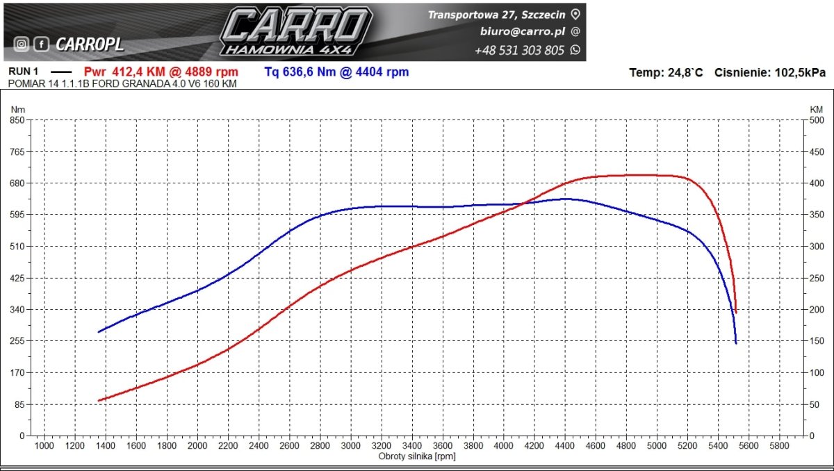

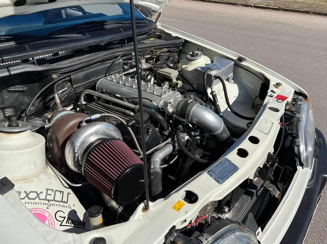

I will be also fabricating mine, but I was thinking more like that one here (borrowed photos from FB):
That's a mod by a fellow ford capri forum user in Poland (search Facebook for Mad Mods Garage).
Looks quite impressive (values at crank estimated) :D
